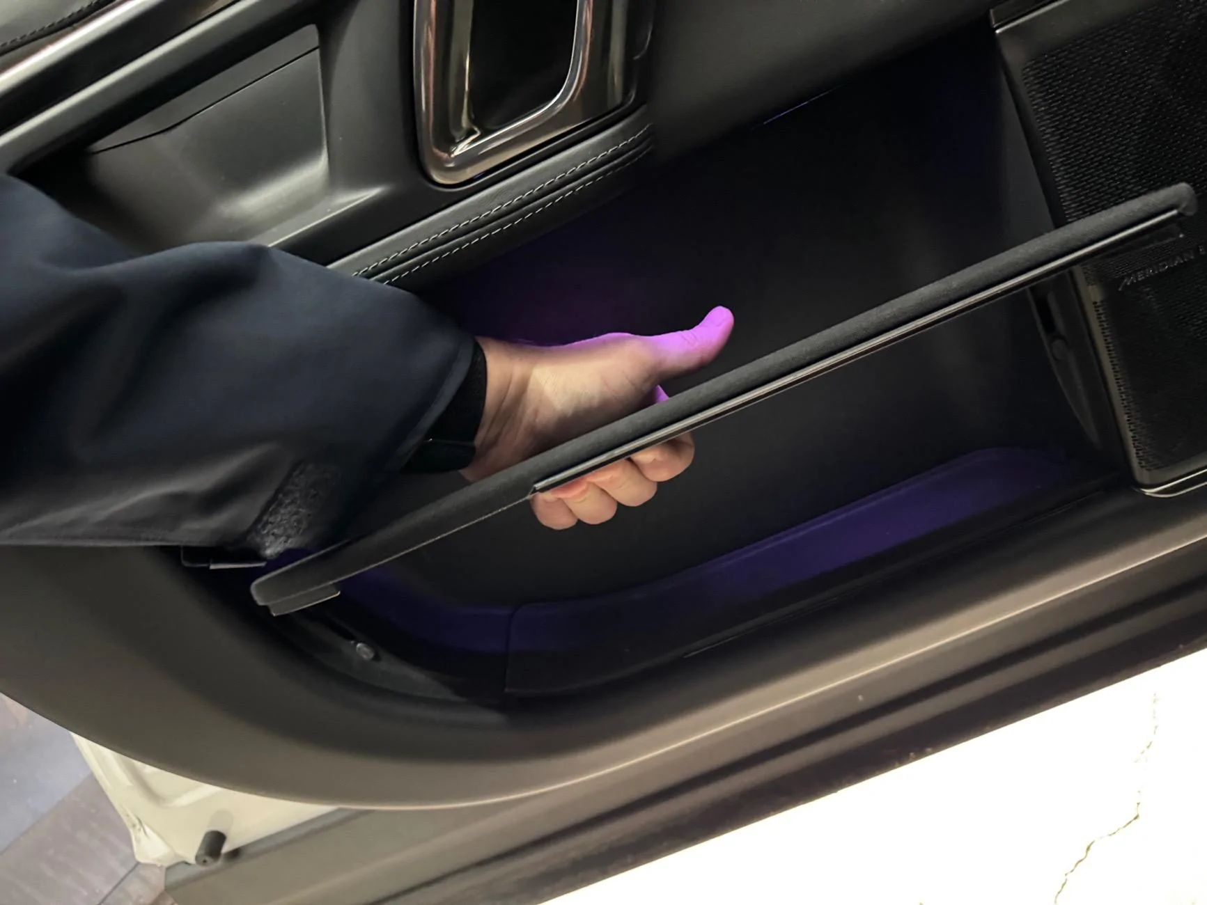

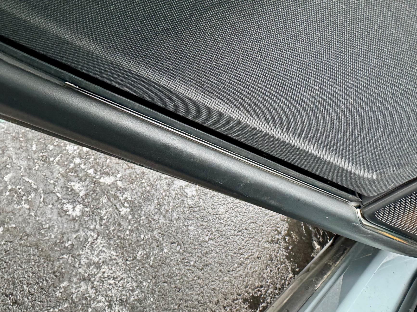

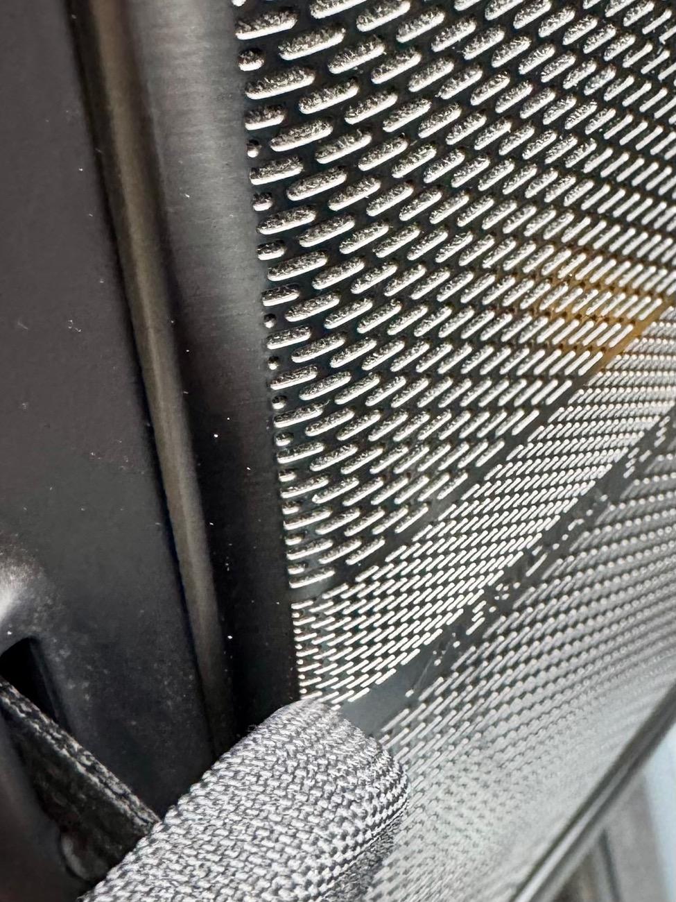

Here are the pictures. The sides are connected fine, but the bottom isn’t connected at all. The passenger door is connected at the bottom and works great.

Same as mine, broken. Plastic at the bottom flexes until it breaks.

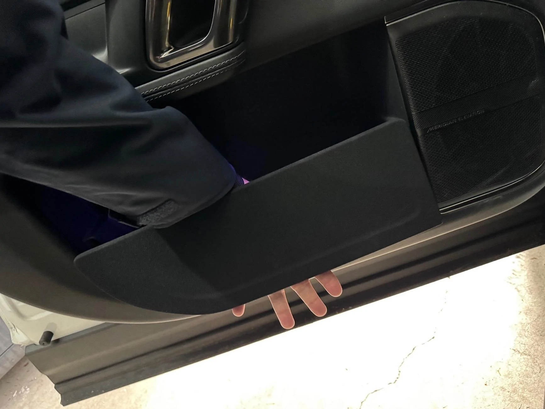

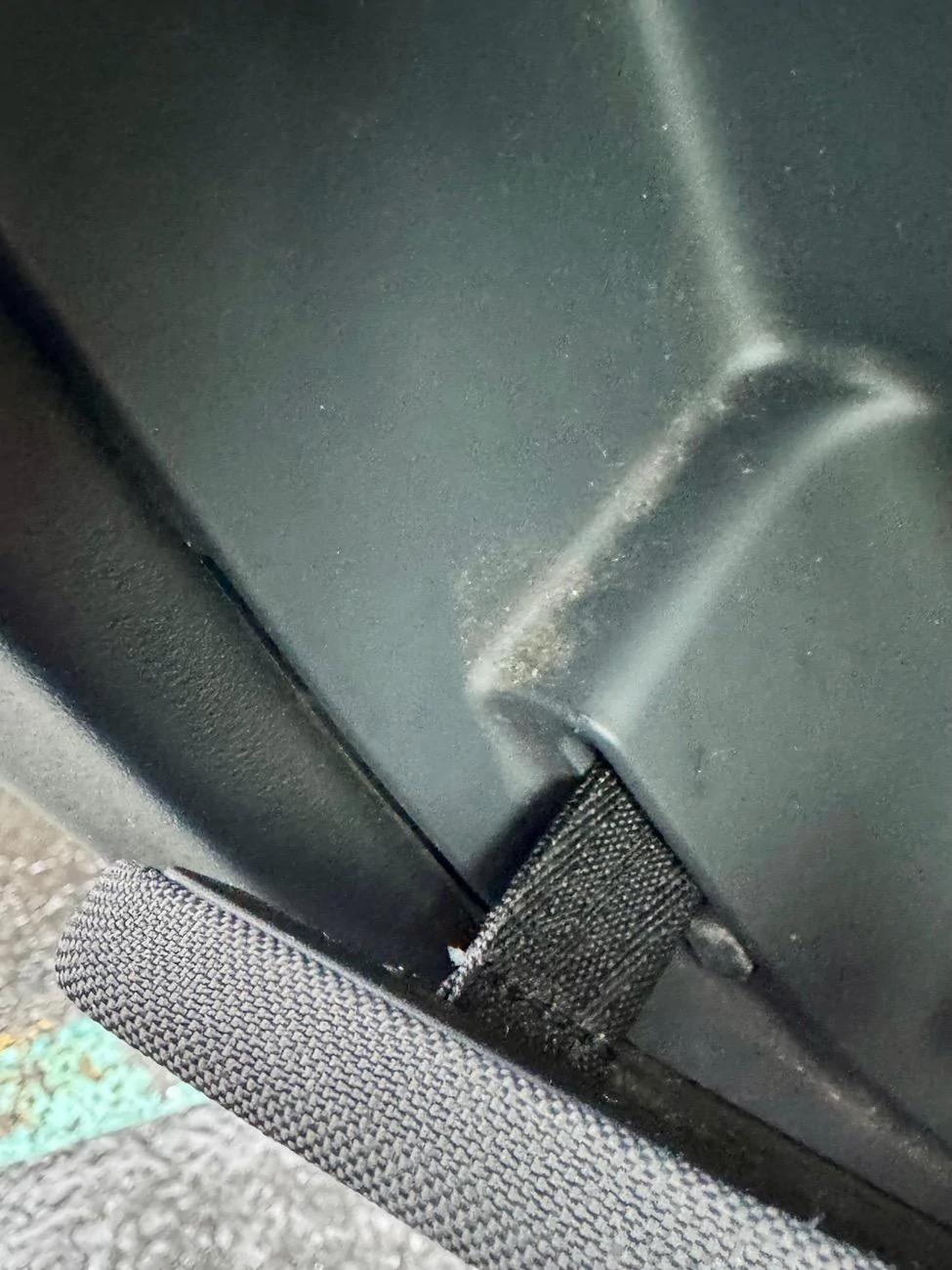

Rivian R1T R1S Door storage unhinged at bottom IMG_0670
Rivian R1T R1S Door storage unhinged at bottom IMG_0672
I put a service request in and hoping to get it looked at/fixed during my appointment (for tocking motor sounds at low speed) in March.
Mar 29, 2021
121
6,438
10,884
Kitsap, WA
Unfortunately the fix requires replacing the entire side panel, there's so individual part for it.
