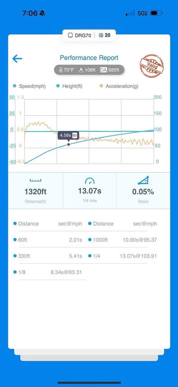

Nothing earth shattering here but I was curious what a Dual Standard R1S would run in the 1/4 so I setup the dragy in my wife's. Not too bad but wish it was faster!
Rivian R1T R1S Dragy and timed runs - post your data here 1741180447146-aq
