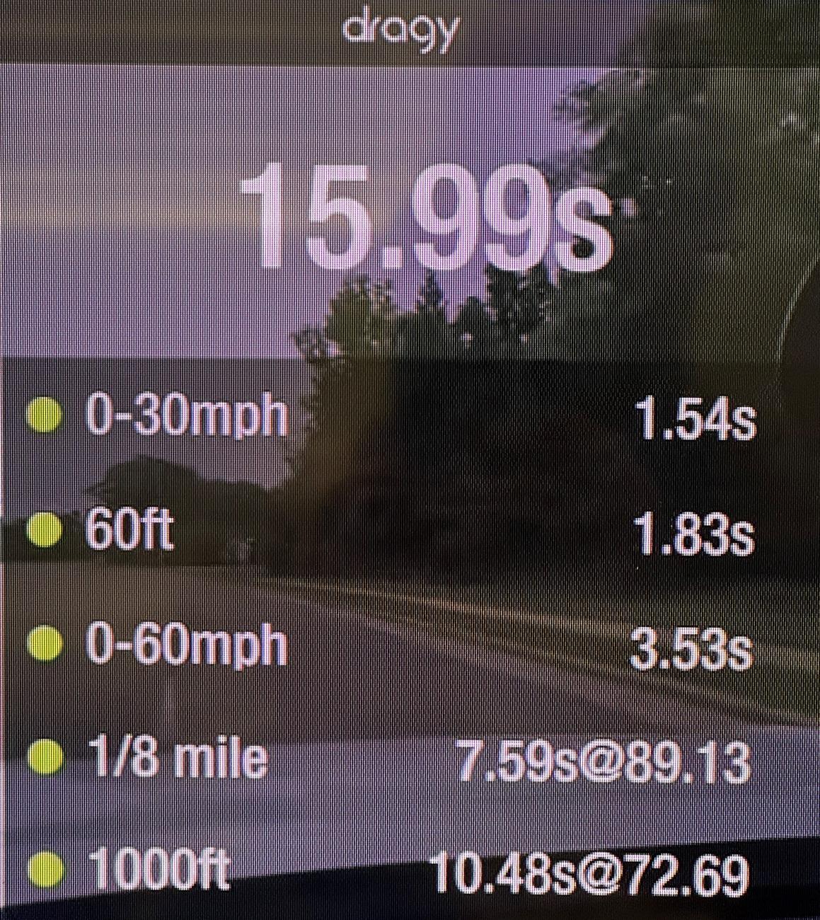

Rivian R1T R1S Dragy and timed runs - post your data here dragy

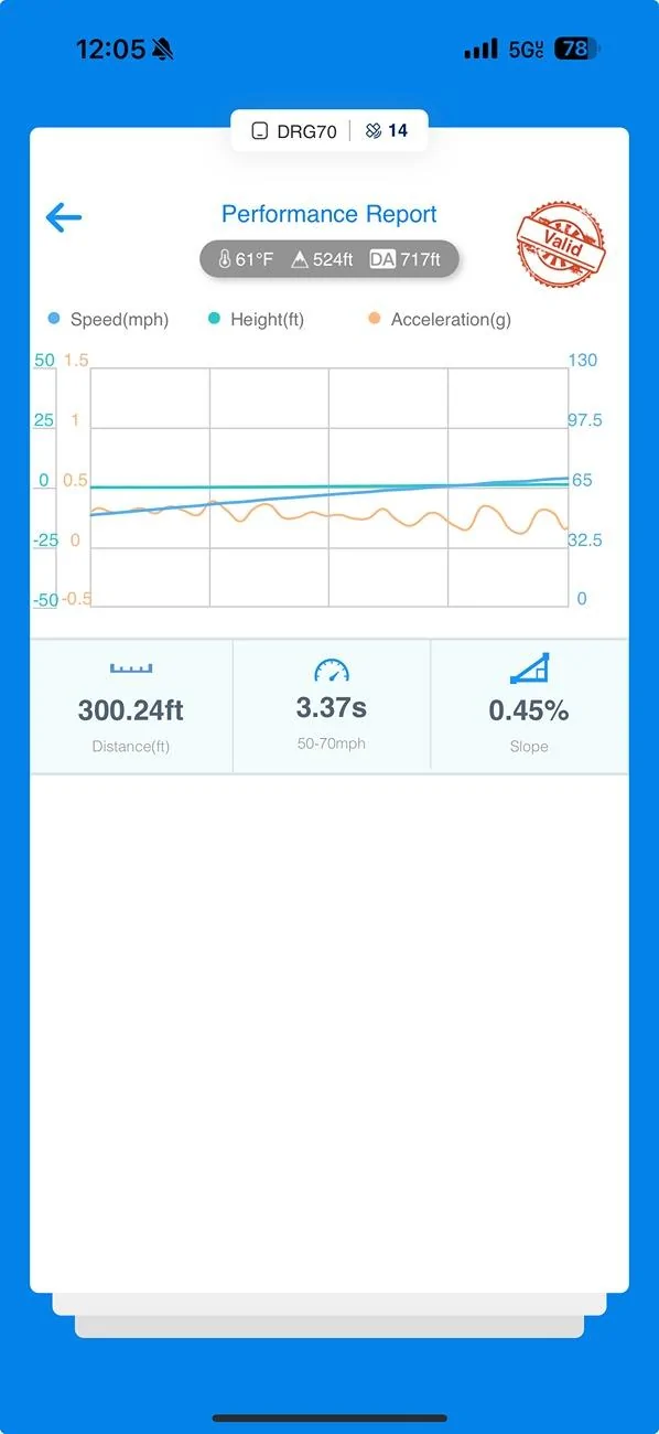

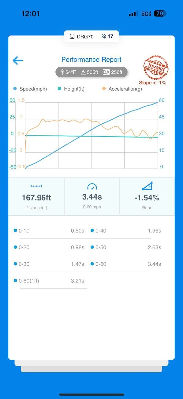

Made some more runs today. It wasn't as high of an SoC and made some change to launching. This time it was just smash and go with traction control OFF. Posted later is just a fun run in conserve mode at 48% SOC from 50-70 mph.
I had a bunch of these runs tightly grouped. This one I actually had to let off at the end and then got back on it as I had to avoid an obstacle. So while the run was technically invalid, based on my other runs, it if was totally level, and I didn't have to left a little, and no crosswind or headwind, I think I could have been in the high 3.3's. Keep in mind this was on a 51% SoC.
The main difference for this run was taking off traction control. I also got the stab the go pedal technique down better. Brake torquing has consistently netted me slower times so far. I think the brakes might be grabbing to much. WIth rollout this would have been a 3.2 second run which is quite respectable given the conditions and drivetrain temps (incl battery). I had 5 runs back to back that were within .03 seconds of each other. I am to the point I am deleting runs that don't matter.
Vehicle: 2023 R1T QM large pack
Cargo/weight: About 450 pounds, including driver
SW: 2024.47.01
Temps: 54F
Winds: 10 mph (on the nose headwind)
Battery Temps: 69F
Motor Temps (Front/Rear): 114F/131F
DA: 256'
Prepped surface: No
Wheels/tires: Factory 21" with factory Pirelli Scorpion AS @ 48 PSI
State of Charge (SoC): 51%
Mode: Sport
Suspension: Low
Firmness: Hard
Traction control (High/Med/Off): OFF
Rivian R1T R1S Dragy and timed runs - post your data here Sport No traction ctrl 51 perc
Conserve mode (50-70): For reference, C&D in Sport mode was about 1.17 seconds quicker than what I ran in Conserve. All in all, not bad TBH.
Rivian R1T R1S Dragy and timed runs - post your data here Conserve 50-70 51 Per
