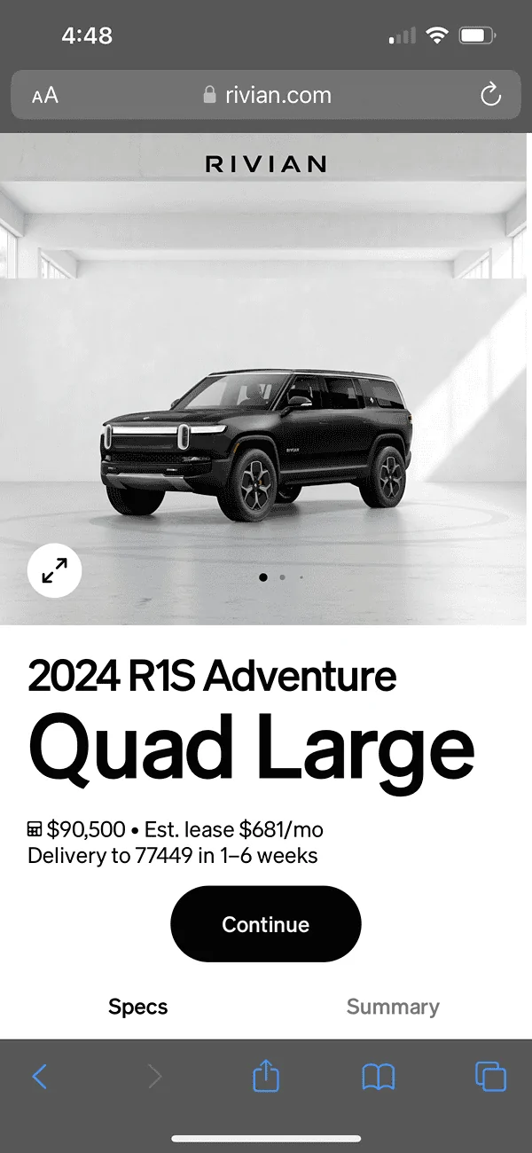

Hello everyone, this would be my first Rivian purchase and I feel like I found a great R1S Spec in the shop last week. The estimated lease numbers to me seemed like an amazing deal for being a Quad Large.

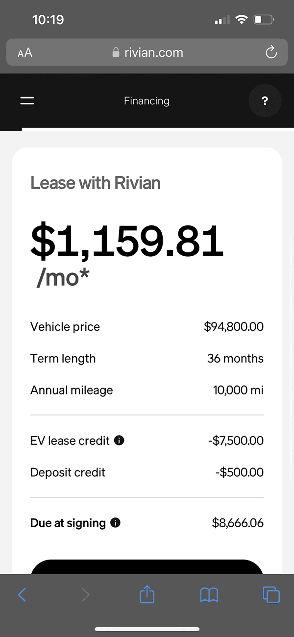

But then when I got to the finance process step (I will be leasing) the number jumped up quickly from the estimate. Quick note I did do the wheel swap for 22 brights so yes that does bump the price from the original $90,500 to the current $93,000 + $1,800 (from what I believe is a delivery charge? Totaling $94,800 (total vehicle price). Looking at $1,159 a month/10k miles/36 months/ $500 down

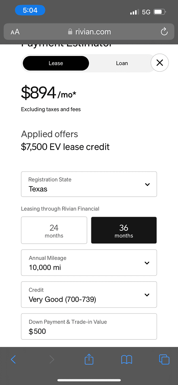

When I first found the build the estimator had me at $894 a month/10k miles/36 months/ $500 down
So a $265 monthly bump from original.
Now don’t get me wrong there’s a $4,300 difference from original build to current with wheel swap and delivery charge. But this is where I’m wrong maybe? Isn’t the rule of thumb every $1,000 additional is about 20-30 bucks additional monthly? So let’s roughly say an additional 120 a month makes sense. Not $265…
Can someone shed some light on this. In no way am I an expert on leasing and the numbers just seemed off to me. Also, My $500 a month is just a random #
Lastly, has anyone been able to roll negative equity from their trade into the lease or you must pay it all upfront?
Thank you

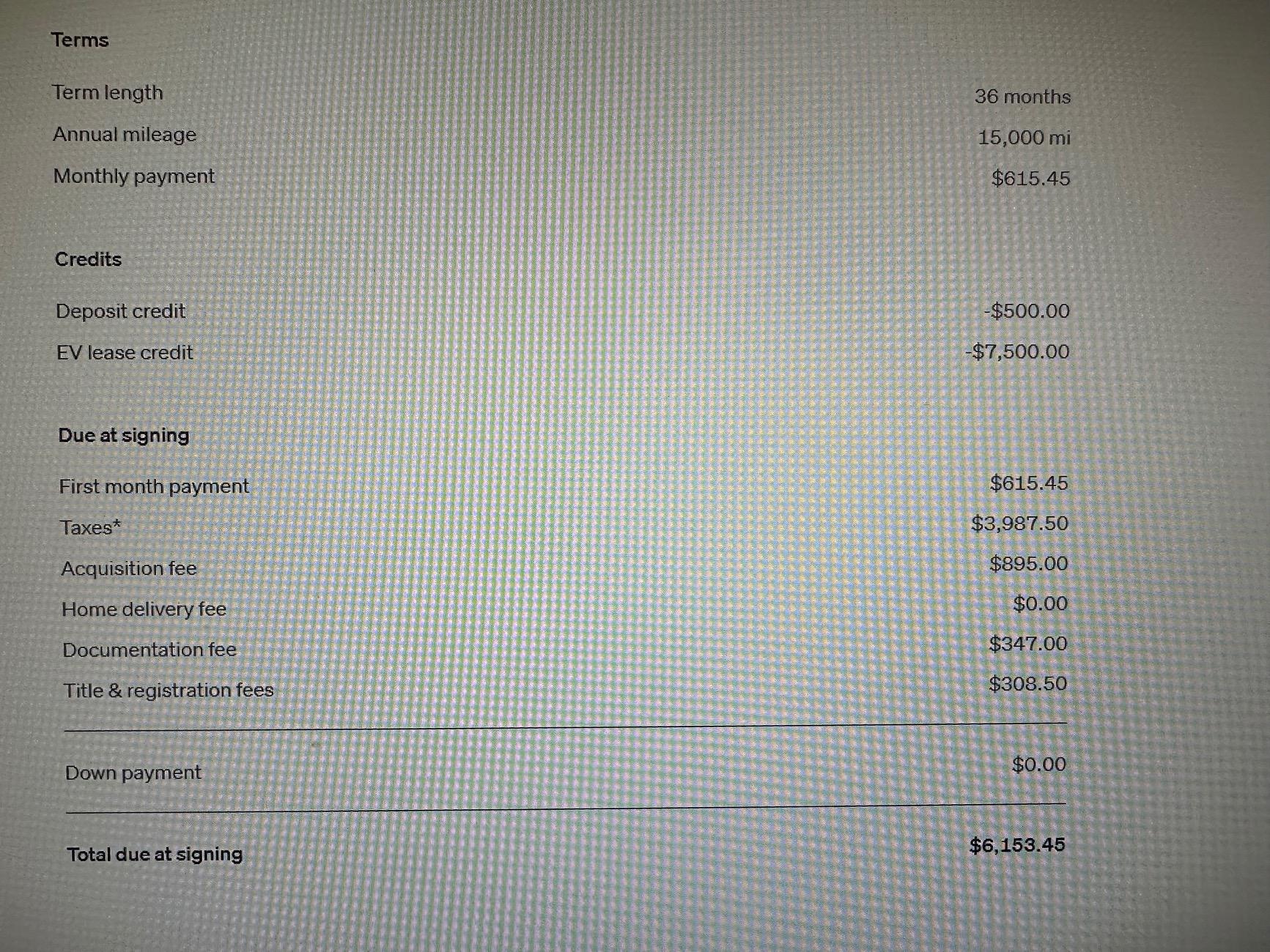

This is my final lease detail. The EV credit is there. I did not put anymore additional down payment. Mine is an DM R1T Large so it cost less than yours. The money due at signing is basically tax and all the fees.
