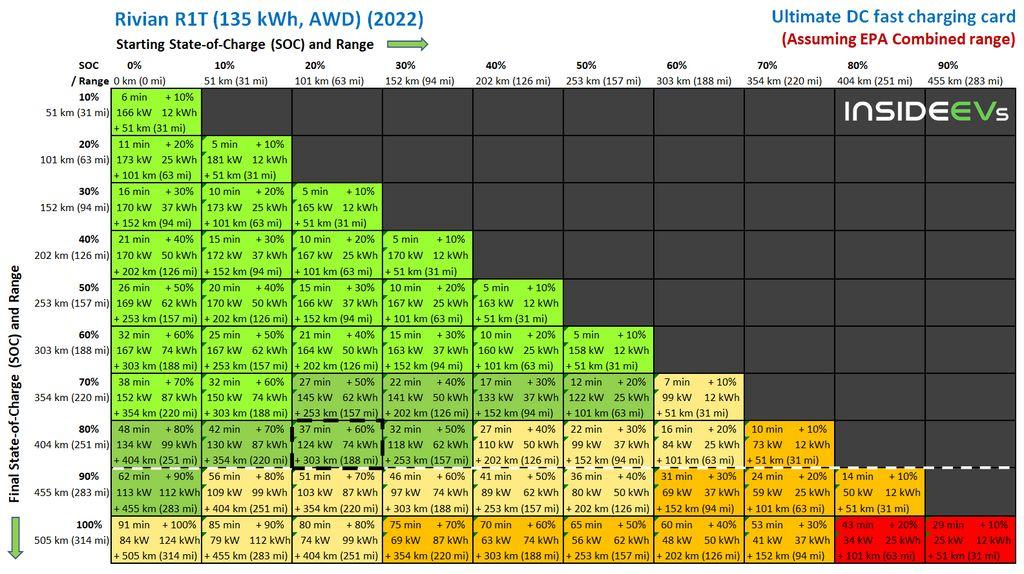

I figured it was something like that. I just don’t want to be on my deathbed regretting wasting time trying to minimize slowing of the charging rate. I have a limited amount of time left to think and I would rather scroll. I am having fun thinking about charge curves and how much I want to maximize charging

https://insideevs.com/news/575986/rivian-r1t-charging-analysis/
