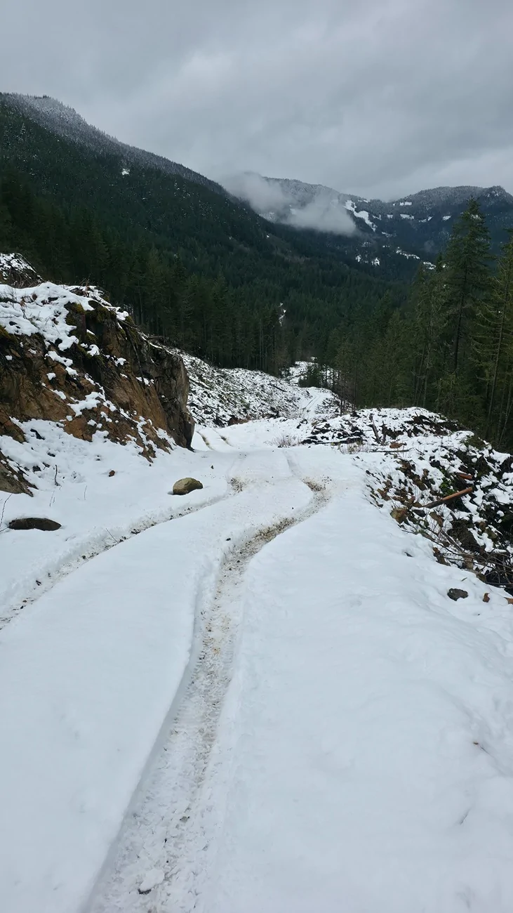

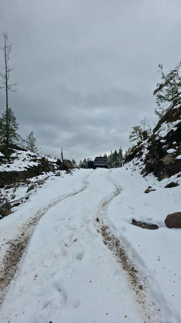

I'd just like to say, soft sand mode in a quad is about as close to a locked differential as one can get on the OG Quad. I used it quite a bit yesterday to both get into and out of some troubling steep snowy areas.
While other modes kept trying to pick wheels to move, Soft Sand mode just put the power down. Watching the power guages etc as I was pushing the vehicle to get through some nasty bits, you could see a lot less intervention from the stability side of things, and more just putting down the power to all the wheels to get the vehicle moving.
Side note, it's a quick way to heat up the Bosch motors too 🔥😜
The photos below while steeper than they appear were roughly a 15-20 degree grade. This wasn't the sketchy area I ended up having to reverse down due to overgrowth.
In the end, tires, and chains can make all the difference. Unfortunately chains won't fit my setup.
