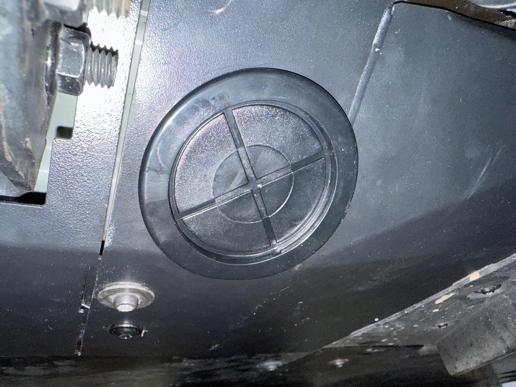

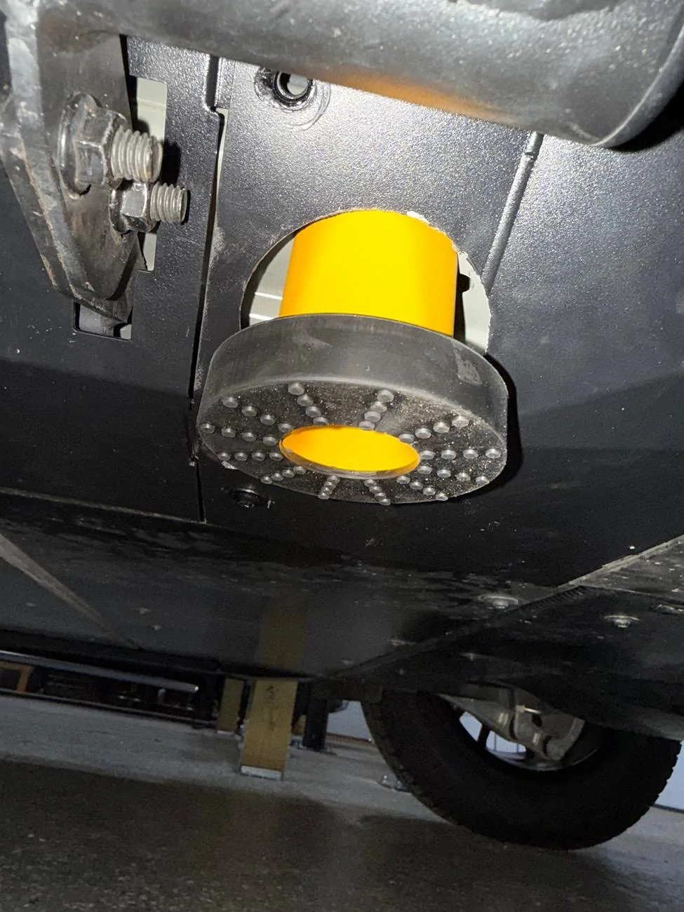

I am going to map out and cut a 2 3/4" hole in the rear panel of a set of T covers and see how that goes. I would rather put a rubber grommet in there....its an easier and more SC friendly option I think. This is what I am thinking of putting in....smaller size of the grommet I used to use when drilling the 4" holes.
BTW - The Rival skid plate is pretty slick looking.
Here is the end result.
R1T Aero Covers, rear access hole cut so the plate can stay on and still access jack point.
Amazing! Thanks for sharing your results here.
Can you share what you used to cut the plates? Standard hole saw & size?
Can you share a straight-up shot from the bottom to show the correct position to cut?
And lastly, any issue at all with clearance of the standard jack puck?

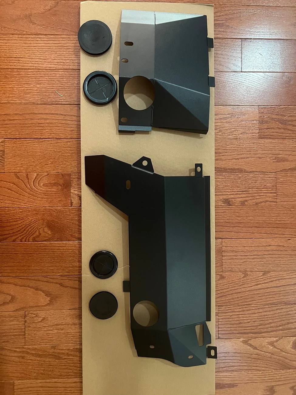

Thank you @swflor for sharing your input with @EV_Sportline, and thank you EVSL for listening to your customers. I took a chance and bought a brand new/unopened set of Team 1EV RMaxx running board aero panels from a seller on Facebook Marketplace. They are version/kit number R1E2020.2 so they fit both Gen 1 and Gen 2 R1Ts. I was super happy to open the package and one of the first items I saw was two packs of large rubber grommets, which cover the jack puck access points - both front and rear access points. I then uncovered the front and rear aero covers for one of the sides and confirmed that EV Sportline started making the rear plates with a hole for the jack pucks. I am thrilled to have this in place and can’t wait to install both the running boards and the new aero covers.
