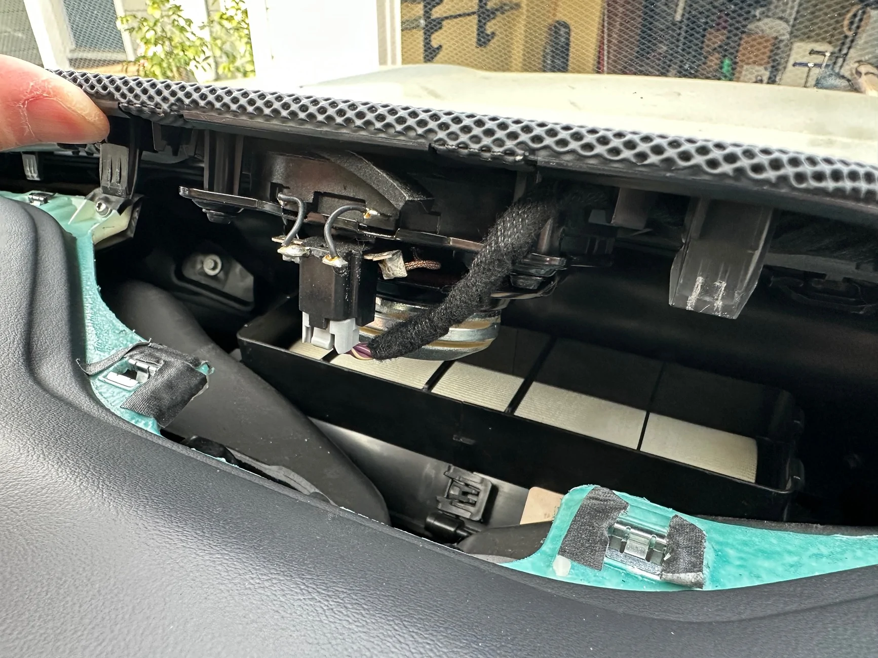

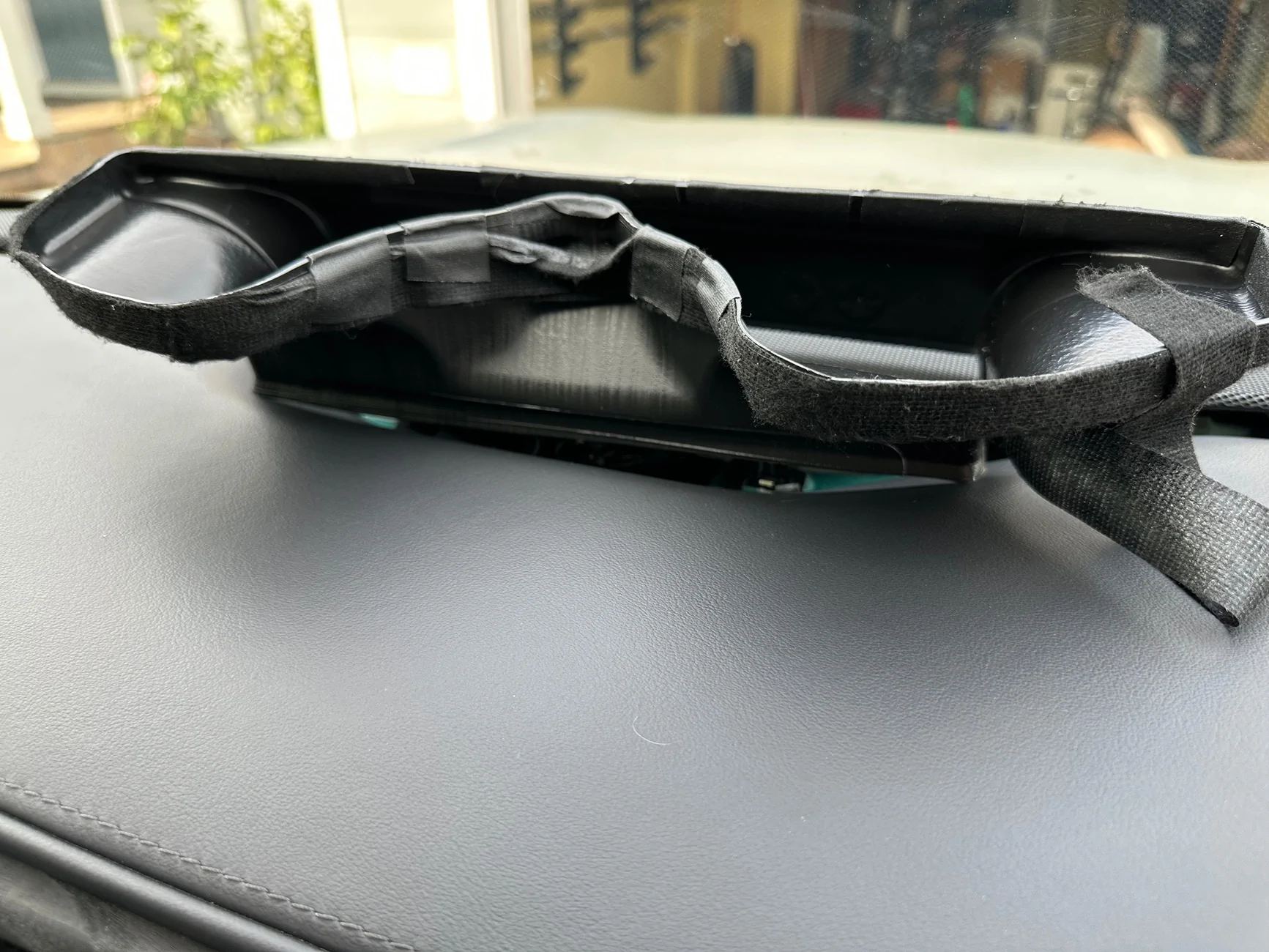

I’ve had my R1T for three years, and the rattle under the front dash mesh has been an ongoing issue.
After much trial and error, I determined this plastic piece, which I presume helps with defrost air vectoring, has been the cause of the rattles all along. I decided to just get it out. Poorly designed piece that isn’t locked in place but just held loosely.
Now, no more rattles from there! So relieved.

How hard or easy is to remove the plastic piece?
Opening the mesh is the hardest part but it’s doable with a trim remover. The mesh is held on with clips that you can see in the picture. If you place your trim remover by each of the two front clips, it should pop off

Gotcha, I might try the same fix. My rattle isn't driving me crazy (I had a piece of rubber pressuring the grill but that stopped working) but would love a permanent solution.
thanks for sharing!
