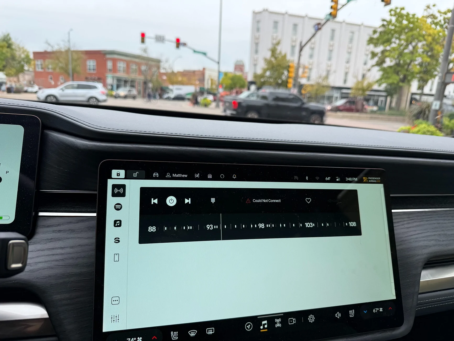

I'm not sure if this is a me thing, but I've had periodic issues with the FM radio where it refused to "turn on" and I'm curious if this has happened to anyone else.
I've gotten this error multiple times in my ownership of ~4 months. Since this happens while I'm driving, I can't perform the soft reset (opposite steering buttons), and there's no way to correct it mid drive that I've been able to find. The soft power button on/off doesn't resolve this and there's no ignition to turn off/back on again at a stoplight like you can with an ICE vehicle. It's not an end of the world issue, but it's frustrating none the less when it happens. The only resolution, is park and walk away when I get home or to work. Car goes to sleep (assumingly) at some point and when I go back to it, it's magically resolved.
So long story longer, is this a known issue, bug, defect, etc and is there a similar known fix?

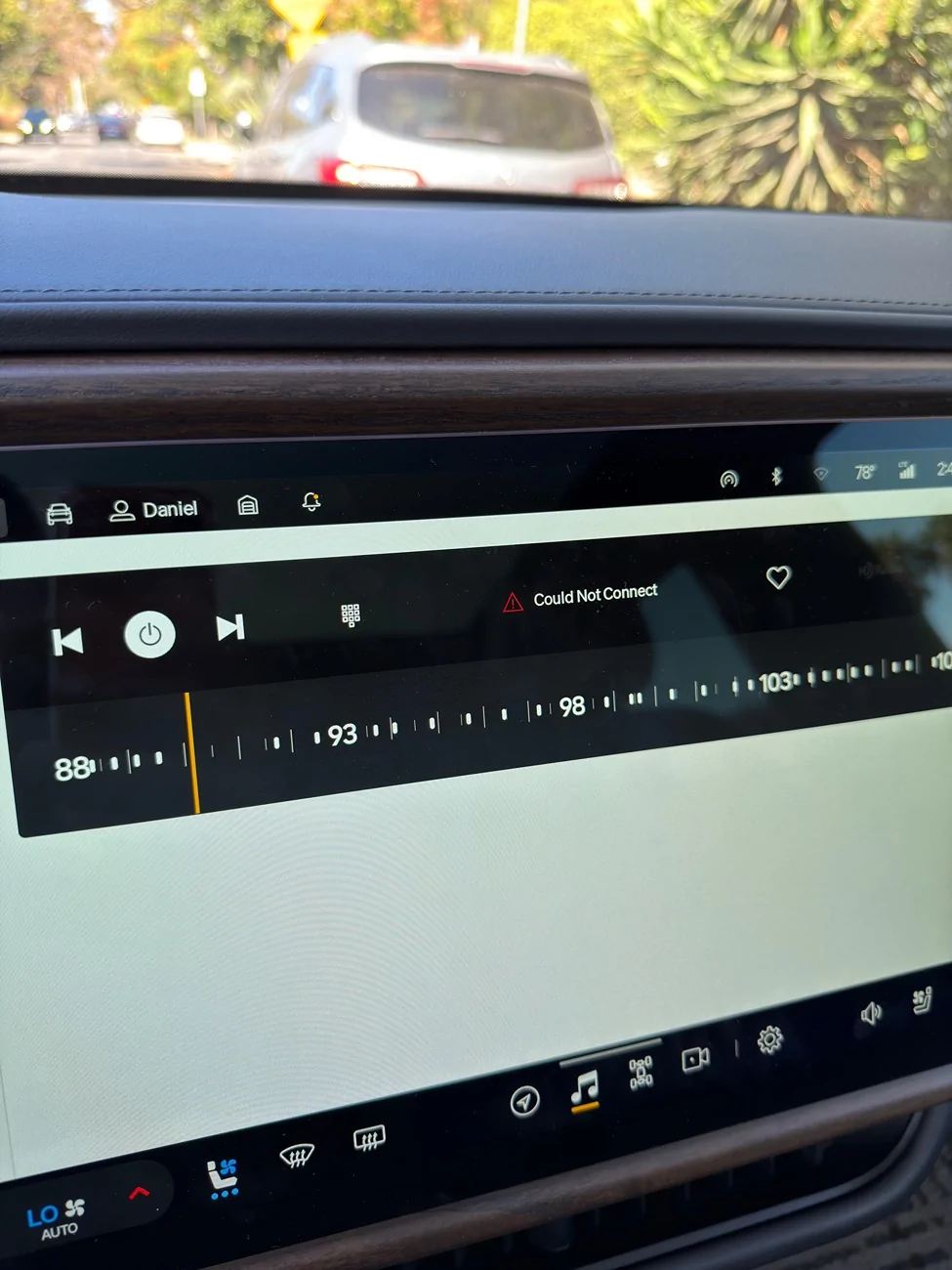

Same issue here. This is a new 2026 r1s I picked up a few weeks ago. It was working previously. A soft, infotainment reset did not fix it. Maybe it’s a more prominent bug after the most recent update.
