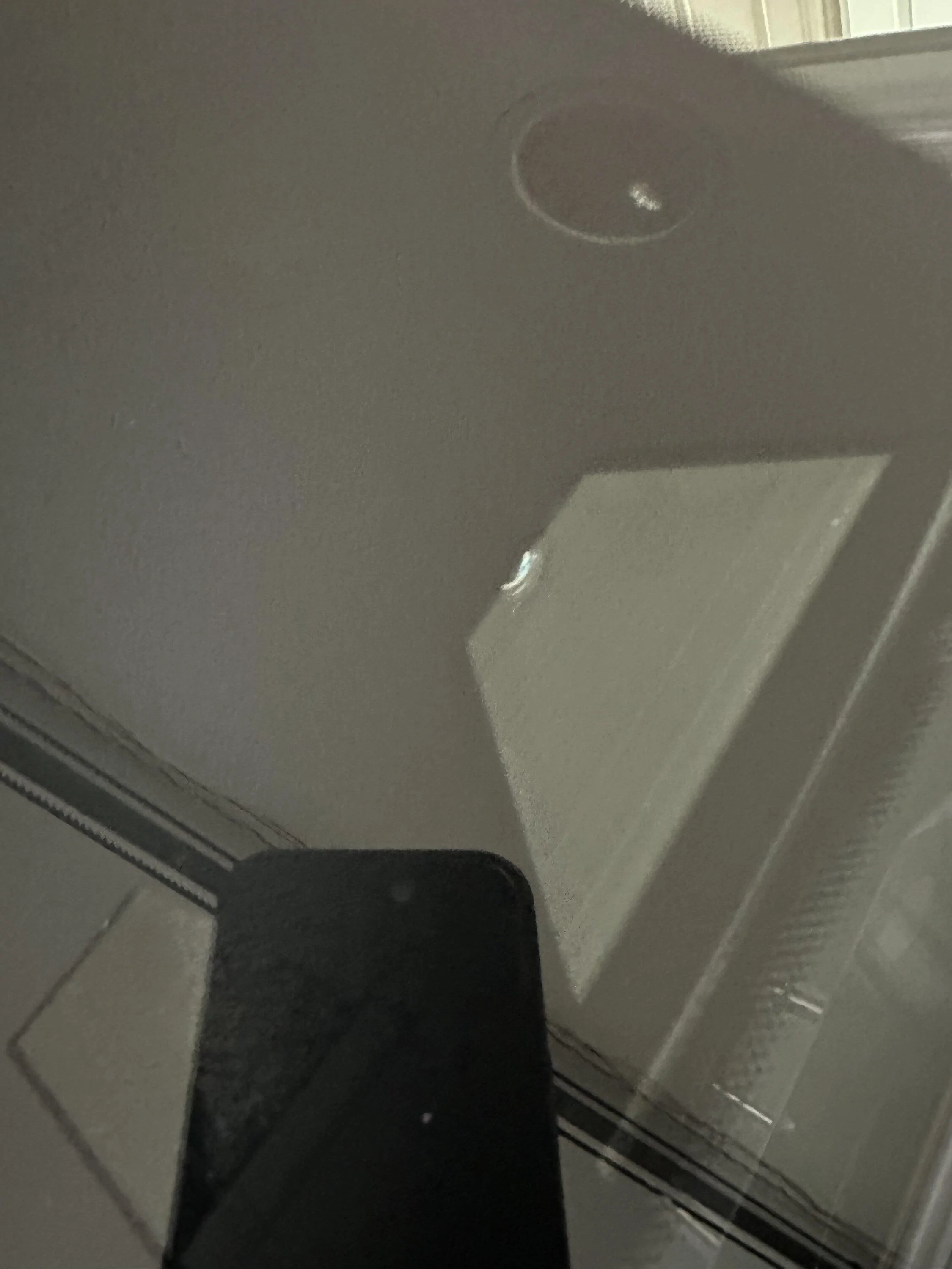

Hi, I have a question take a look at the attached picture. Does this look right or does there look to be an issue with the laminate? I have nothing to reference it against and I’m unsure.

Doesn't look quite right, but I can't honestly say I've examined my own very closely. When you view drivecam footage does it look normal?
I don’t believe that camera is part of the drive cam. My understanding is the drive cam camera is in the front bumper. I believe this one is for lane assist possibly
34,494
You are correct. I just looked in the owners guide and that camera is listed in the Driver+ section.
That's not the camera thats the gel pad for the rain sensor, have you had a windshield replacement? It looks like the pad isn't seated all the way
No, it’s the original window. I picked it up about a month ago. It’s been like that since I purchased it. Doesn’t look right, but I was hoping someone could put eyes on theirs to see if it looks similar or it’s entirely wrong.

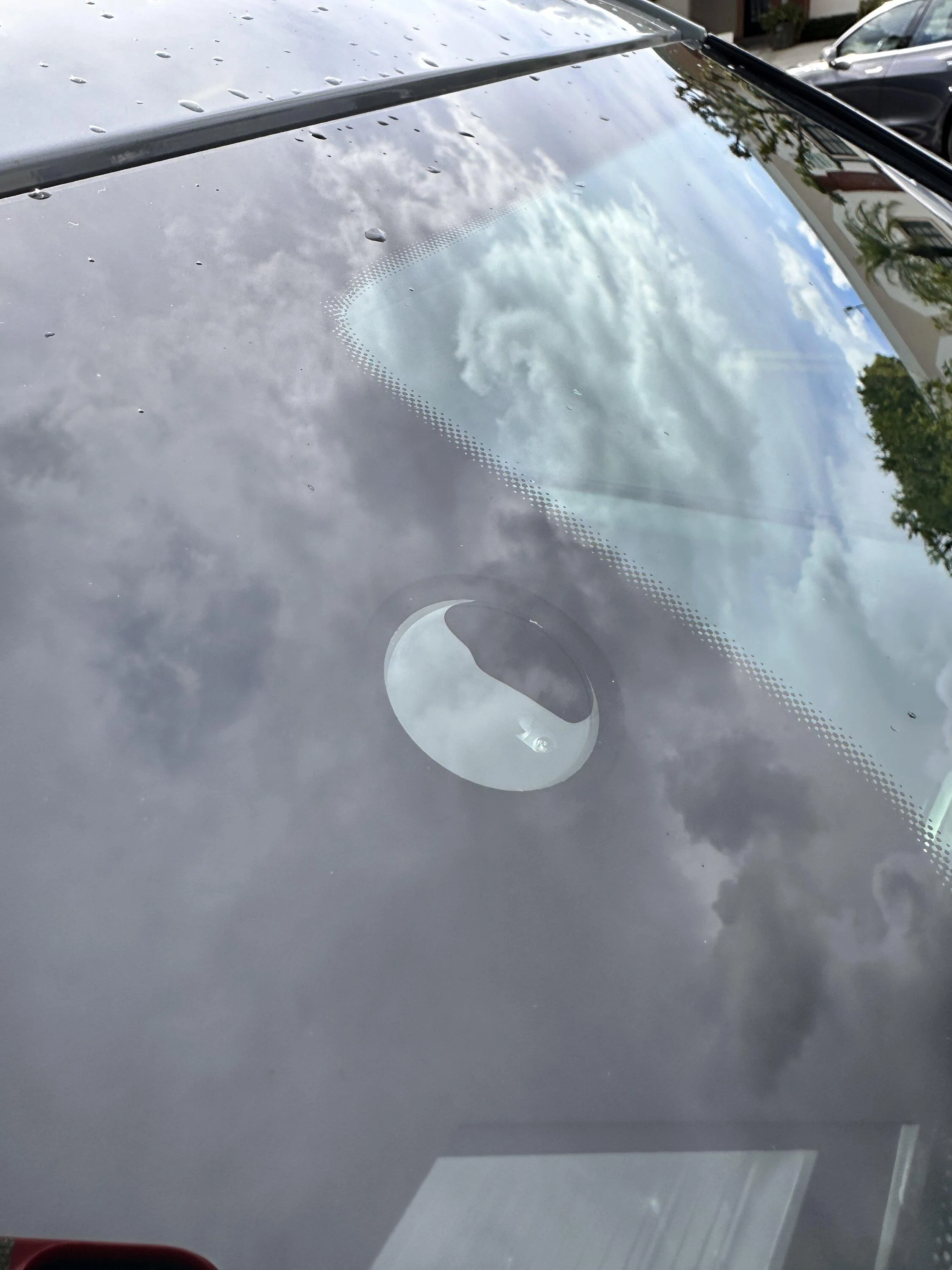

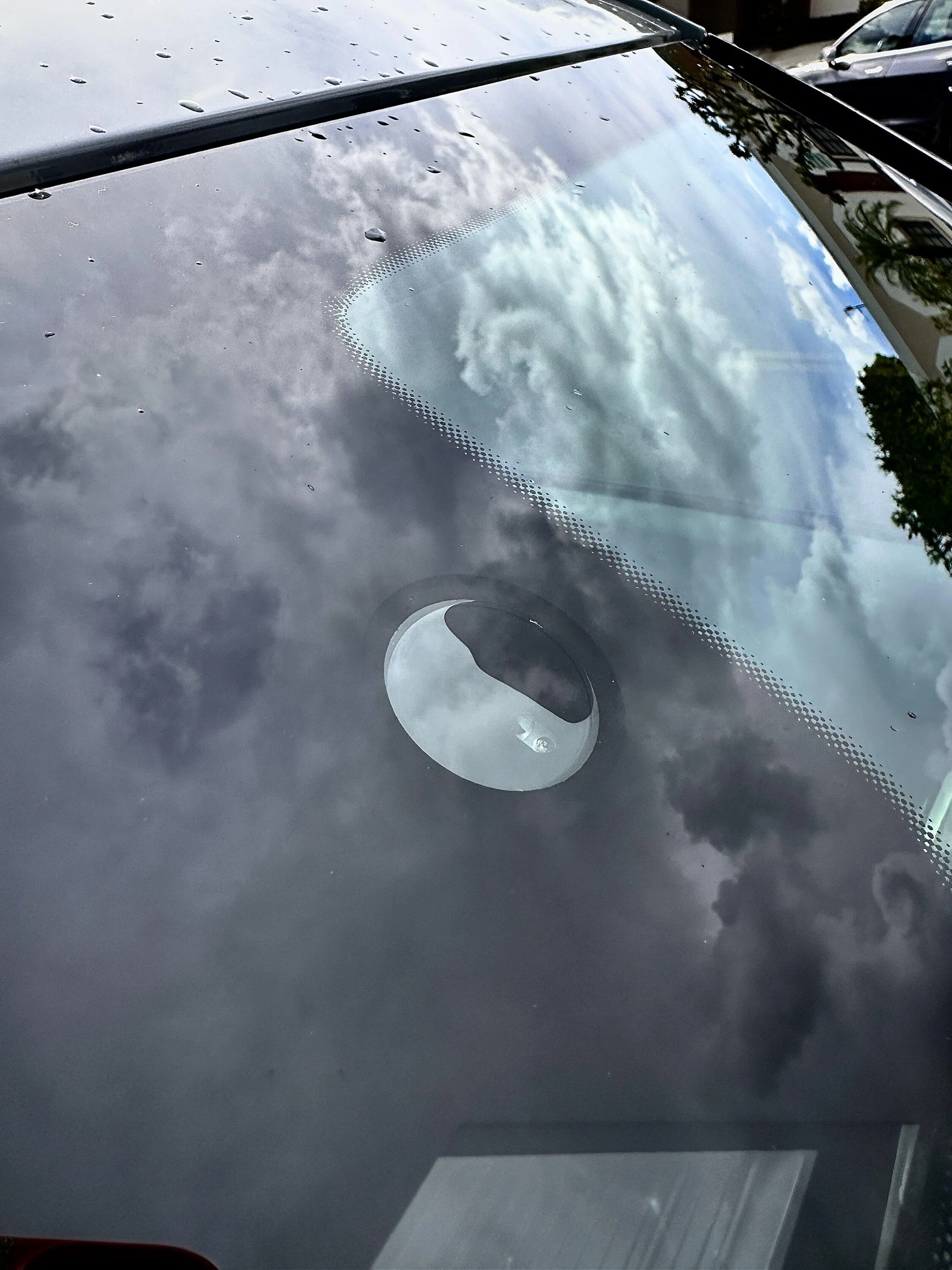

I had the same exact issue when I took delivery of my R1T. It seemed to affect my auto wipers as they didn’t work at all.
I made a service appointment and brought it in. The tech immediately said the sensor had an air bubble in it. He said it was a quick and easy fix. After they fixed it, my auto wipers worked as advertised.
Yeah, it shouldn't look like that, usually that's how they look after a replacement when the pad isn't seated all the way.
This is not correct. This is your rain sensor and I had the same issue. It’s a one time gel adhesive and I’ll bet your rain sensing wipers go off when it’s not raining. Make a service ticket tell them that the rain sensor isn’t adhered to your windshield and since it’s a one time adhesive needs to be replaced. They can also do that mobile.
