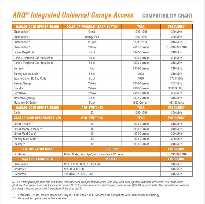

Has anyone had luck with a Linear? Cannot get my linear to program. R1S pairs to the remote, but then fails to connect to the garage door. I have tried the 3 step process of learn and drinking beer, but apart from getting drunk and losing the setting of my manual remote, the R1S won't connect. Thx in advance.

Our G1 & G2 paired easily with Liftmaster also.
If you can’t pair with a specific brand, a workaround that worked great for us is to add a Liftmaster wireless receiver, then pair to it.
Our office gate has a commercial opener that will not pair with any vehicles at all. I used a liftmaster 412HM - installed it within the gate operator box and it picks up signals fine.
We also have an older garage door opener that I added a Liftmaster 365LM (that opener wouldn’t pair with any newer cars we had, including Rivian).
