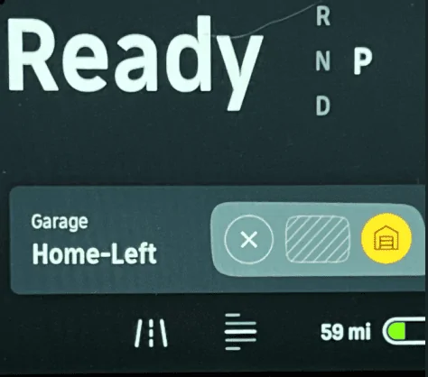

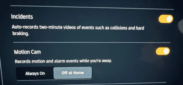

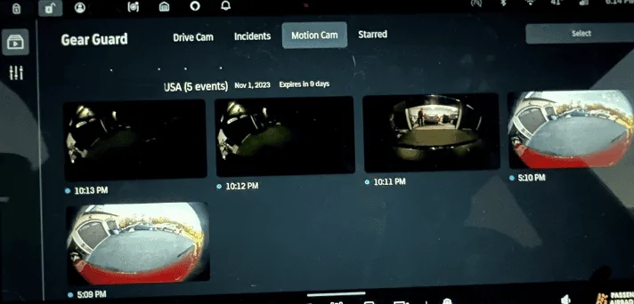

I need a sanity check. I continue to see phantom drain higher than it should be and it appears to be a bug in Gear Guard setup? From everything I see, my settings have Gear Guard off at home - I have verified the "Always On" vs "Off at Home" setting by toggling it several times. Home is being detected because I get the garage door pop up. But I have motion cam recordings taking place regardless. On occasion I have seen Gary on the screen when I walk up from the rear of the car and PAAK is slow to respond... Am I missing something?
