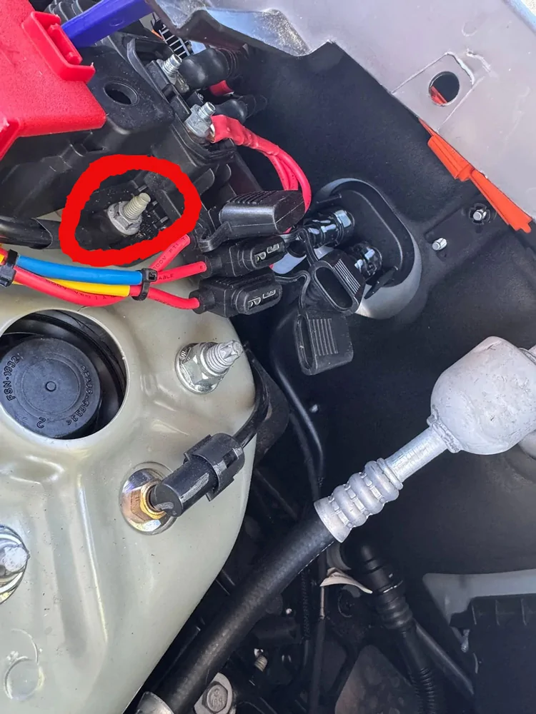

Thank you, Just finnished installing my Extreme LED light bar. I ran the wire down the driver side of the window and routed it around the air cabin filter to get to the point that you highlighted. It's super simple, just connected the ground at the base of the 12 V power and then just added an additional M6 nut on top of the existing nut to get 12V power. The whole thing took 20 minutes to do! This Light bar has a Bluetooth remote, so need to run wire for a switch through the firewall.
This is not a great picture. It's raining outside, but you can see the light bar freshly installed on top of my rack.. No need to see more wire runs as I did as you suggested.
Can you be more specific about this? “Two 25 torx screws to remove the panel where the fuse box used to be in the old days. “. Since I do t know where that was I don’t have a reference. Also do you mean the nipples I have highlighted here? Thanks
Yes. Those are the ones. The other side is the panel below where the glove compartment would in 95% of the vehicles on the planet.

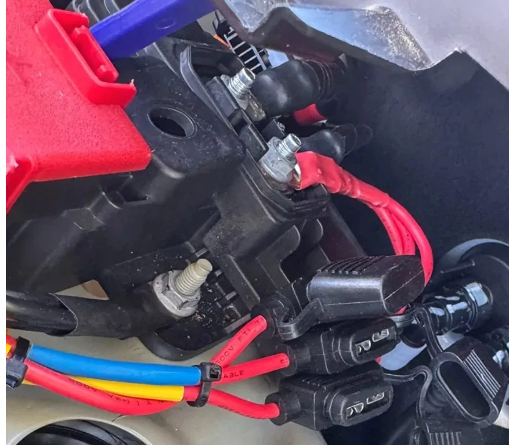

The battery post is shown in this picture the positive lead. Is that an M4 not that goes on there? My hand tightened a nut back there, but it doesn’t seem like it’s grabbing although I know there’s not a lot of thread.

Loosen and remove the original nut. There is probably not enough length for two nuts.

I was afraid to use a wrench back there, I don’t want to sort anything out, and it’s very hard to see back there.
Use a socket and an insulated handle. Wrap some gaffers tape around a metal one.
