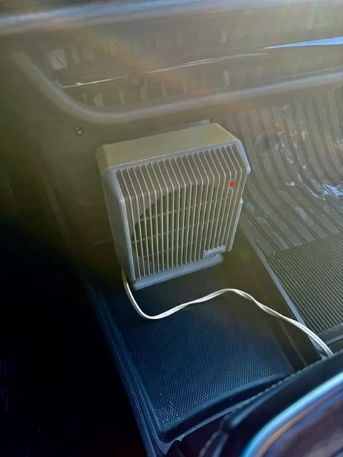

Found a quick temp solution to my no heat. Small space heater plugged into the outlet. 1000watt on lo/ 1500 watt on hi. works great on high. Atleast the cabin isn't 15 degrees any more.
