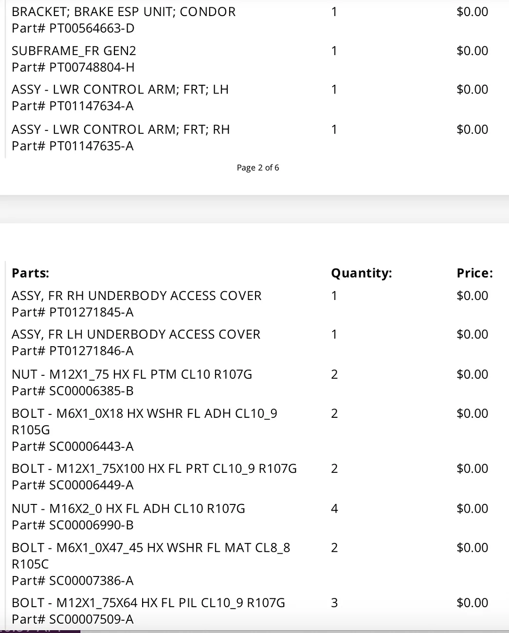

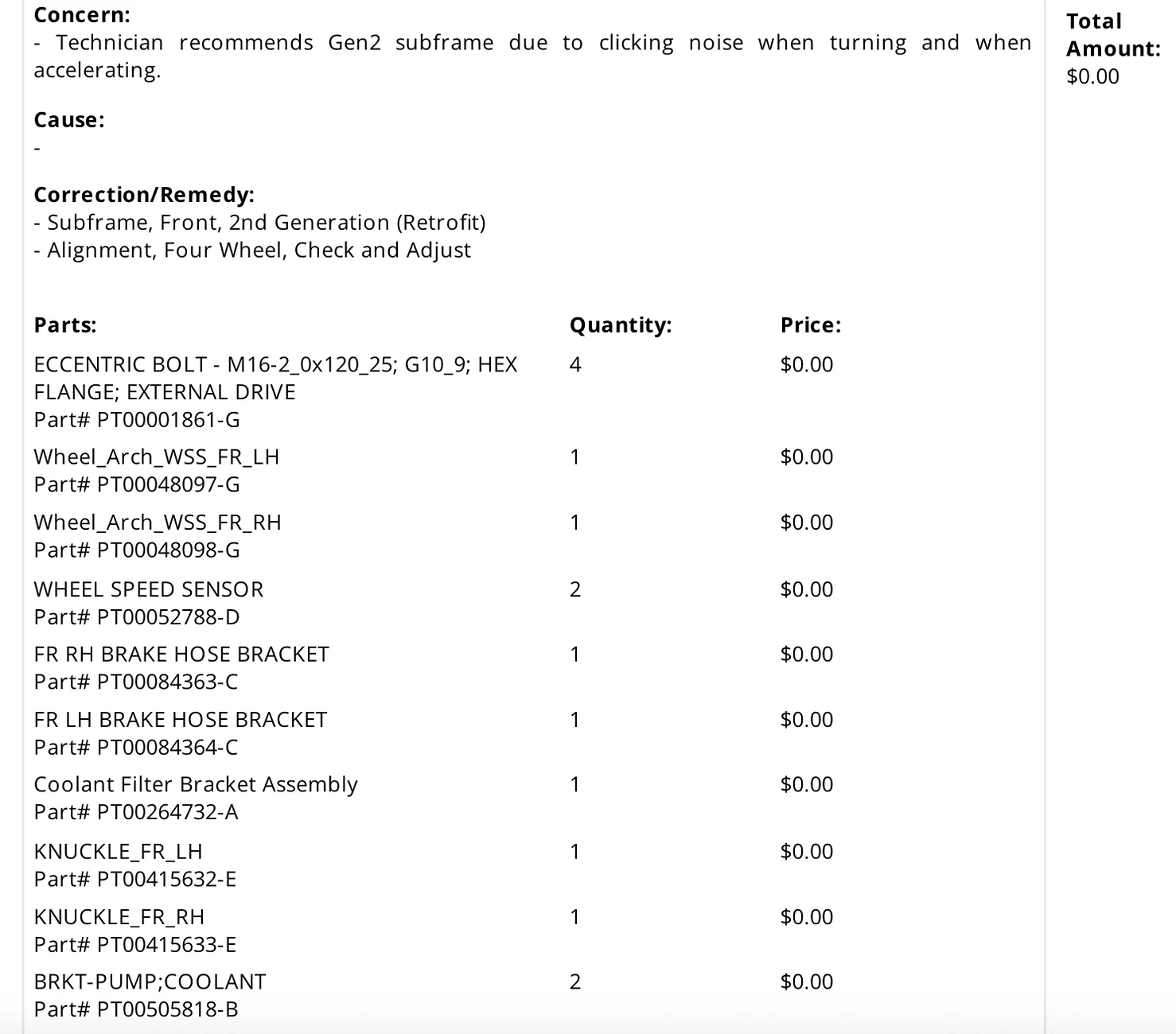

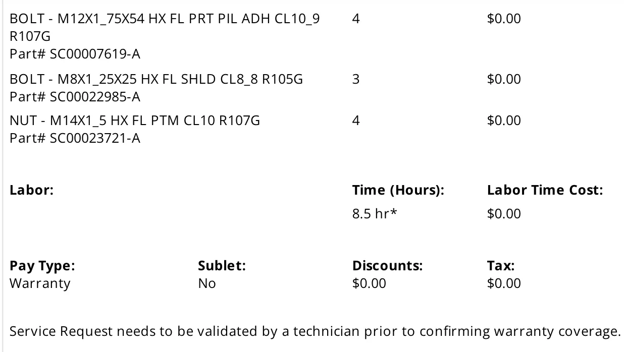

Thanks for this. I've managed to get an appointment and have the retrofit done! Jounce lines were replaced earlier this year. They did not replace dampers.
Good drive before, but even better drive now. No more small noises here/there, tighter drive/control.
Awesome! And looks like even though they didn't do the dampers, they did a lot of other things too.
In my case I think they noticed a small leak in the dampers, hence the replacement.
Glad they were able to swap it out. It's a big difference.
