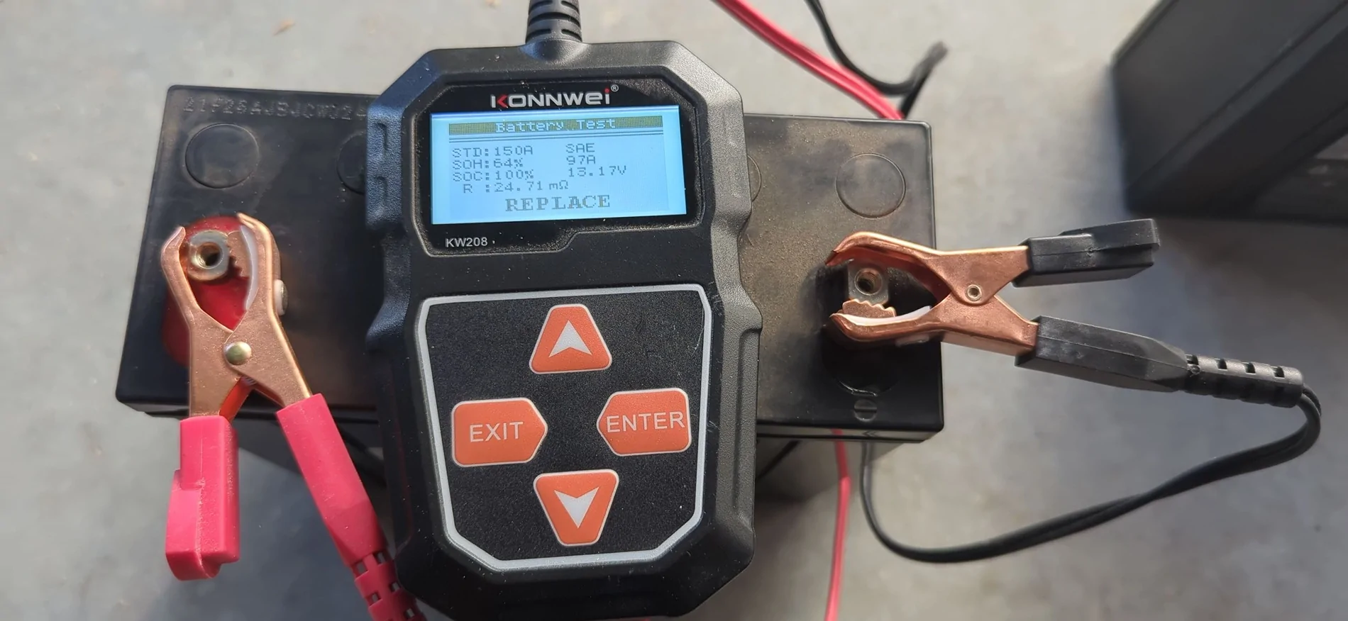

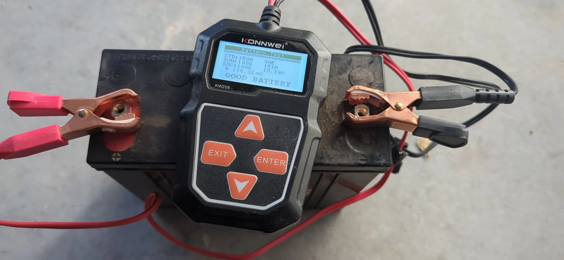

One more fun data point to end the day on.
* Primary battery testing OK.
* Secondary battery testing Faulty.
Rivian R1T R1S 12V Battery Replacement Megathread primary
Rivian R1T R1S 12V Battery Replacement Megathread secondary

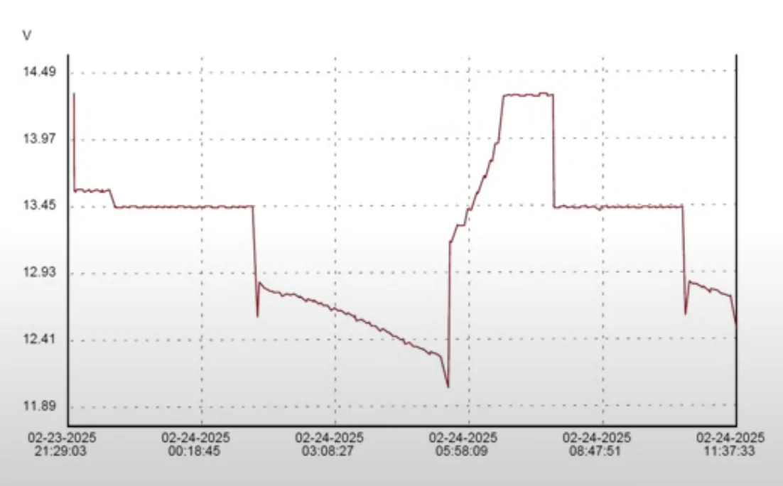

Yes, an AGM kept at a high level of charge can last many years. But since Rivian uses the 12 volt battery to power all the electronics, just waking up the vehicle drains 1 to 2 amps, and much more if the lights, climate control PreCool or PreHeat is on, etc. Since this is a only an 18 AH battery, one can see that it can discharge quickly several times a day.
Here's a Rivian charging profile from February 25 that somone captured. As a side note, anyone can do this if they desire using Home Assistant. I had Home Assistant running in a Docker container with the Rivian plug in and monitored this data for months... until the Docker container file system corrupted, and no, I didn't have a backup. I haven't rebuilt it yet.
As you can see, it Deep Cycle discharges to around 12.0 volts before the charge cycle kicks in. From the timeline you can see a sleep cycle at 13.45v, followed by a discharge until the voltage drops and the charge cycle kicks in. In this case, the vehicle was doing almost 3 full cycles a day. Based on this pattern, 80 a month, 240 a year. Your results will vary depending on Gear Guard configuration, how often you or Rivian wakes it up, temperature, and many more pseudorandom factors. Deep cycling a traditional Lead Acid battery like this will kill it quickly because it will sulfate. Deep Cycle batteries tolerate it better, but it's still quite a "workout" for a Deep Cycle battery.
Keeping the HVB plugged in does not directly affect how the LVB is charged. Rivian is monitoring the LVB and kicking in the LVB charging algorithm as needed, powering the LVB charger via the HVB. They don't run the LVB charger all the time, since that would create more "Phantom Drain" drain by powering up more subsystems for a longer time and less sleep time. That in and of itself requires more power from the LVB when charging starts. It's presumed that this algorithm/curve below is what Rivian has been tweaking to optimize the life of the 12 volt battery. There is also a thread here that indicates Rivian may have pooched a software update and some vehicles may have had 19 volts applied during charging, damaging the battery and leading to the proactive replacement program.
We clearly don't know many details about the charging algorithm and Rivian's decisions as to why they do what they do, but the graph below shows the final result that we can see.
