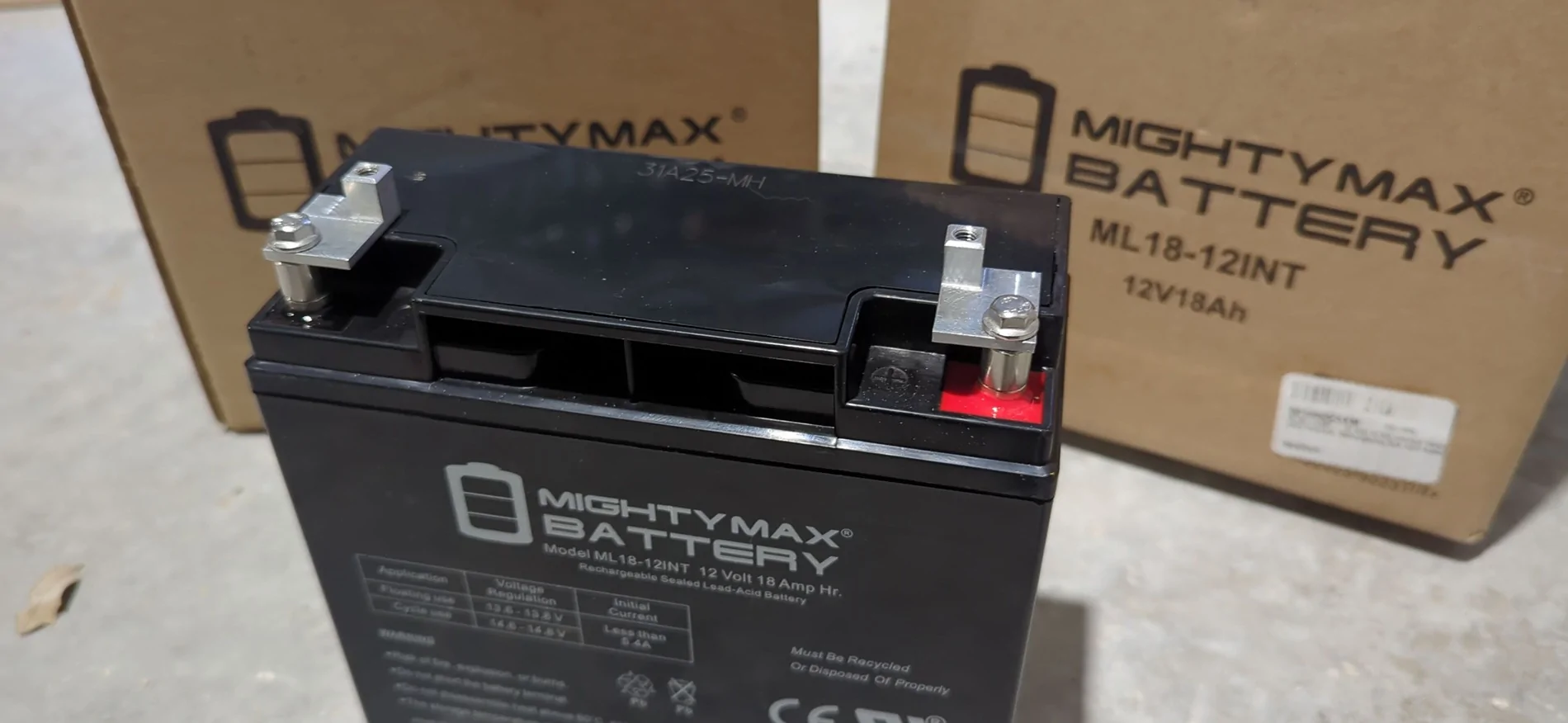

Good news and bad news.. i'm starting to suspect the ability for batteries to withstand modest potential current draws is higher than the requirement for them to be "deep cycle"
See https://github.com/kallisti5/rivian...guides/low-voltage/12v-replacement.md#context
I'm measuring 13A passing from DC/DC converter through to the PDU while the heater is running. That 13A isn't coming "from" the battery, however is passing "through" the battery terminal block from the DC/DC converter.
A battery that *can* sustain a short burst of tens of amps feels important.
I got the cheap amazon batteries "mechanically configured", but with the 5.8A "initial" current limit, i'm feeling less confident in them actually working.
Rivian R1T R1S 12V Battery Replacement Megathread terminals
The OEM batteries advertise "deep cycle", but they're also 150A peak per the spec sheet which isn't "deep cycle". Maybe that's why they die so quickly for a lot of folks 🤔
A deep cycle battery is fundamentally constructed differently than a regular flooded battery to withstand the repeated deep discharge. It's much more than just intial and peak amps, lol. Those of us with boating experience have seen people with the same "a battery is a battery, deep cycle, meh, machts nichts" attitude - and the result. They spec a deep cycle for a reason.

Ah ha. https://www.batteriesplus.com/productdetails/slahr12=20c_fr
That feels like a winner. "Deep Cycle", "High Rate". Dimensions are similar to the OEM battery. (only terminal is reversed)
It's also a "local" option which feels nice :)
Where does it say anywhere on that link "Deep Cycle". "High Rate" and "Deep Cycle" are not the same thing. And I'll give you a hint - the following statement from that page is directly opposite how deep cycle batteries are designed.
  • This SLA battery has thinner and more plates than a general purpose battery causing the plate structure to deliver power quickly
You're right.. but with your logic, the OEM battery is also not "deep cycle".
They say it, but delivering 150A per the specs isn't deep cycle
I feel like based on specs, the linked battery fills all the needs and is a similar use case (ups systems. Moderate draw, as long as possible).
To add a bit more here.. let's look at specs
* OEM 150A max per spec sheet. "Deep cycle"
* OEM changed secondary battery to a capacitor which is definitely not deep cycle.
* Standard group deep cycle battery 5.8A max
* Standard group battery motorcycle 250CCA
Essentially rivian is using a battery in-between deep cycle and high rate.
High rate seems a lot closer to OEM specs.
