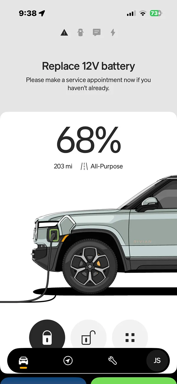

This is what The Count gets for making a glib comment recently about "what are you people doing to kill your 12 volt batteries."
3-and-a-half-year-old 12 volt(s) is (are) moribund. Got the alert on the app. Immediately The Count dispatched staff to schedule replacement. Rivian mobile service is not available as The Count's official address is one hour and 45 minutes from the service center. Earliest appointment at service center: 32 days out. LOL
The Count has another property that, as of a few months ago at least, was within the mobile service area. Climate controlled workshop where Rivian mobile service has worked before. Problem is, that mobile service was only possible because The Count talked to a human at the MF service center and it seems getting a real human at Rivian is no longer a regular occurrence.
That this happened the week before the R2 has The Count thinking this may be the end of his Rivian ownership for now. Not because the battery is failing; that happens. (In fact The Count himself just replace the battery in The Countess' 911.)
The doubts are from: 1) being forced to interact with AI that is dumb as a box of rocks and 2) no longer having mobile service as an option for simple items like this. Waiting over a month for a critical, yet easy and not time consuming, battery replacement is not great but how bad will the wait be once R2s are more prevalent?
Since taking delivery in December 2022 Rivian has opened three service centers closer to The Count yet mobile service is now not possible even though these three are two hours away unlike previous mobile services he received from the downtown Chicago center (~3.5 hours away with traffic).

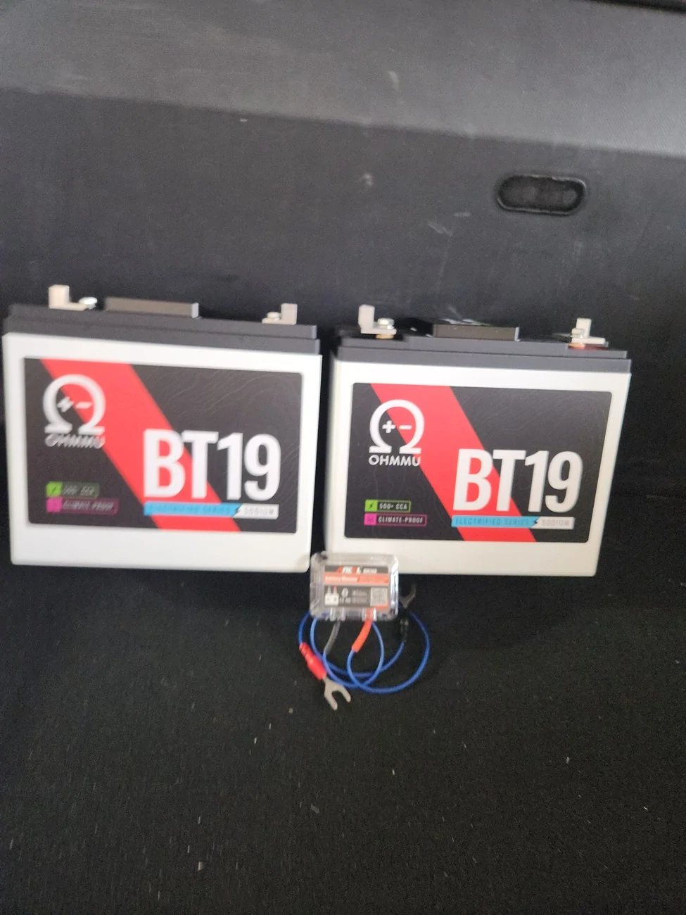

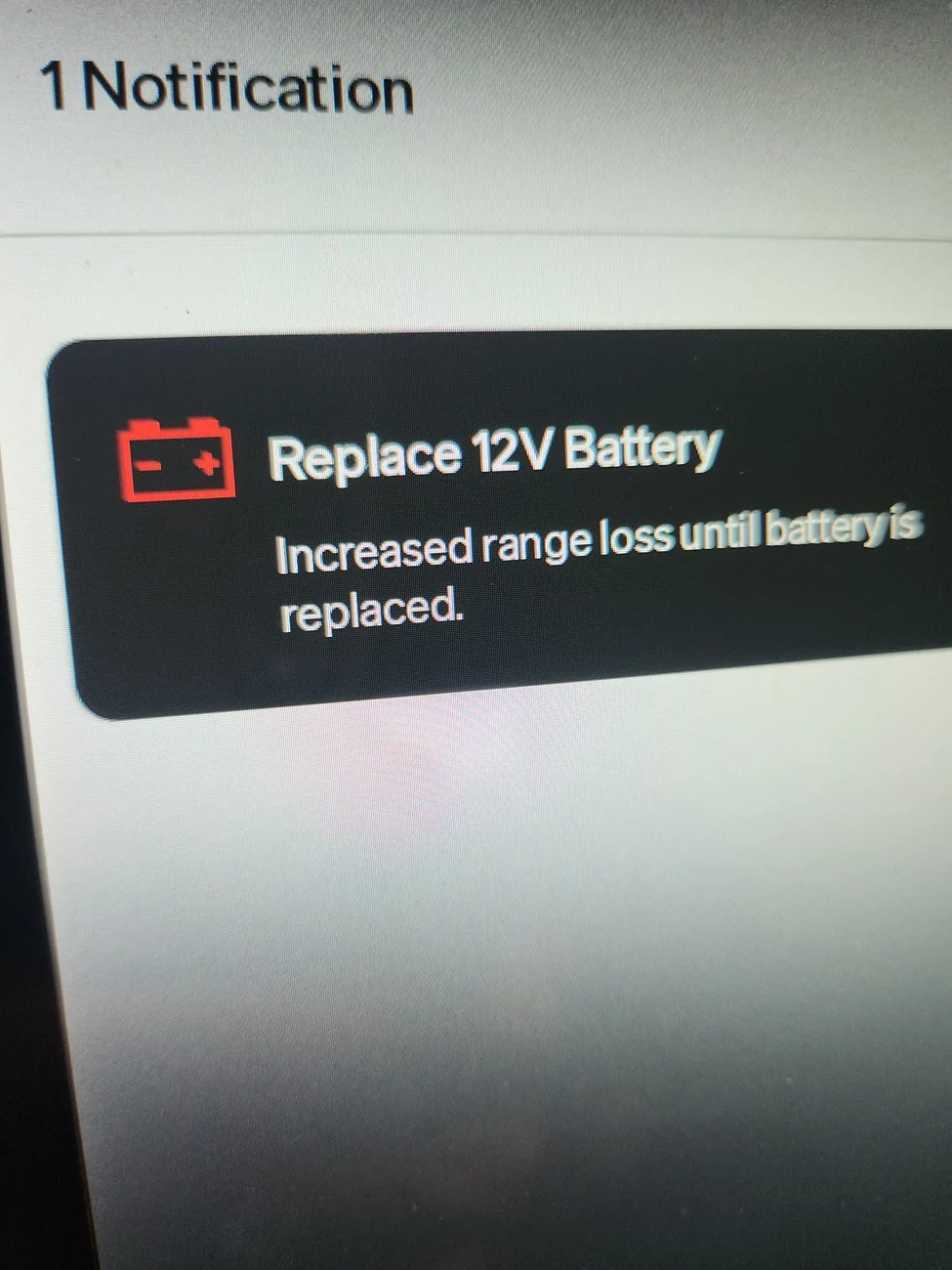

I installed my two Ohmmu Sodium‑Ion batteries a couple of days ago. If you’ve got an active on‑screen notification like the one below, you’ll likely need Rivian to clear it. Hard resets won’t do it. I had mine reset this morning for $56.75.
Rivian will warranty the OEM lead‑acid battery for 2 years/24 months, so that’s the one upside to sticking with their forklift‑spec battery setup. But why anyone would choose 100‑year‑old lead‑acid tech in a Rivian is beyond me.
I’m also running the Bluetooth battery monitor on mine. YMMV.

Just helped my neighbor replace his 9/22 OEM rivian batteries in the driveway. Took about 30-45 minutes, but can confirm he needed to plug in his work computer to clear the OTC error code. He had the same "replace battery" warning light as Mark. We talked about the Ohmmu batteries and even as an employee, he was on the fence about warranty issues with an aftrermarket battery. I'll let him know that the Service center had no issues servicing / clearing codes with those batteries..
