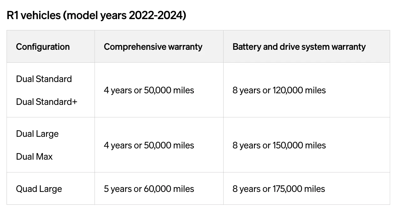

Drive train issues on '22 to '24 quad motor large pack trucks are covered by the 8 year 175,000 mile warranty (from what I can see).
I took my '23 T in for windshield replacement last Friday - got a call today that they are replacing the front half shafts and hubs. Had a senior tech go for a short spin around the parking lot so he could hear the little clicking sounds as I pressed and released the go pedal. I asked if the new parts are updated - any changes to metallurgy or design - guide said they were changed and are supposed to be more durable. Time will tell.
All that noise on startup doesn't sound right - but the way cell phones pick up various sounds makes it hard to know what you are really hearing. Hot day AC on high, mine sometimes sounds like a jet getting ready to take off for a bit, but then settles down. The AC works really well, so I'm not too concerned about the noise.
Get the truck to a Service Center if you can.
Rivian R1T R1S Dealing with SC that says issues are "normal".... Screen Shot 2026-06-16 at 1.30.39 PM

Drive train issues on '22 to '24 quad motor large pack trucks are covered by the 8 year 175,000 mile warranty.
I took my '23 T in for windshield replacement last Friday - got a call today that they are replacing the front half shafts and hubs. Had a senior tech go for a short spin around the parking lot so he could hear the little clicking sounds as I pressed and released the go pedal. I asked if the new parts updated - any changes to metallurgy or design - guide said they were changed and are supposed to be more durable. Time will tell.
A lot of people have not had their half shafts not covered under the drive train warranty. Only the 60,000 mile comprehensive. This is interesting

Is there fine print somewhere? Is drive train only motors and batteries? One would think everything between the battery and the wheels is part of the drive train.
