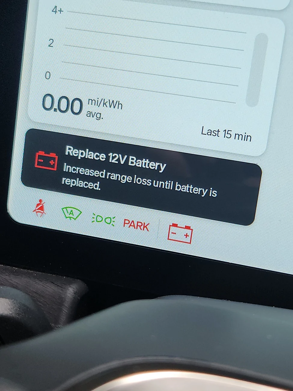

Just by expressing doubt and thinking about this 12v issue being the end of his Rivian, sounds like the Count has made his mind already...
3.5 years on my 12v, $400 some dollars mobile service within a week of the 12v notification, and 65k miles, plus full suspension update prior to the comp warranty expiring has me eyeing 150k miles...
Then this afternoon in traffic, the tocking sounds, aka loose half shafts returns. All of a sudden the Carvana "your R1T is in high demand" email arrives $5k higher than last month ...

Just helped my neighbor replace his 9/22 OEM rivian batteries in the driveway. Took about 30-45 minutes, but can confirm he needed to plug in his work computer to clear the OTC error code. He had the same "replace battery" warning light as Mark. We talked about the Ohmmu batteries and even as an employee, he was on the fence about warranty issues with an aftrermarket battery. I'll let him know that the Service center had no issues servicing / clearing codes with those batteries..

He did pull the fireman's switch, which I believe is required. His already had the "replace 12V battery" message , which cannot be cleared without connecting to a Rivian Service computer. I'm not sure if you will get a 12v battery warning light (OTC) if you replace the 12V batteries before you get the "replace 12v battery" warning light. He did say replacing the batteries required the calibration of the IBS sensors (intelligent battery sensor) located on top of the batteries.
humm... that's a new one for me. Does anyone know if that process is available in RiDE?

No, it is not available via RIDE. if you have That Notification it can only be removed by Rivian service. I had it done yesterday as I exhausted all other options.

Car batteries in ICE generally last 3-5 years? Given gen1 has more computers and active system (while parked), 3.5 is probably the best one could expect? Cost of replacing two at a time stings though. Makes me wonder if half that is the expectancy of single battery gen1, which is just about the duration between 1st and second “pre-emptive” replacements on mine.
There is no complaint in The Count's post about the failure; it happens. A voltmeter, however, would be a nice addition to the system monitoring display.
Oddly service can't tell if the royal 2022 R1S is one battery or two.
Was offered mobile service about a week early. The Count said yes please schedule it but has not heard back.

Not meant to suggest you were complaining. Just noting how long you got out of yours compared to typical lifespan of 12V in ICE, which tracks, and in contrast to popular accusation that Rivians consume them aggressively… partially true (when BMS wasn’t right). Also tracks that perhaps they went to a single 12V prematurely (before they reduced overall consumption in gen2).
MY22 is most likey dual 12V. IIRC, the move to single didn’t start until late spring ‘23 and MY23 production started around September ‘22.
