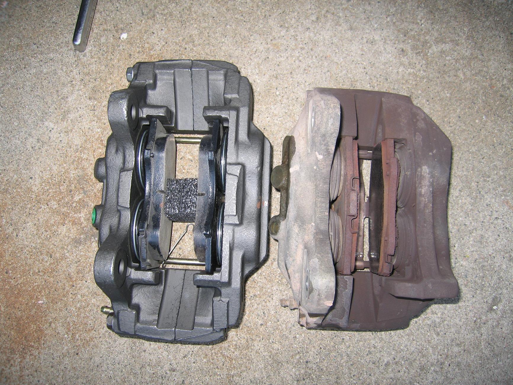

On my third Gen 4runner I swapped the bigger rotors and calipers from the tundra to it. They bolt up but the 16" wheel on the tundra was shaped just a little bit different which cleared the cross passage between the pistons.
I clearanced the passage a bit with a grinder. So someone is going to have to verify manually if there are some sort of changes Rivian made.
