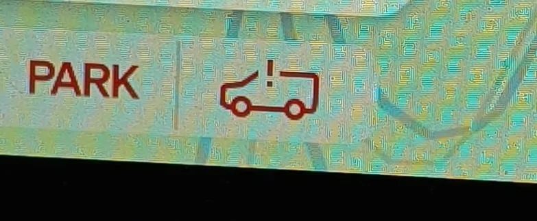

PSA, if you get a "Coolant Level Low" message on your early Gen2, recommend you take it seriously. There seems to be a growing problem with the Degas bottle failing and leaking slowly. The service folks said in the past that sometimes this message was just some air in the system and wasn't always as pressing (so to speak) but they have had 6 Degas failures at our location in the past week so it might be those early Gen2 VINs starting to fail. They fixed it up no issue but it did take a couple days.
The coolant low message usually shows the attached image and sometimes says "Service Vehicle" but then mine actually cleared after a while of driving... but was still a real leak, so if you don't want to end up in turtle mode at an inconvenient time, recommend scheduling service if you see the message even if it clears for a while. Good luck!
