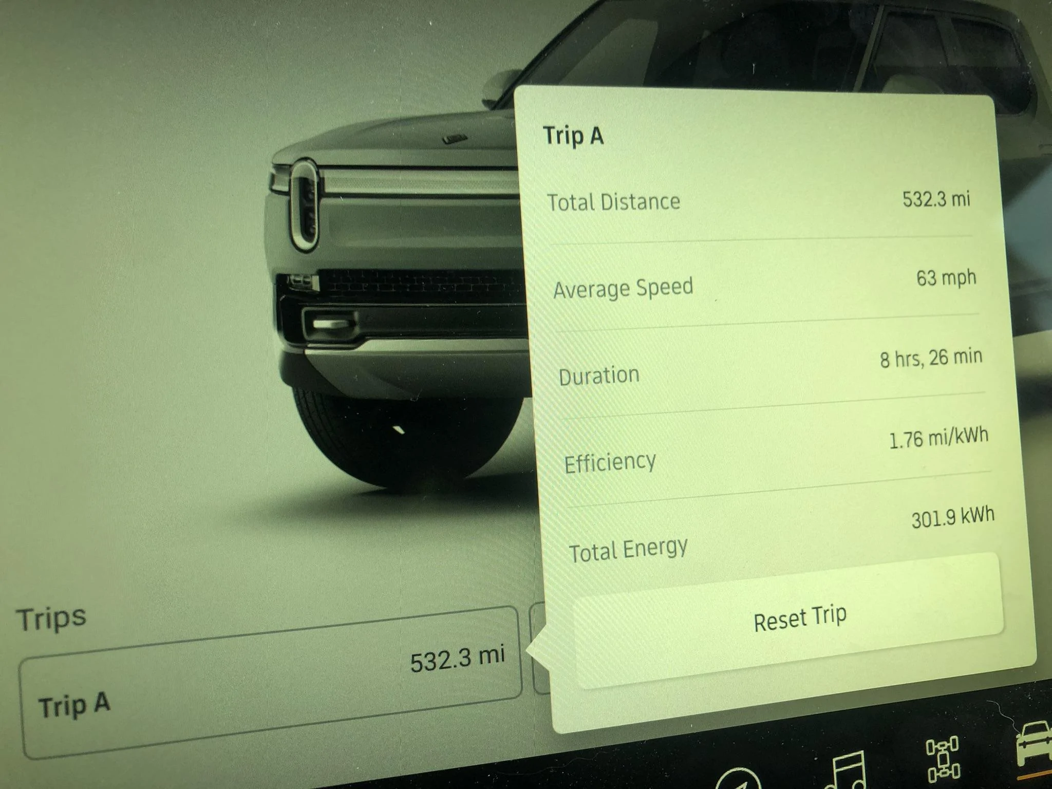

Shocking to only get 1.76 seattle to Boise. Threw off all my trip pre planning.
freezing rain over snoqualmie pass probably contributed for part of that but all melted by the time we reached the blue mountains

What's your tire pressure?

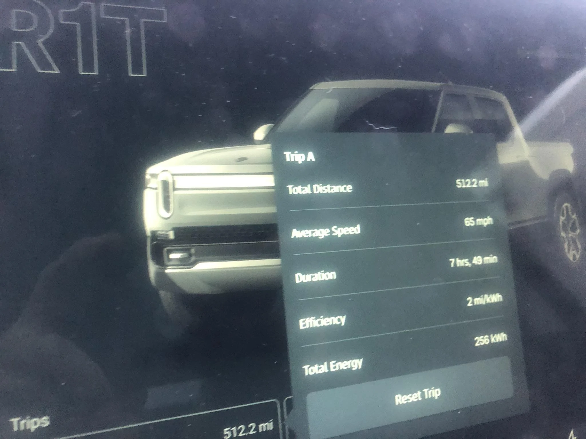

FOLLOW UP- RETURN BOISE TO SEATTLE
We got 2.00 on return trip. Did have freezing fog around Pendleton with some build up and heavy snow/rain over snoqualmie with some slush on the road. I chalk up the worse efficiency on the Seattle-to Boise leg to headwind.

...and we did with over a 50 mile buffer.
