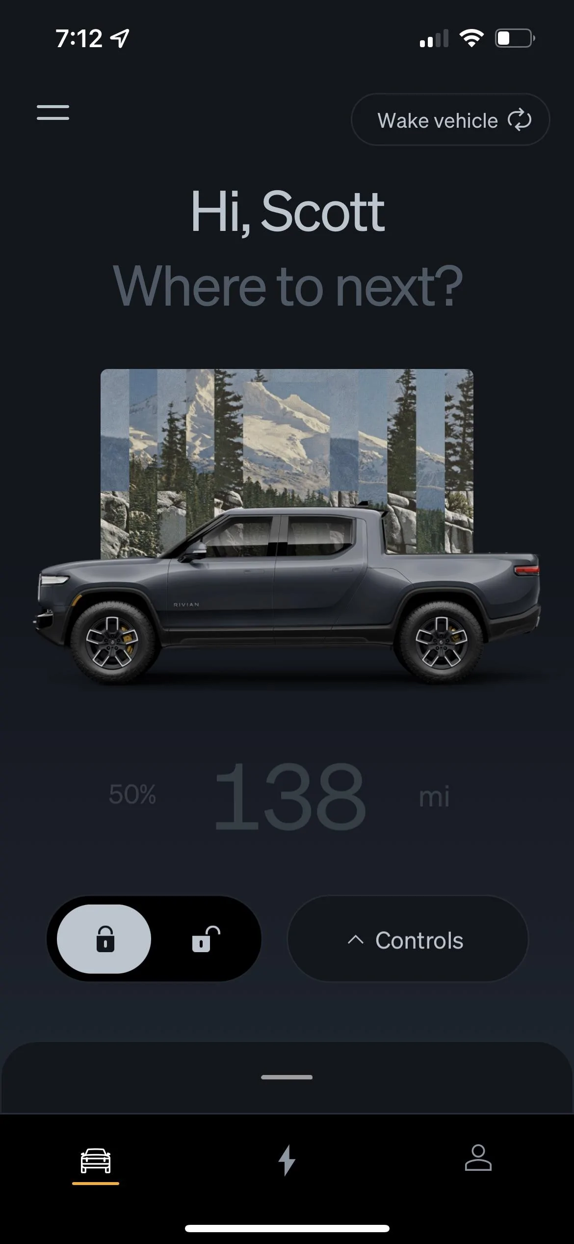

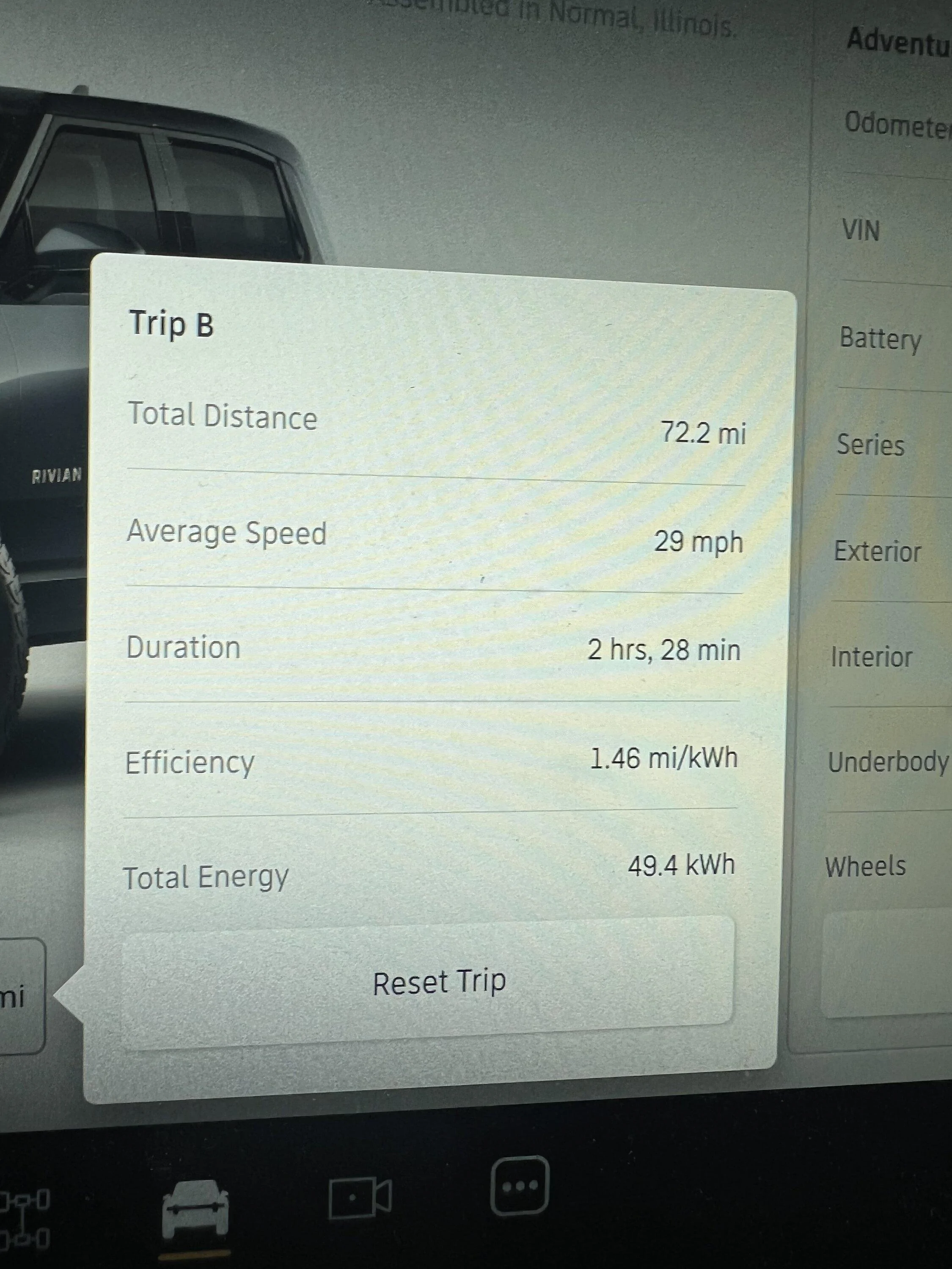

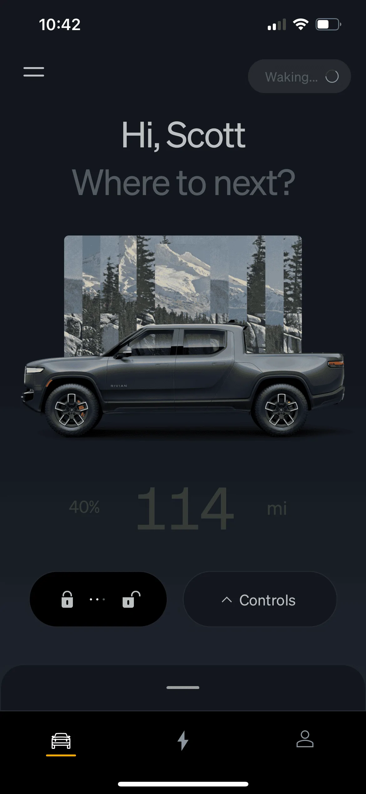

Am I the only R1T owner in this forum getting terrible efficiency numbers?
I have the 20” AT so it’s expected to be less than the 21 or 22’s but I am avg 1.44 mi/kWh in daily driving. Hardly ever punching it.
also one night in 4 hours lost 10% SOC ?
Take a look: you can see from the time stamp what I lost!

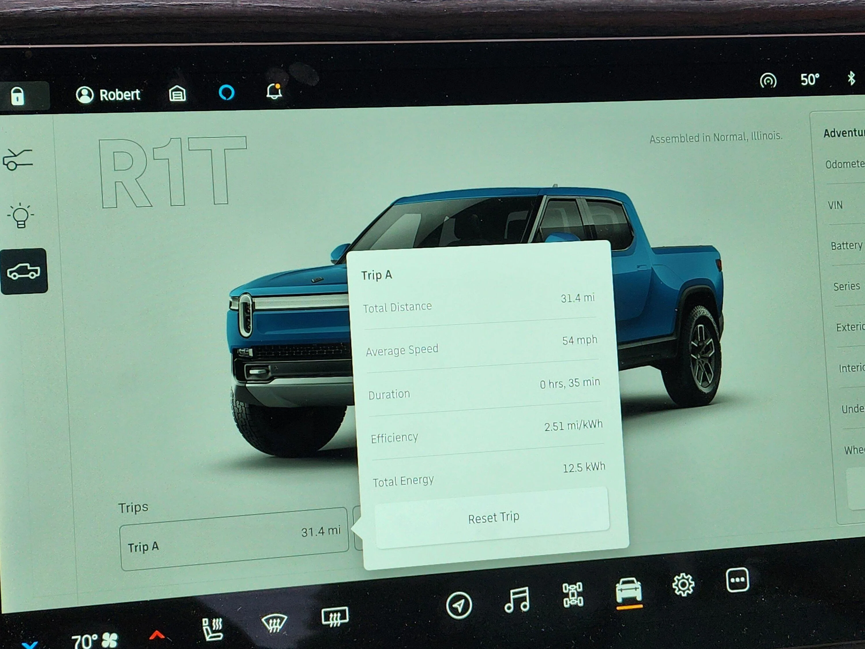

Did you get this issue resolved?
For reference my truck just came back from the service center for firmware issues, but they double checked the alignment (which was basically perfect on delivery day) and tire balance. I did a test drive to examine efficiency and was shocked to get 2.51 mi/kWh on my 20" ATs in all purpose mode in 50⁰F weather. The following were key factors: there was no wind and I drove as steady as possible in the right lane of the highway, which was fairly flat and had few bends.

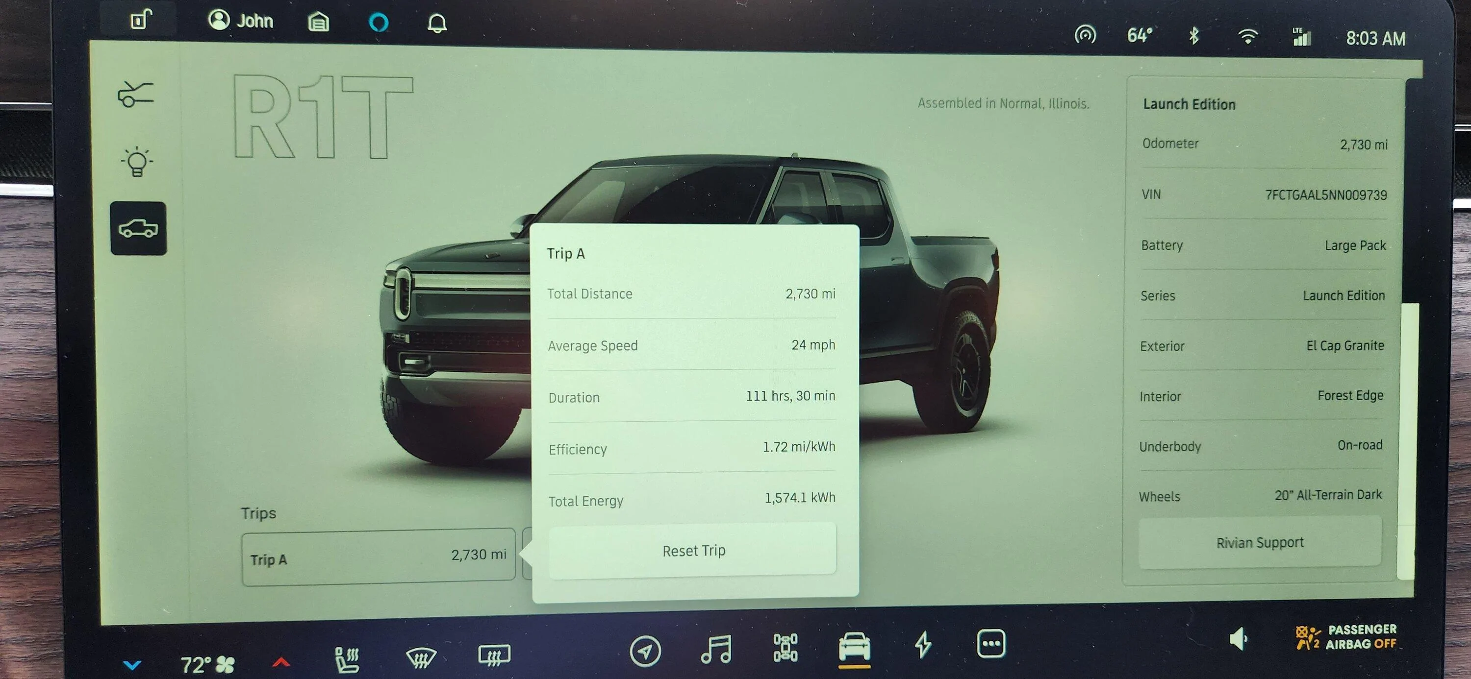

Just to add in, my life time efficiency also seems below average. This is in FL, with mostly around town driving. Only a couple 100 mile+ road trips. Mostly flat around here. 20" ATs, rails on the back tonneau closed.
