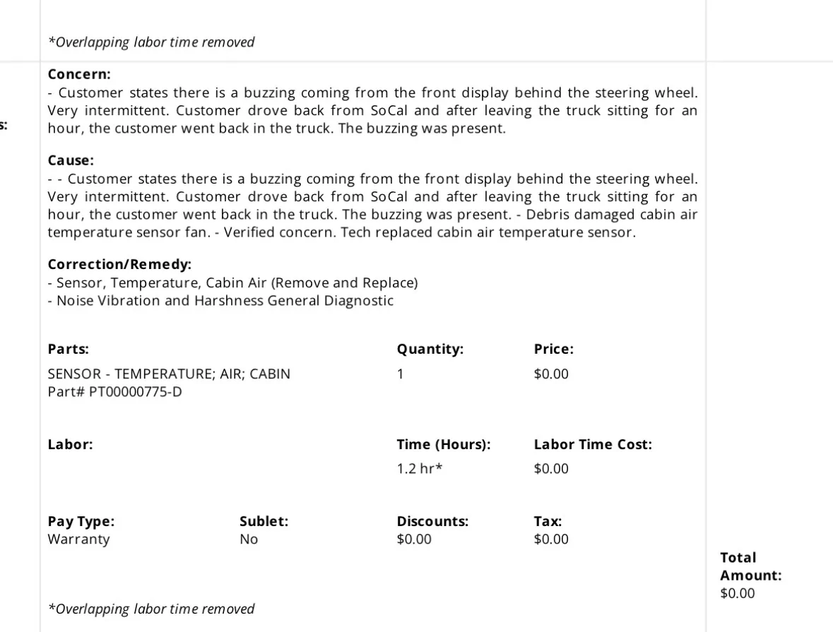

I had the buzzing noise behind the driver display. They replaced the temperature fan behind the screen and it went away. The loaner that they gave me had the same issue too.

Yep. That’s the temperature sensor fan. Mine made the same noise.
