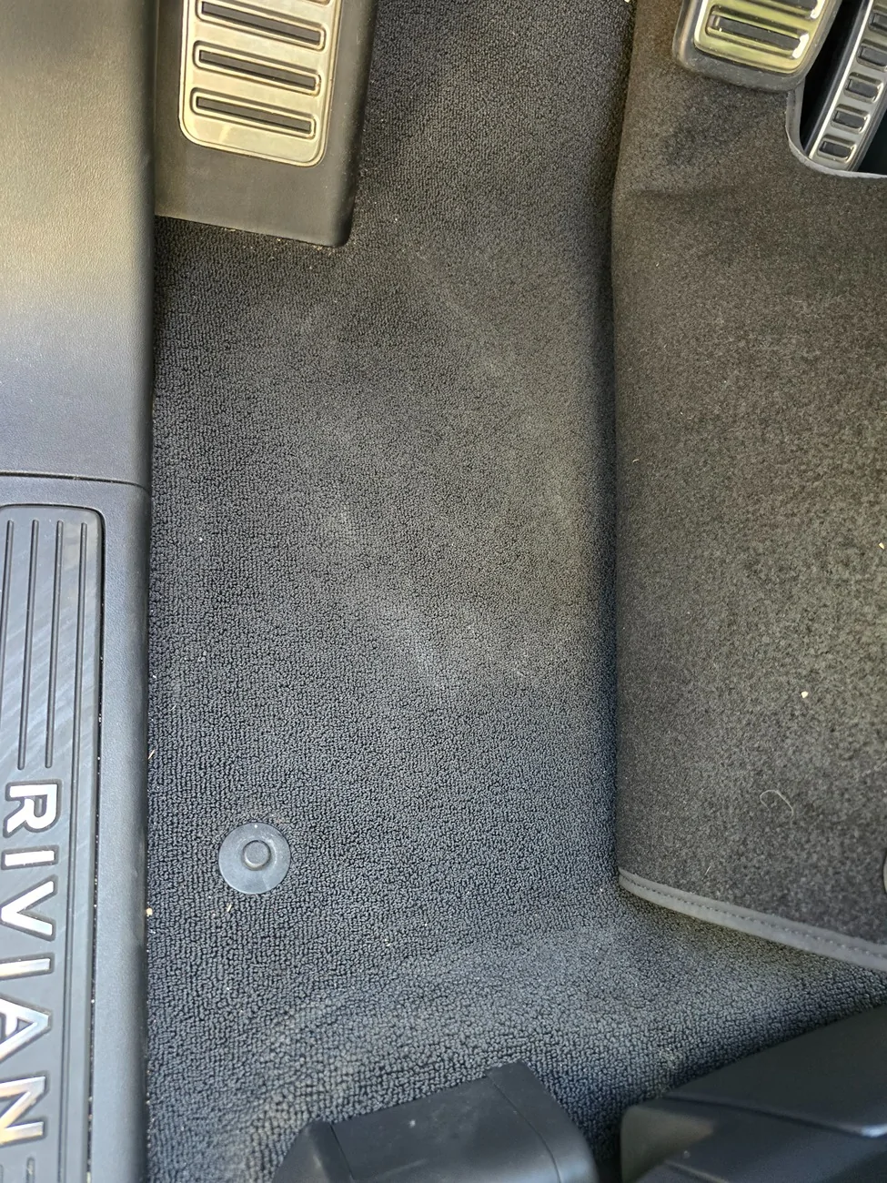

Pulled the driver mat to vacuum around it and noticed this today 🤔 Not sure how long since I last moved the mat. Also not sure on a source, havent done much digging yet.
Where are you guys getting wet spots these days from the HVAC? Mine has been probably 50k mi since they replaced the entire HVAC unit Sept 2022.
Where are you guys getting wet spots these days from the HVAC? Mine has been probably 50k mi since they replaced the entire HVAC unit in 2023(?).
That's where mine was. Just had the AC replaced due to this.

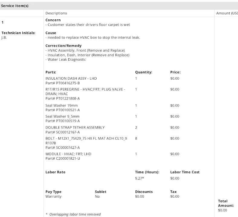

Here's the completed invoice for HVAC case replacement, round 2! Sidenote, my steering wheel heat is not working now, guessing it was a victim from the disassembly of the dash. Coming out in a few days via Mobile to resolve.

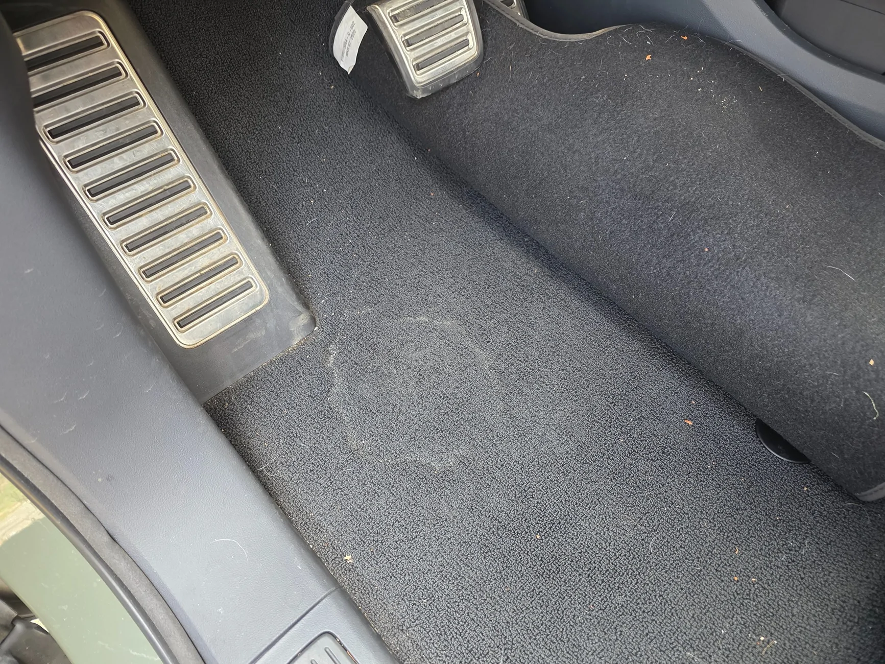

Hi, three days ago I took delivery of a used 2024 gen 1 R1S directly from Rivian (VIN 32xxx) with 23k miles. It's my first EV. Today I noticed the wet spot under the driver mat, and discoloration of the cabin carpet. I suspect this same HVAC issue is the cause, which was probably missed during Rivian's inspection process too.
Questions for you pros here - should I try to get this fixed under warranty, or return this car altogether since still with the 7-day return for preowned vehicles?

I would bring it right back and threaten to return it.
My Gen1 R1T has had 3 HVAC replacements for this. The last go around, after ripping out the interior and extensive testing, they found a problem with the size of the hole/channel where the modified drain plug fit… or at least that’s what they told me. They had to modify the actual hole that’s cut in the floorboard.
They said to test it, they ran the HVAC continuously in the shop over a weekend to see if the water backed up.
Long story short, the published fix they have for this has not been working. If my truck was doing this and I was in a window to abort and switch to another truck, I would.

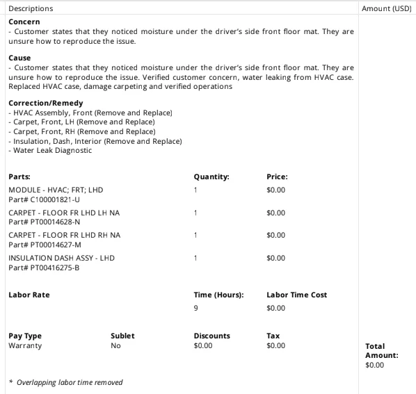

Update: I decided to keep the SUV. It was repaired under warranty. I was told they replaced the HVAC assembly box, re-sealed the dash, and re-did the insulation to the interior. Carpet was not replaced, but deep cleaned and the stain is gone.
See service recap here. Fingers crossed I did not make the wrong decision with keeping this car.
