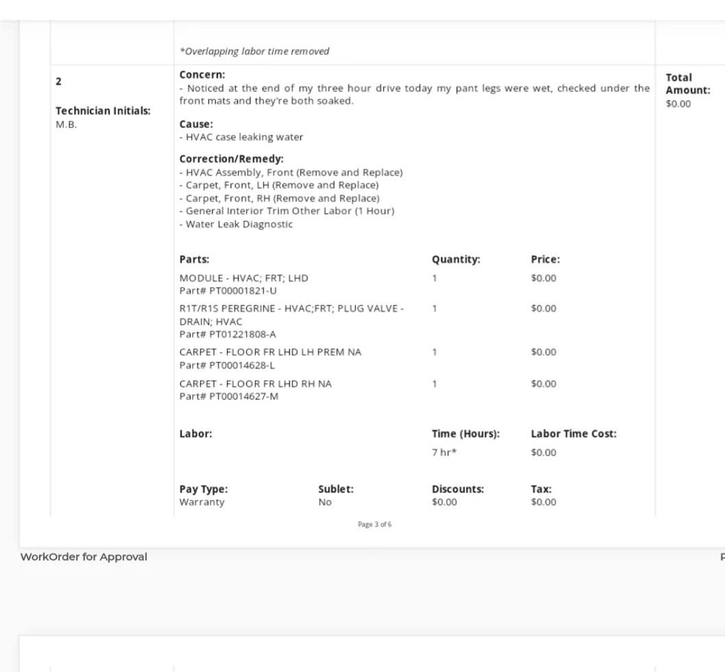

Yes, design flaw in original units. Crack in HAVC assembly forms allowing water to drain into the floorboard instead of out the condensate drain as designed. I was told Rivian has a revised part number.
Unfortunately my wife's June 2023 build R1S had this issue. Rivian ultimately wound up replacing it to to delays in getting it repaired mold/mildew issue developed.
I made a video documenting what she went through. Ultimately Rivian made the situation right and kept my wife in an R1S the entire time (Half in a rental and half in a service center loaner). Went in February 9th and we finally resolved this on May 20th. My advice is if you discover water in the floorboard have it addressed immediately by Rivian.

No not that I recall. The vehicle just slowly started developing a smell. It got so bad that I started smelling the smell on my wife after she got home. She has a 45-60 minute commute. Between the delay in bringing it in and it sitting in the service center parking lot they couldn't get the smell out. It wouldn't surprise me if it caused a problem with any electrical connection in that area.

I was told the problem starts as a result of a crack forming in the HVAC assembly not from a clogged drain.
You need to call Rivian service support and tell them the carpet is wet and a smell is developing.
They should get you in sooner than 2 months.
The water issues needs dealt with immediately, then HVAC disabled (maybe put truck in shipping mode?), then it can sit and wait for service. Otherwise you'll never be able to get the smell out.

We noticed this in our 1-year old R1S last week. We were able to get a service appointment two weeks out (which the service advisor told us was probably due to someone cancelling because they were 6-8 weeks out). I got it dried (also check your passenger side) by running an electric (not USB) fan on it overnight after using my shopvac to get as much moisture out as possible and the carpeting dried.
Not running the A/C has kept it dry. We had a long trip yesterday and it was pretty wet (we needed A/C) but I put a shop towel under the floor mat and swapped it out twice to soak up the water as much as possible and then did the fan thing last night. Small mildew smell, but not unbearable yet.
Another question for those of you who have had this: Our Chilewich mats smell like mildew...Did Rivian replace them too in addition to the carpeting?
Rivian will replace anything that smells like mildew. Unfortunately in our case they replaced all the carpeting and all the seats in the r1s. Officially they claimed it was fixed, but I talked to a couple Service Center employees who I will not name and they admitted that it still smelled. Ultimately rivian replaced our r1s.
If that water is allowed to sit there for 2 weeks it's going to get bad and a fan is not going to be good enough. Unfortunately you need a dehumidifier. Once the smell gets to a certain point it will spread throughout the vehicle. Before we right before we dropped it off I could smell it on my wife after she Left the vehicle.
The good news is I was told by rivian they do have a redesigned part. So once the HVAC assembly is replaced for this issue, it should not occur again.
Hoping for a speedy resolution for you.

I'll suggest you do a couple of things until they can service it:
  • Dry your carpeting completely using towels and fans - check the passenger side as well
  • Limit using your A/C as much as possible - that means not at all if you can bear it in Orlando
  • Check the carpeting each evening and do the fan thing if needed
We did find we could do short trips (15-20 minutes) with the A/C on without the carpet getting wet again. We didn't push it. When I did the 2-hour drive in August to the SC in Gaithersburg MD, I did it without A/C. Good luck!

I would add that if you have a dehumidifier that will be the best solution. Put it on high with the door ajar and sit it right next to the truck with the truck in the lowest ride height setting. Should dry it out pretty good.
I definitely don't wish what we went through on anyone else. Rivian resolved it ...but...it was very stressful and took a long time. Once the revised part is installed the problem should not reoccur.
