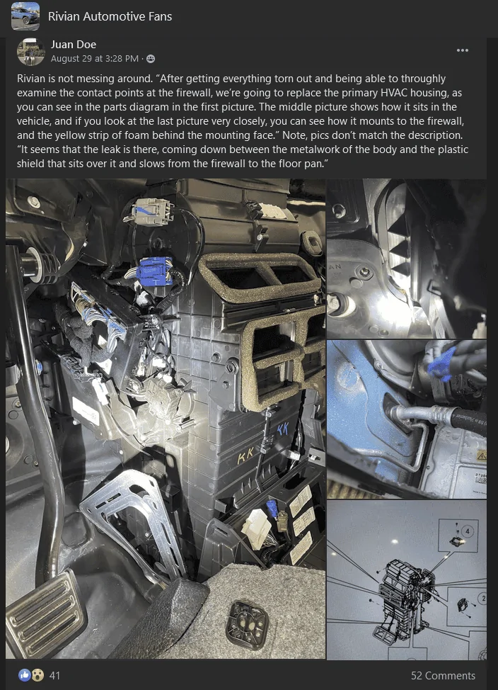

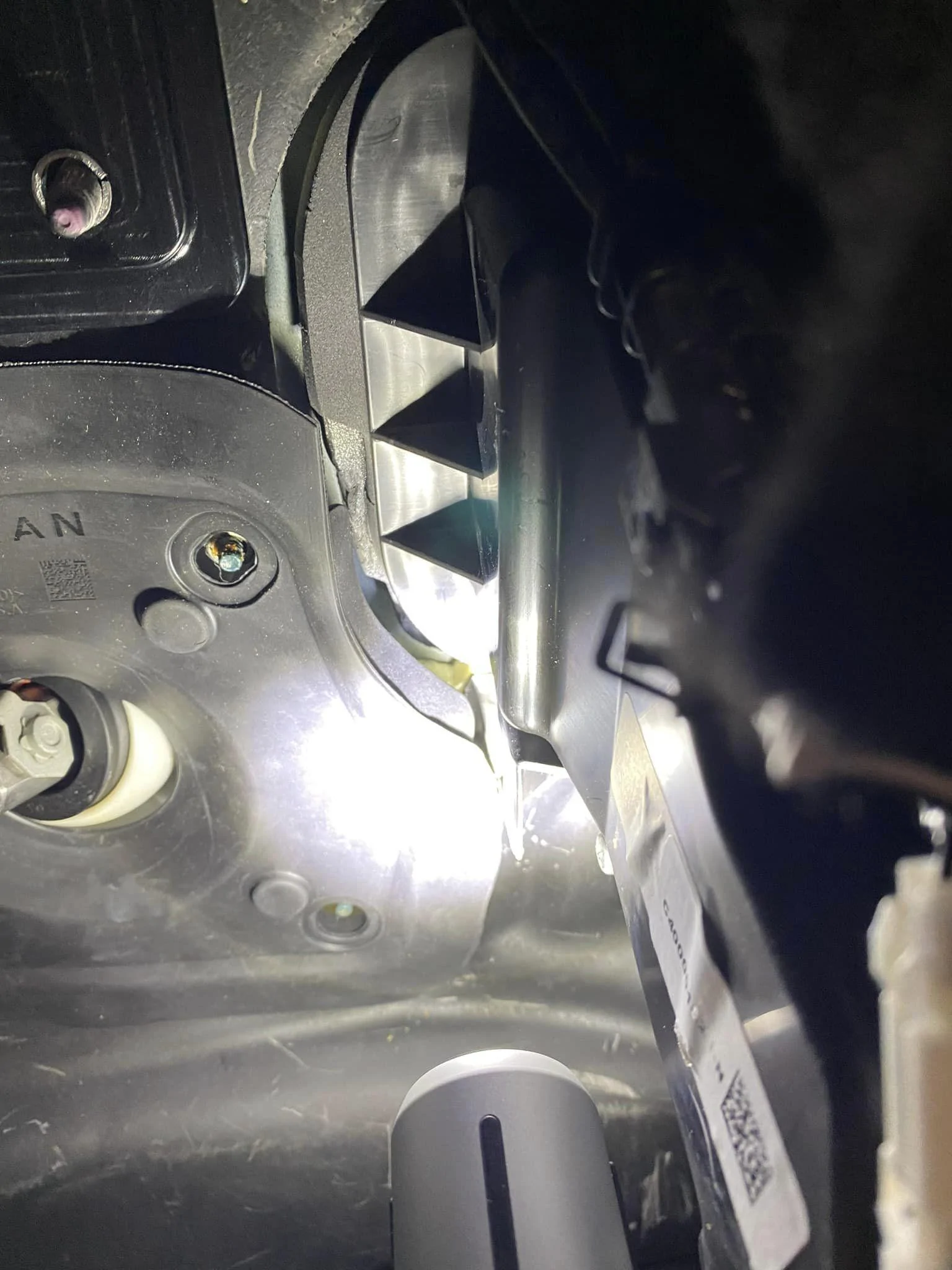

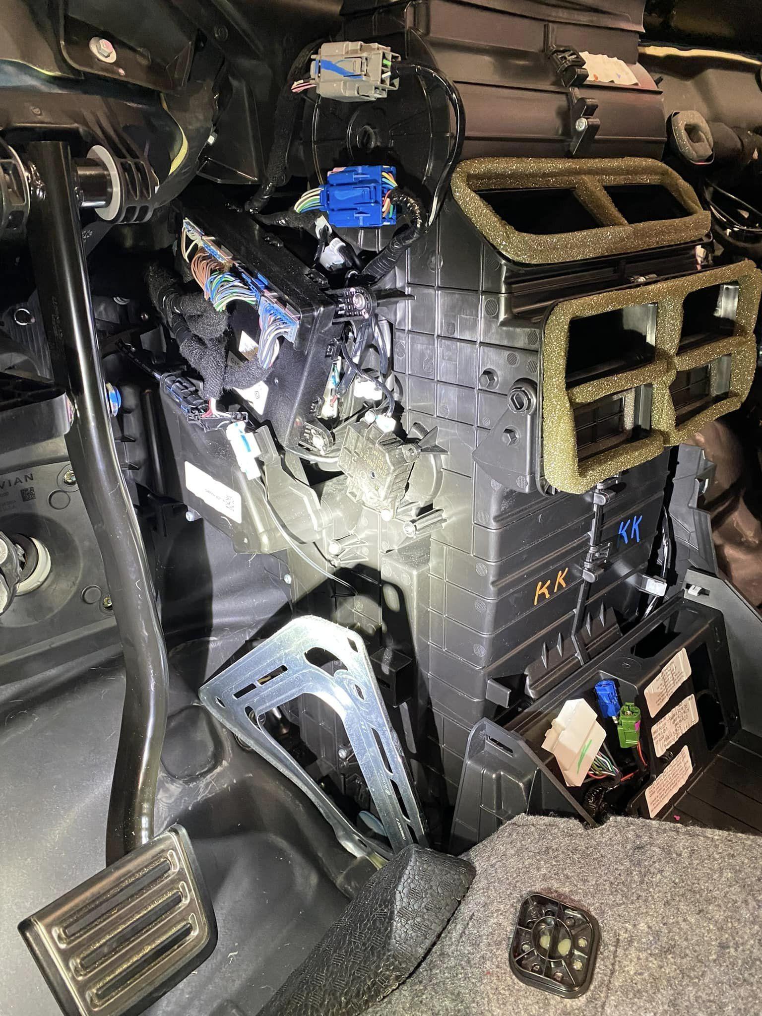

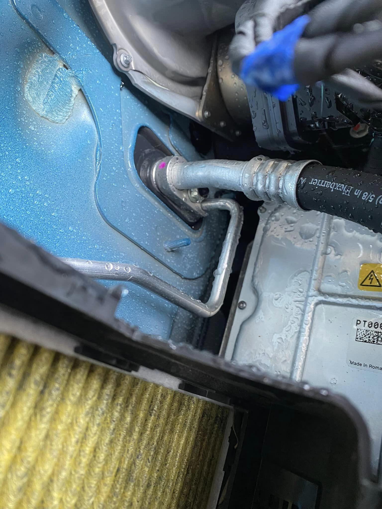

A buddy over at Rivian Automotive Fans Facebook page posted his repair process for the known issue you're having.
Rivian R1T R1S Wet spot under driver mat 1663168928726
Rivian R1T R1S Wet spot under driver mat 302560580_10222516307358025_1101625091559856774_n
Rivian R1T R1S Wet spot under driver mat 302288953_10222516307718034_5291104740382765801_n
Rivian R1T R1S Wet spot under driver mat 302448610_10222516307278023_8655897103879678863_n
Yeah I saw John Doe pics on the Fb group, saw his pics the night before I scheduled the appointment. Rivian5 wanted me to drive and wait for the truck work to be done same day. I saw Doe pics and said hail no I am not waiting, no way it's done same day.
