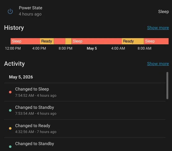

I have had this issue for months with my iPhone on multiple versions of the Spotify app. I have not been able to figure it out. I was not associating it with the Rivian, but now that you mention it - 🤔
I'll have to pay more attention to exactly when it happens, what connectivity I have and what the Rivian Power State is at the time, which is logged in my Home Assistant.
