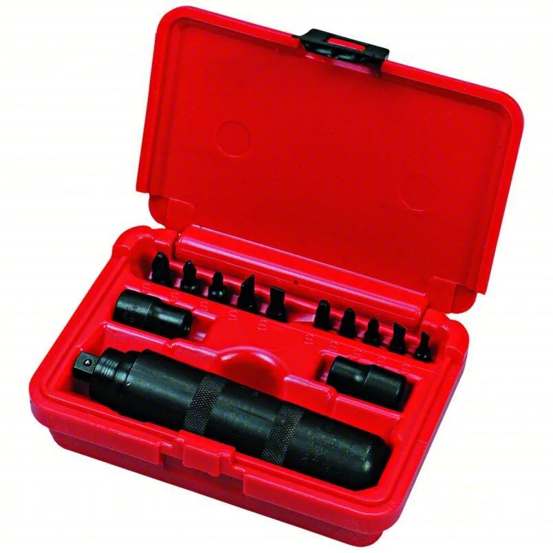

Last ditch effort it to use a small die grinder with a cut off disc attachment to notch a slotted or a cross pattern onto the head of the bolt. Then use a manual impact screwdriver to "convince" the bolt to leave.
Of course, you would need to replace the bolt.
