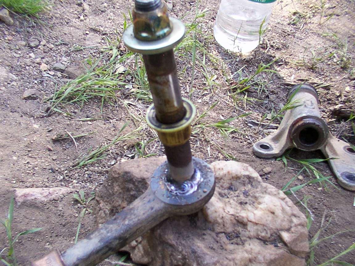

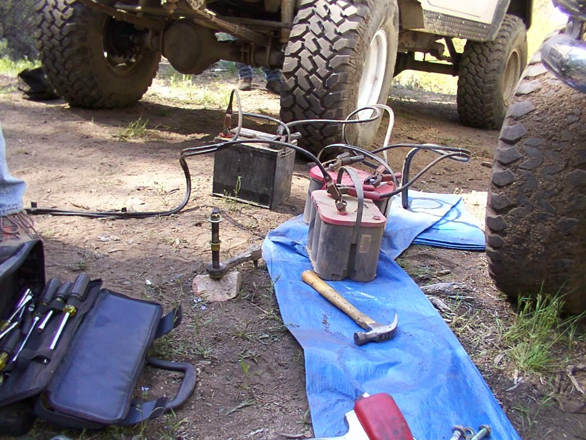

The high voltage pack is not grounded to the chassis. As far as the 12V, I've literally used car batteries and jumper cables on the trail to weld steering and motor mounts back together so I have a different perspective about worrying for the batteries when they aren't in the loop. :p

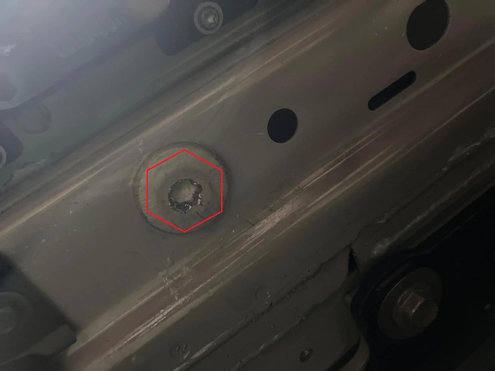

Use a grinder to make it a hex head bolt:
Rivian R1T R1S Stripped TP55 Bolt - how to extract? 1748703865429-j1
