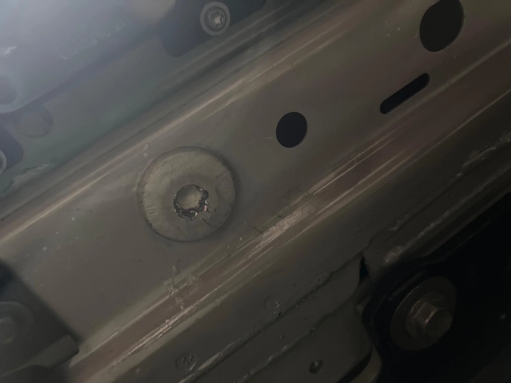

Stripped TP55 Bolt - how to extract?

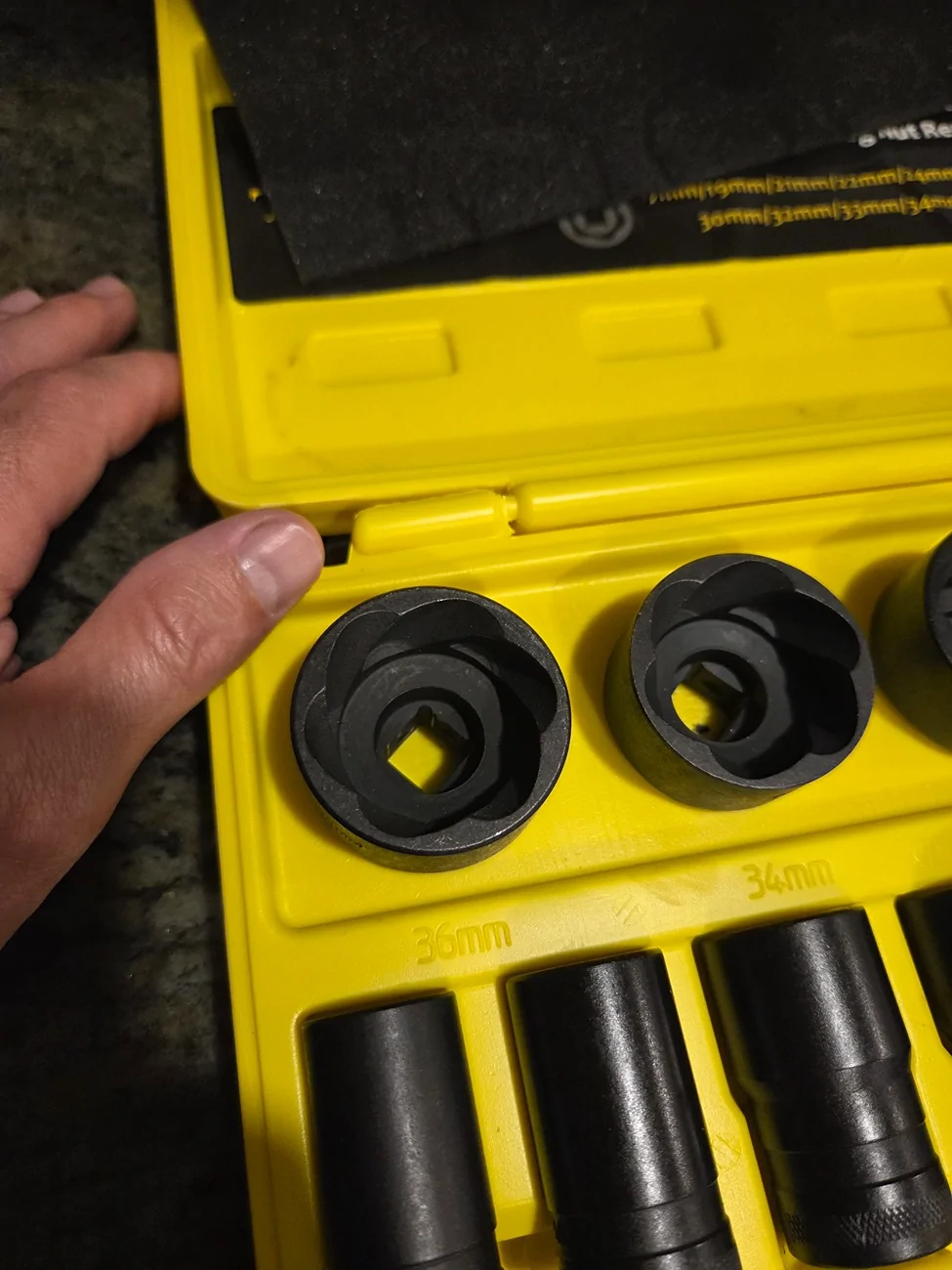

This worked for me (after many other failed methods/attempts)- Topec 36mm bolt extractor. It was alot easier than expected. If your reading this thread, you're probably in a similar jam, trying to figure out how to get that stripped bolt out of your truck. Hope this helps!
This one? https://a.co/d/7g9I63Z

Shoutout to t-bone! I used the Topec 36mm extractor as recommended by t-bone and it worked like a champ to remove the two stripped bolts -- one that I stripped and one that was most likely stripped at the factory. A word of advice, if you are trying to install the EVBase running boards DO NOT use the L-shaped tool that it comes with, or you too will strip the bolts. Spend a few extra bucks on a quality Torx Plus 55 bit and save yourself a lot of frustration.
Does this grab the outside diameter of the head?
Same question here. Do you have to square the existing round head by grinding it first or just slip the closest sized extractor socket over it without modification.
Before you resort to permanently alter the factory bolt... I would first heat the offending fastener with a soldering pencil to soften any thread locker it may have. Then slip the closest size extractor on to the bolt head. 36 mm is what's been mentioned in this thread. You might even try a mallet on the extractor, to give it a good initial bite.
