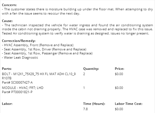

Received an update from the service manger in Atlanta yesterday, he stated there was a shipping /freight method delay for a part which was the cause for my truck being at the SC for over a week. It was a mishap, and it was a Rivian whoops when the part was ordered. The truck will be finished this morning and on a transport this afternoon back to me before I head out on a trip first thing Saturday! Once I have the service ticket details and a full breakdown of work done to resolve the water under the driver carpet issue, I will share. I should have those details later today.
jerseyff
jerseyff
Darren
Aug 3, 2020
736
985
McDonald, TN
R1T; Model 3 Highland
Final update...the work was completed yesterday morning. They arranged transport back to me same day as I am leaving town and they were rockstars and arranged for it to be back prior to.
Here is the invoice details related to the water leak into the cabin floor area...
Rivian R1T R1S Wet spot under driver mat 1663331767497
Case closed. I hope tracking this issue has or will help to provide some valuable information to someone else in the Rivan world. Truck is running great, I'm excited to be able to use the cool down feature again and not worry about pooling excessive moisture in the cabin!

Do we have any information to believe this is a design issue on EVERY truck, or just a random bad part for you?
jerseyff
jerseyff
Darren
Aug 3, 2020
736
985
McDonald, TN
I cant confirm either way. The service manager I was talking to about my truck said it was a faulty component with the HVAC system, he did not elaborate on if it was some or all units.

they replaced the whole inside unit on my truck. so far no leaks. took roughly a week to get the part in.
Mine too. replacing the component fix the leak for me

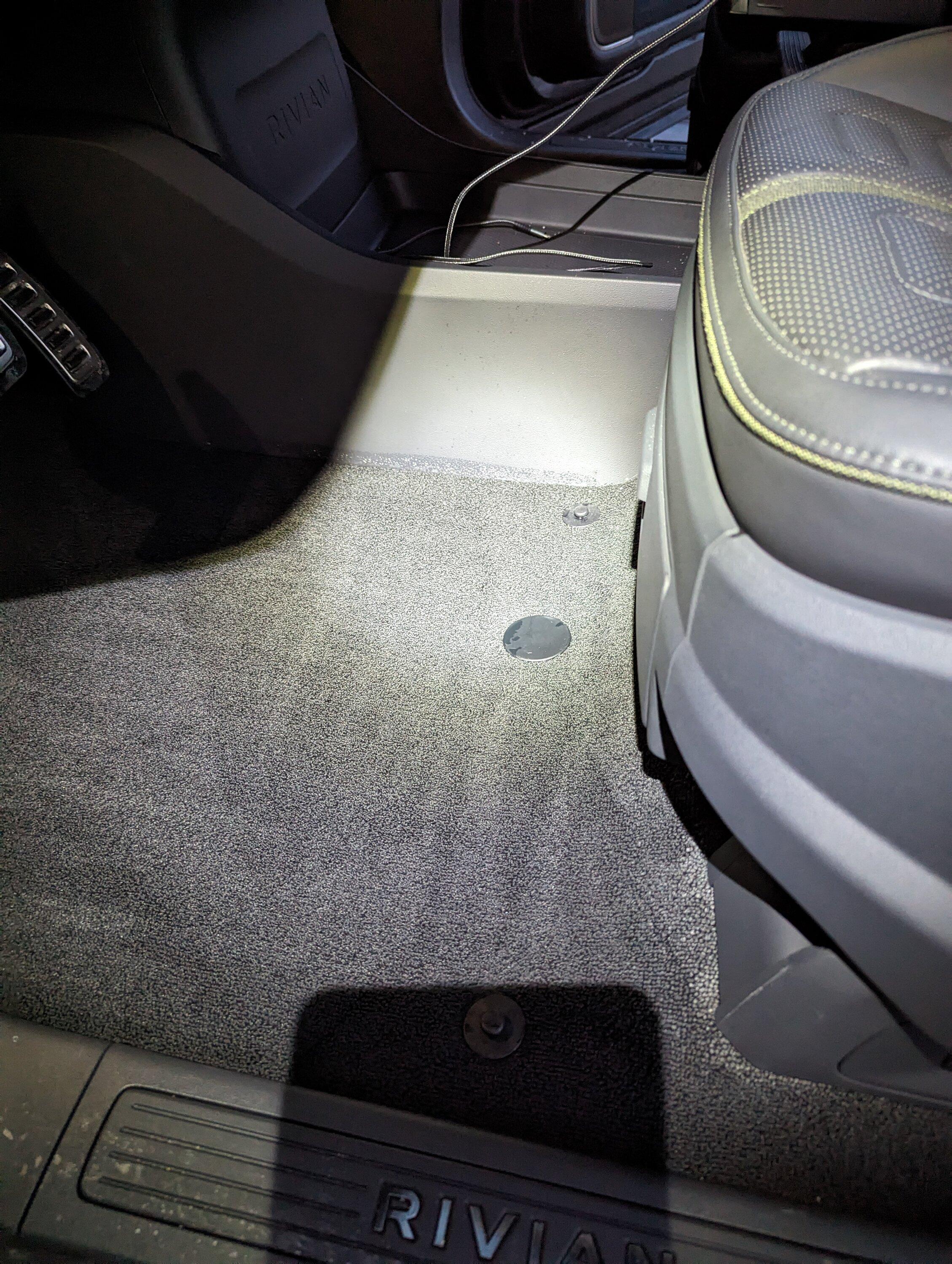

I just pulled up our rubber mats today to clean them and of course they were wet on the bottom. Pretty sure this is happening to us. It hasn’t rained here in Austin in a while and I last washed it a month ago.
JWreck
Josh
Oct 3, 2021
288
394
R1S (pre-ordered, Audi RS5 Sportback
The picture below is what I lifted up the mat to find.
Rivian R1T R1S Wet spot under driver mat IMG_0450
After submitting a service ticket, I cleaned the carpet (chemical, steam, chemical, steam, carpet extractor) and now they’re drying with a fan. Sure wish this car had an on/off switch…

I should update this , as my original replacement leaked again. And they recently replaced it again. Not too happy as it happened last year as well.

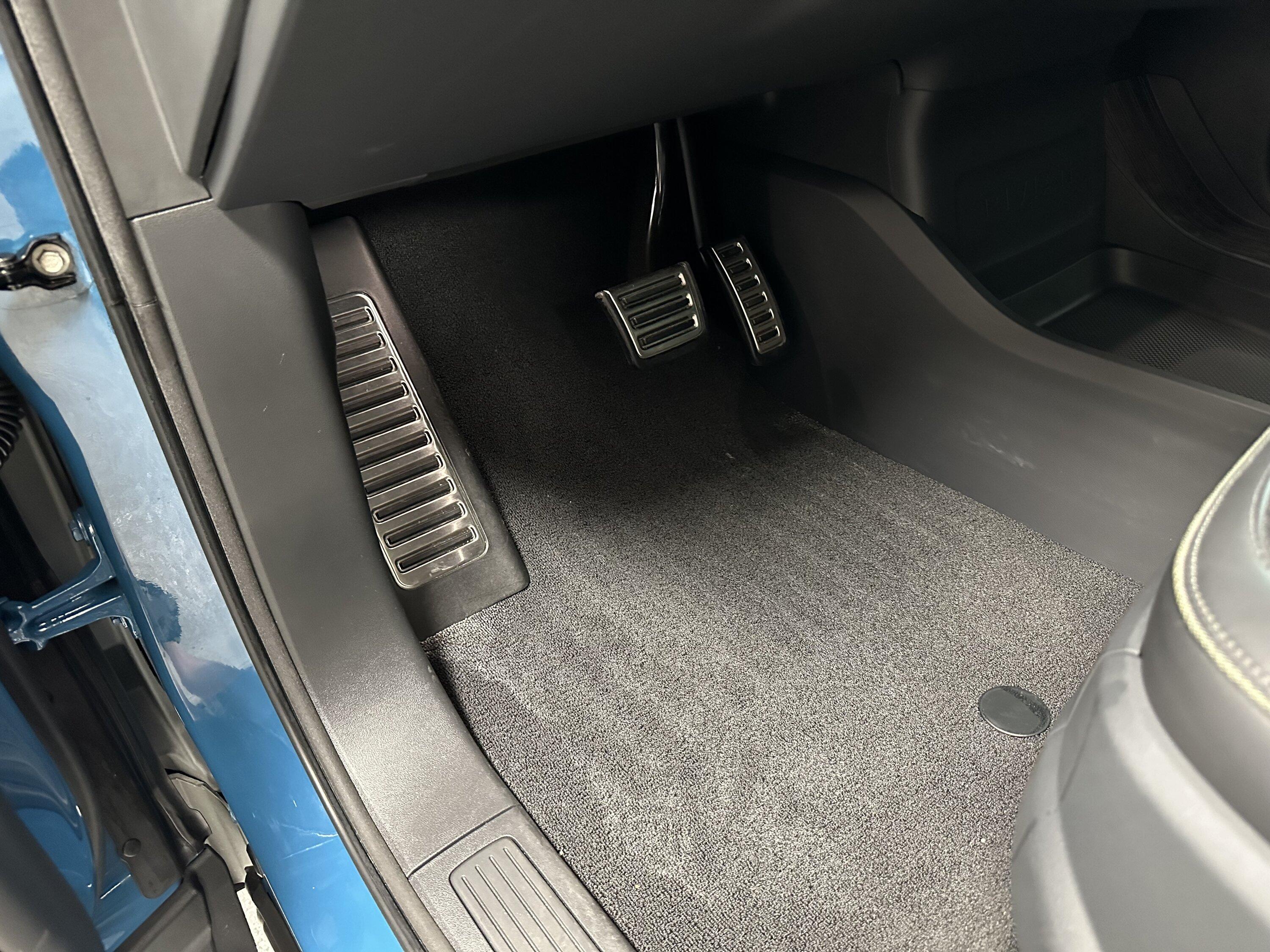

Add me to the list ?. Entire driver floorboard soaking wet up to behind the pedals where you can see a white line ??‍♂
A musty smell has also developed. My wife drives it and we have all weather mats so neither of us noticed. Service request submitted to Rivian.
