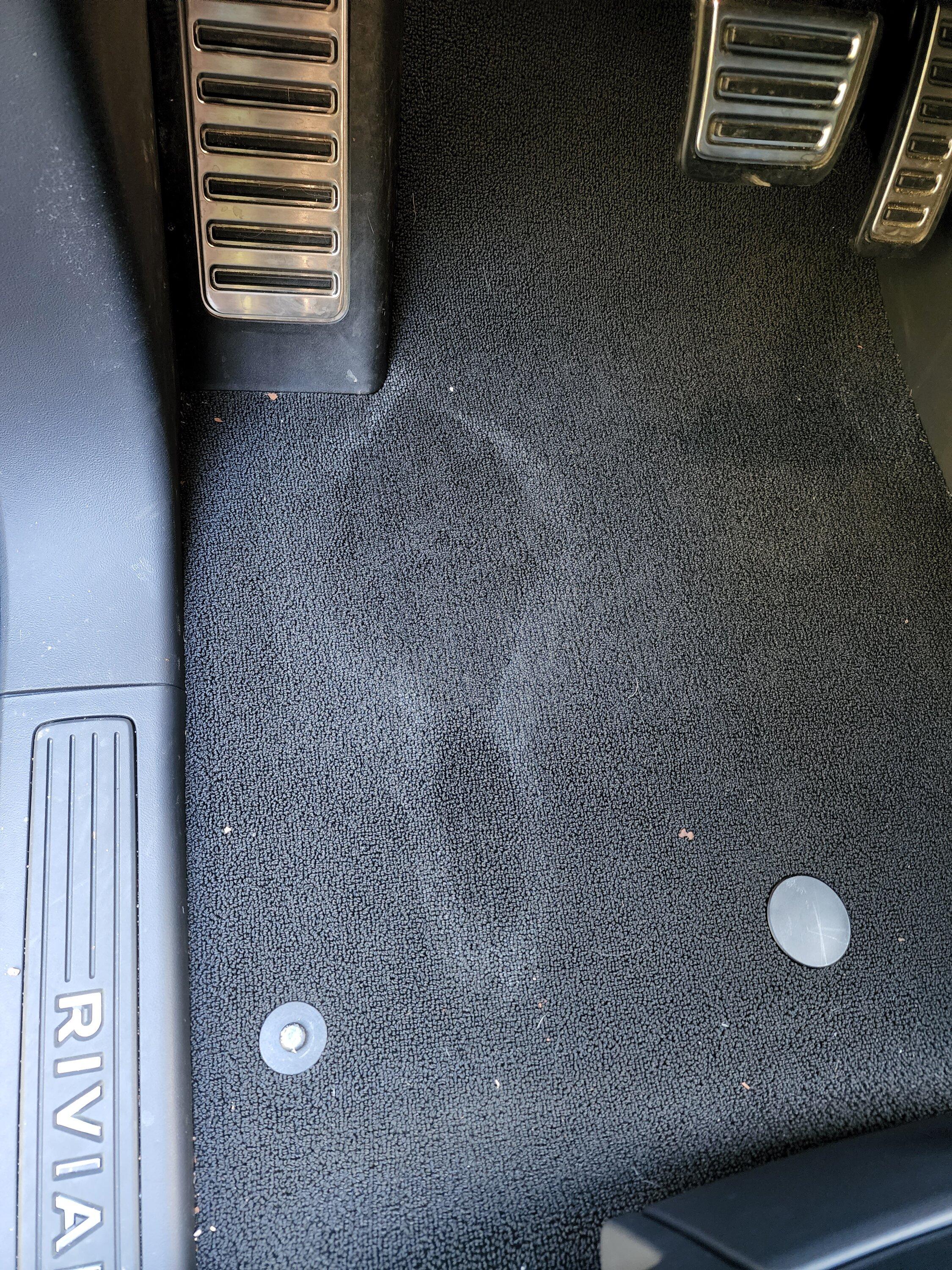

@NSRoamer there is a hole near the driver’s door where is generally drains although sometimes it drains near the passenger side. Yes an annual replacement is very concerning but what concerns me more is that it seems to occur in gen 1 & gen 2. Let me know if you get more insight
Good thing I had the windshield replaced with OEM at the SC. Turns out the Fuyao windshield (last owner) was very poorly installed (probably by Safelite). Fuyao supposedly makes the OEM windshield.
The loaner had the dreaded condensate leak - figured I'd check the T when I picked it up - it also has the leak. I talked with one of the senior technicians at Gaithersburg SC - he explained the condensate drain situation. Because the vehicles are made to wade in 30 - 36 inches of water, they can't use a standard gravity drain - that would let water back into the evap coil housing. Rivian designed some complicated drain system that keeps water from coming back in. This for the (probably) relatively few people who will actually take their vehicle through that much water.
He did say there are drains on both sides (just confirmed - also a hole near the passenger door). Some of the leaks seem to be caused by poor / faulty installation, some caused by a crack in the HVAC housing. Seems like cracks in the HVAC housing are a a design / engineering / production problem that could be fixed. The service advisor I was working with said their SC has not had any AC leak comebacks.

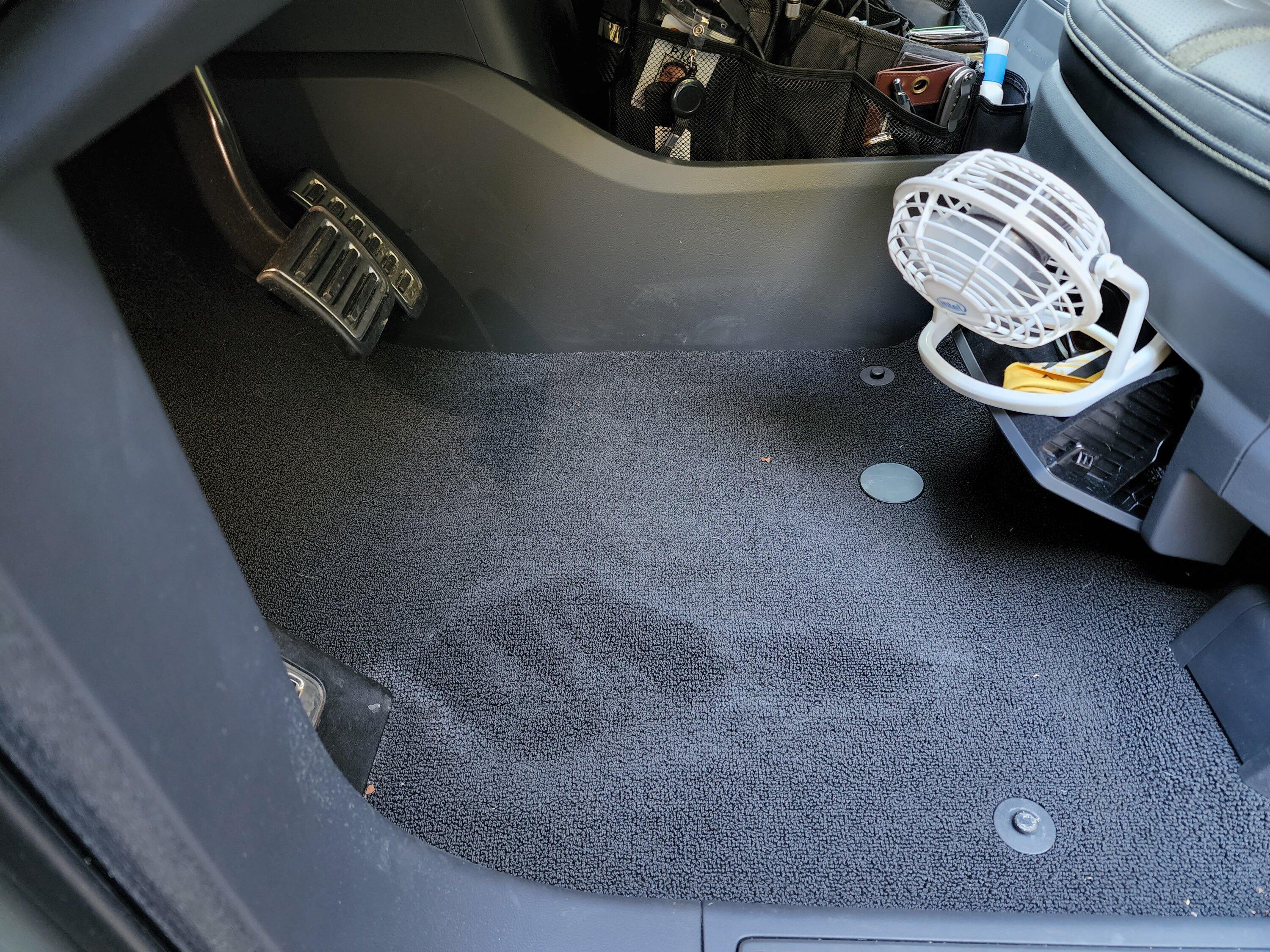

I didn't see any record of the "drain valve" being replaced on the T. I have a trip coming up - will revisit the HVAC leak after I get back. In the meantime, I remove the rubber mat when parked and have a fan blowing on the carpet - 120v at home and will use a USB fan while on the road.
Now undergoing constant monitoring - there’s a chance the T had a windshield leak...
UPDATE: the T has the dreaded AC condensate leak. Instead of condensate draining out the left or right drain, it now drips from between the front and middle under body panels - sort of in the center. Hope that battery is well sealed!!

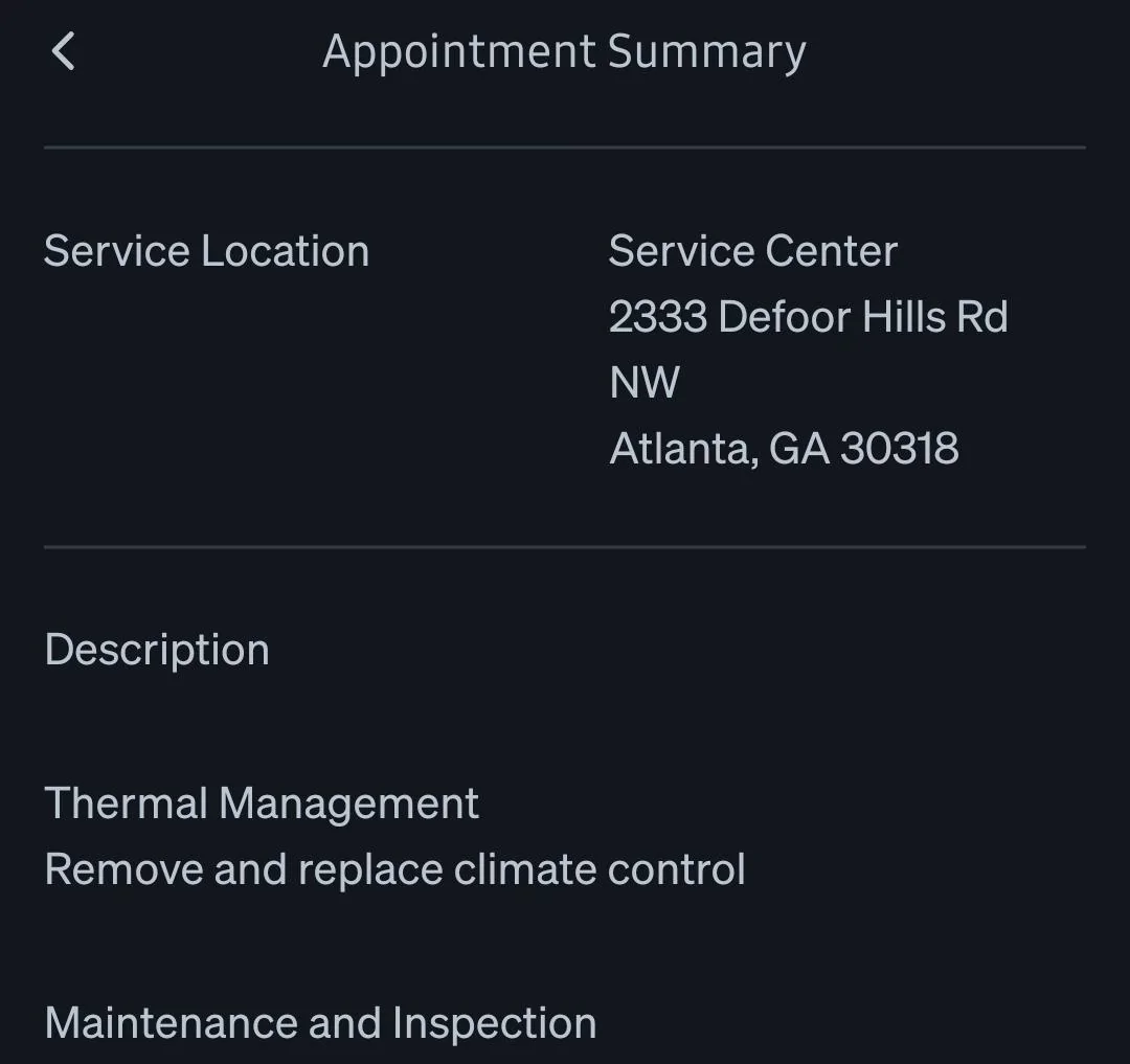

Feb 2023 R1T - second owner here. Add me to this long list of owners with wet carpets and replaced HVAC assemblies - but ONLY the HVAC assembly. The SC did not replace the carpets as the service advisor said they’d include in the service at drop-off. Thank you to everyone who has posted their invoice copies here in the forums. I’m attaching mine too.
Based upon what I’ve seen in other posts, sounds like I needed to share more incident information with the SC (potential associated issues that I’ve learned about here - ones I’ve experienced too) and the SCs should really learn to ask more questions to rule out other potential issues when any one or two of these issues are raised by owners. Along with the not replacing my driver and passenger carpets, they did NOT replace
- HVAC drain plug valves
- dash insulation
- cabin air filter (note I don’t “think” I’ve smelled any musty or mold-like - yet)
- refrigerant (how do you replace an HVAC component without losing some refrigerant?
- AXM module (infotainment system, driver assist, parking sensors, (and more?) more about potential AXM module issues down below too

When I picked up my truck two days ago I tried to use driver assist on a state “highway” on the way home and it didn’t work. It’s a “highway” with traffic lights but I believe I’ve used this feature on this section of road before. This road connects to a more significant divided, no-lights, higher speed state highway on my route home and it had full driver assist on that road. When I got home I saw they hadn’t replaced the front carpets as they initially said they would do. I also noticed both front carpets were still damp. And the carpet seems to be deformed and pulled out away from the firewall just to the left of the steering knuckle. I don’t recall seeing this before when cleaning the truck and if you push it in to the firewall, that seems to fit well in that position but it flexes back out. I think I need to look in the driver footwell of a couple other Rivians to understand which is the appropriate but it doesn’t seem right or wise to have carpet bulging out towards the drivers feet and the pedals, or coming close to the steering knuckle.
I’m thinking I’ll park my truck outside our garage with the floor mats pulled up and windows venting to let the carpet fully dry out. This should help me determine if the HVAC is still leaking or if it’s fixed (for now).
