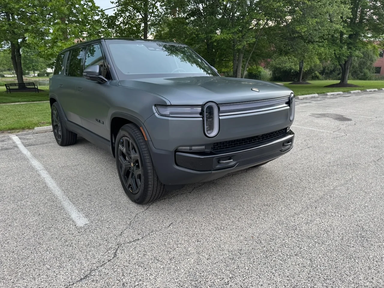

I did the front using the TWraps kit - headlights and light bar. I have the least amount of patience for this type of stuff and it wasn't hard.
I used the "light smoke" 70% light / 30% dark kit. IMO, I wanted something that blended in. Anything darker and it stands out. I had the same kit on my LA Silver T and it was even more noticeable. On my S w El Cap, I think it's subtle and what I was after.
Beautiful! I am pretty patient so good to hear you were satisfied. Mine is Storm Blue and I've also been wavering over 70/30 vs 50/50 and I think you nailed it!

Thx. 70/30 or clear would be my pick.
I had a few tiny bubbles (again, I’m impatient) but they all disappeared after a day in the sun.
IIRC there was also an 8mil / 10mil option. I found the 10mil easier to work with - more forgiving on moving around and squeegee.
