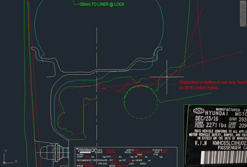

Whats crazy is they said here is a diagram showing how I am wrong and it would fit:
Rivian R1T R1S Help Me Decide EV Tires 1628797865440
Bottom of the diagram (Ioniq Hybrid) NOT Electric (FULL BEV). I had to point it out to them that there is a stark difference between the 2 platforms when it comes to the rear at least.
I guess they thought it was the same, I just gave them full testing mock setup for free.

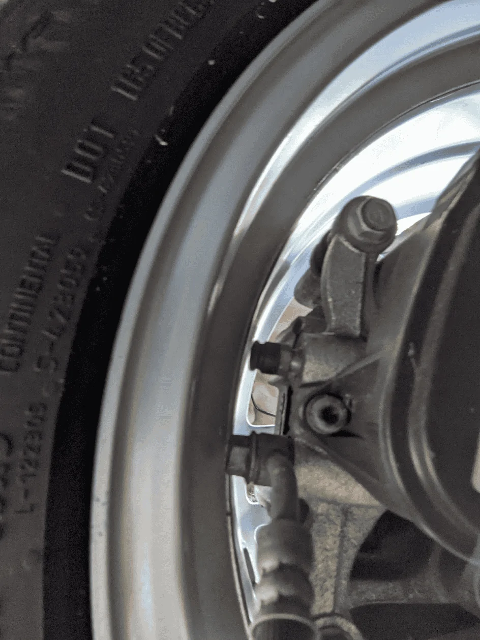

BTW Found the issue
Yep, backspacing & brake clearance issues are the two perpetual culprits. I put a big brake kit on my Jeep & have to tell the tire shop every time to not double stack weights...

Well the whole point of tirerack was a all in one solution at the price they charge, if I am starting to throw in spacers and other things Id just rather not. Fair point on the rest I was hoping the rotational mass would offset the NON LRR tires because I want HIGH Grip as the car will be our main daily until our R1S comes (hopefully by Nov 2022) so I want tires I can literally count on for grip in all types of weather.
BTW Found the issue:
That's too bad and I bet very frustrating for you. Spacers are easy to add but looking at the picture it does not look like spacers will solve the problem. Sorry you have to deal with this!
Really I bought from tirerack because they are a turnkey solution as they charge for it, when it stops becoming a turnkey solution and I have to modify this and that, I am totally over it and not worth the cost/time haha. Yea total bummer, ill just get some LRR not as grippy all seasons and see how they do.

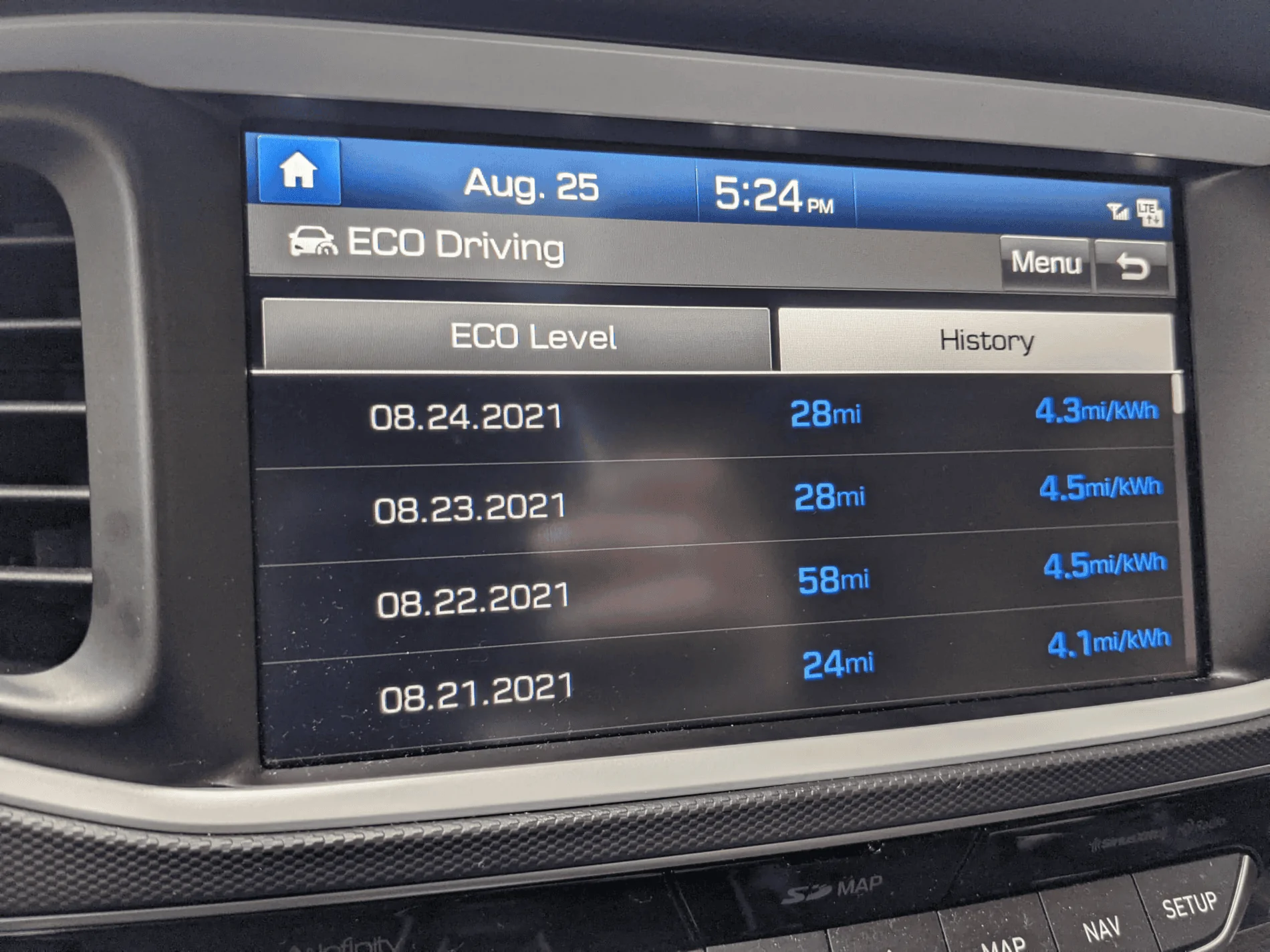

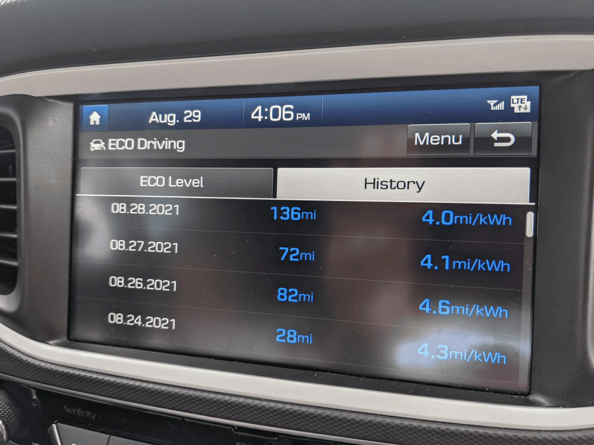

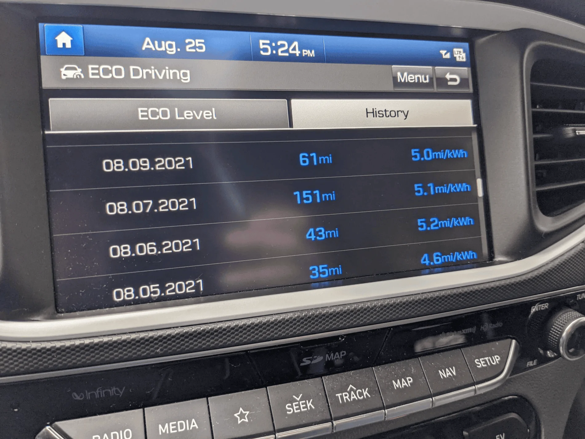

So about 1500+ Miles on the new tires and I have to report back about 10 to 15% reduction of range. Some variation probably due to temps and amount of HVAC used but even then its more noticeable on the highway vs city due to regen in heavier tires being recovered.
Highway Miles Before: 142 Miles (None to Minimal HVAC Use)
Highway Milles After: 112 (124 with out HVAC Use)
Some Before Range history data:

After New Tires:
Rivian R1T R1S Help Me Decide EV Tires 1631032218184
Rivian R1T R1S Help Me Decide EV Tires 1631032141102
