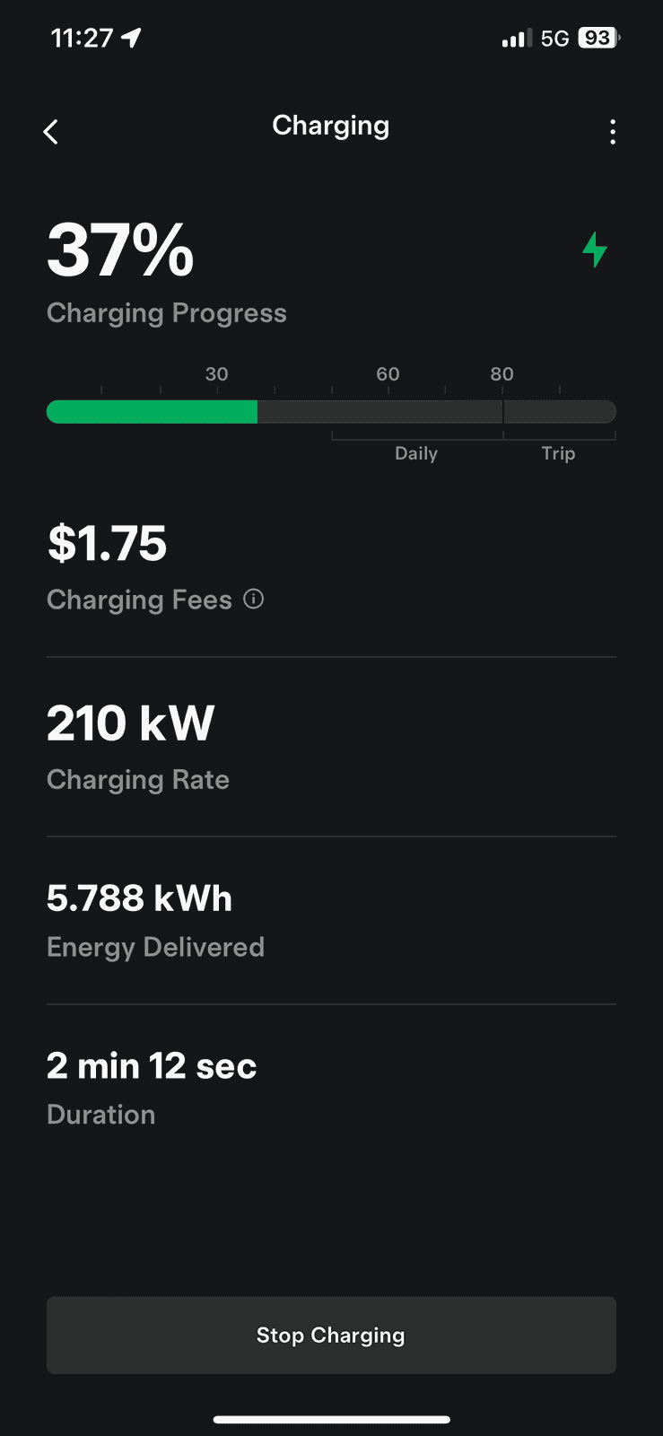

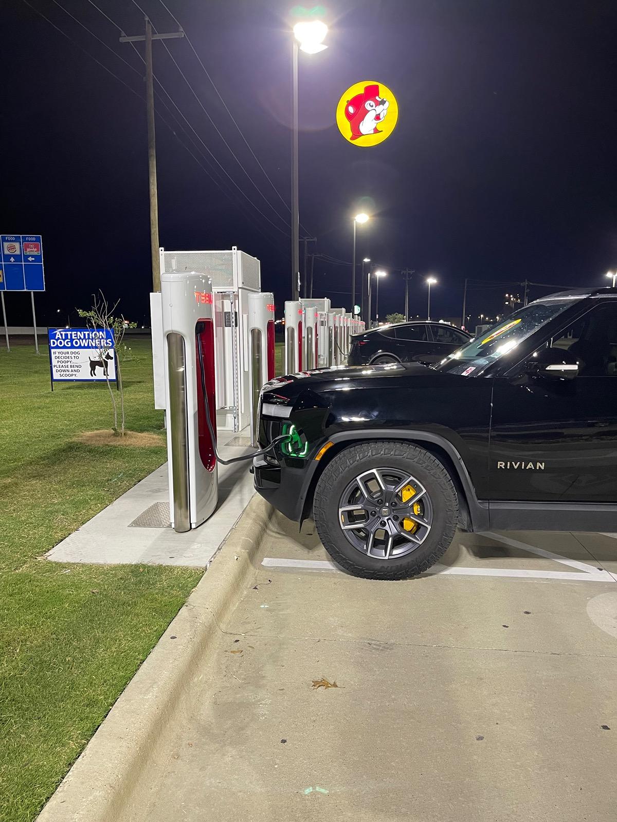

A2Z adapter working at full speed as designed.
Works great at Buc-ee’s
Saves me time and money when paired with Tesla membership pricing.
