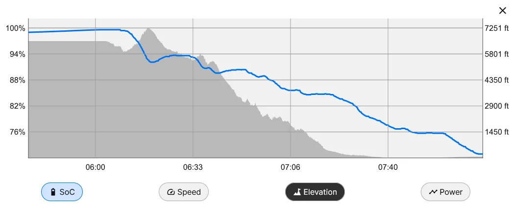

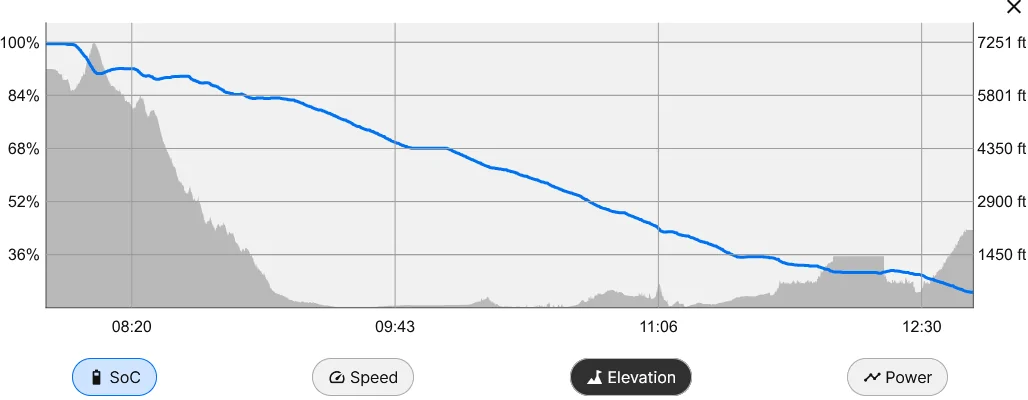

Oh sorry... yes: why the diff between first and second 1/2 of trip... Look at the Elevation change
Rivian R1T R1S Hitch Bike Rack's Effect on Vehicle Efficiency 1738252878967-x9
Rivian R1T R1S Hitch Bike Rack's Effect on Vehicle Efficiency 1738252922440-r1

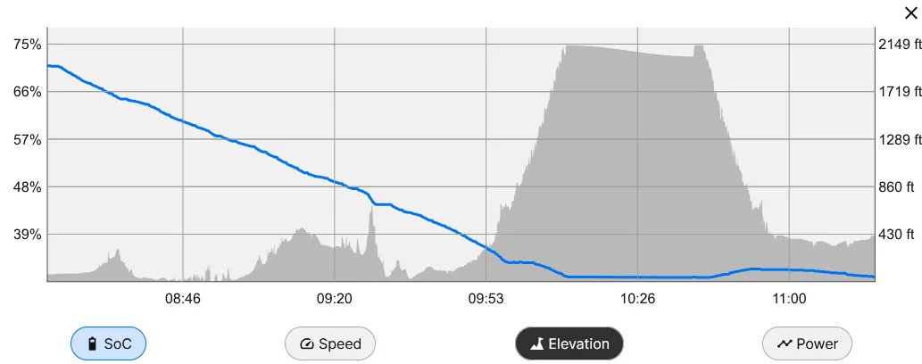

And here it is without stopping (good for scale):
Rivian R1T R1S Hitch Bike Rack's Effect on Vehicle Efficiency 1738253015150-fa
Yep, that explains it…….!
