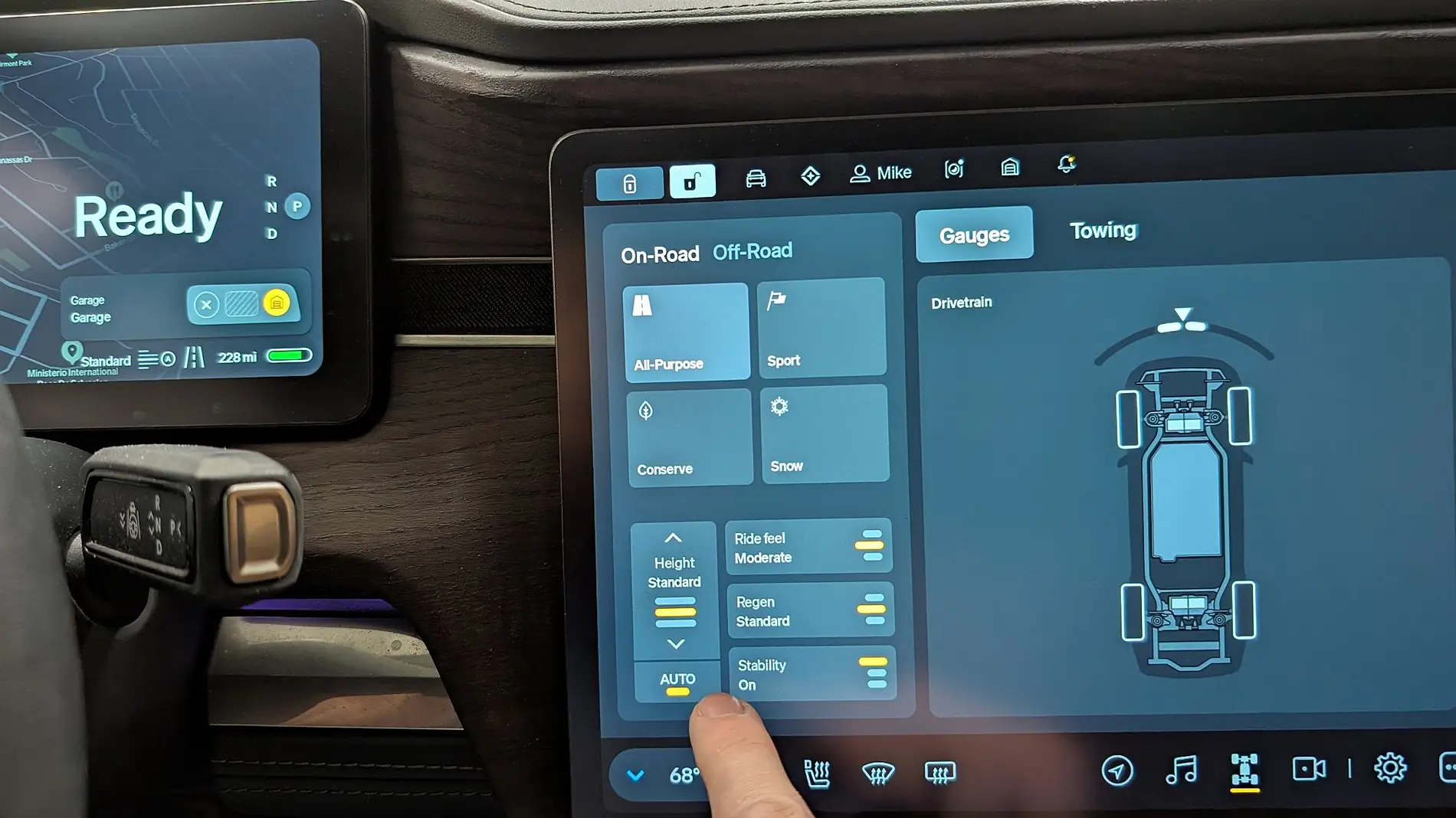

I toggled the 'Auto' ride height off and back on again:
Rivian R1T R1S Why can't we lower the vehicle when in park? 1779389365405-dm

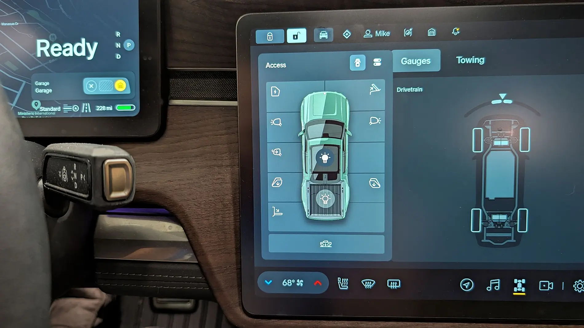

And just like that, the quick kneel button started working again. Button is white and clickable when parked. Open the door, button turns gray. Close the door, button turns white again. Able to lower when the tailgate is down, etc. Functioning as desired.
Rivian R1T R1S Why can't we lower the vehicle when in park? 1779389432861-96
Software defined vehicles. Huh. šŸ˜†
Edit: Just catching up on other comments. Is it because I had the camera view open? Good grief. 🤦
^^^ Appears this. Not gonna say anything else about this, but c'mon. How dumb. The camera view actually allows you to see what's around you better, and you'd think would be better for kneel. But what do I know? 🤣🤣
