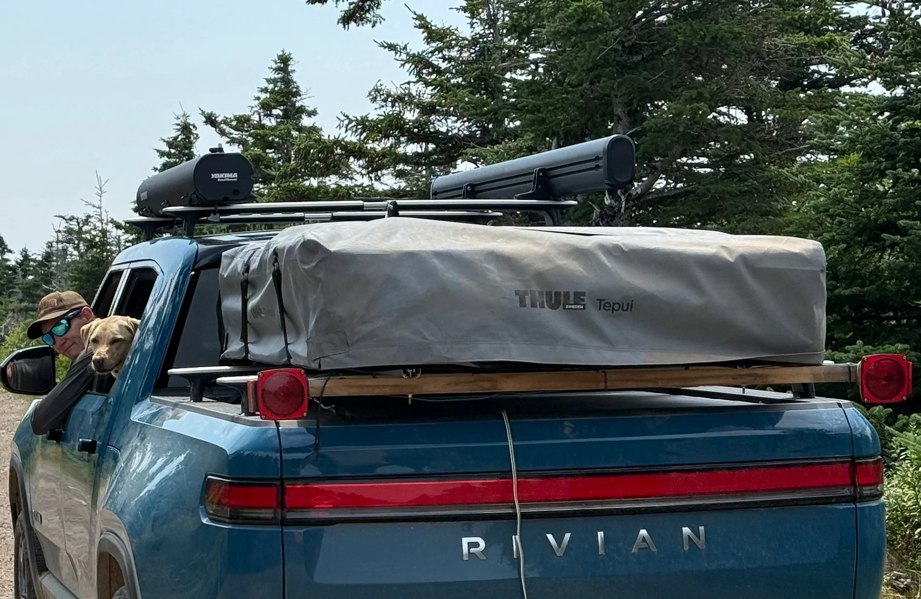

I tried three different LED brake/turn strip lights on my Gen 2. Had intermittent functionality. Rivian service told me many LED auxiliary lights have an incompatible electrical resistance. As a final try I bought a set of boat trailer lights. That is working fine. I mount it under my roof top tent when I have that on the truck.
Would you mind sharing the link of the boat trailer lights you got working?
