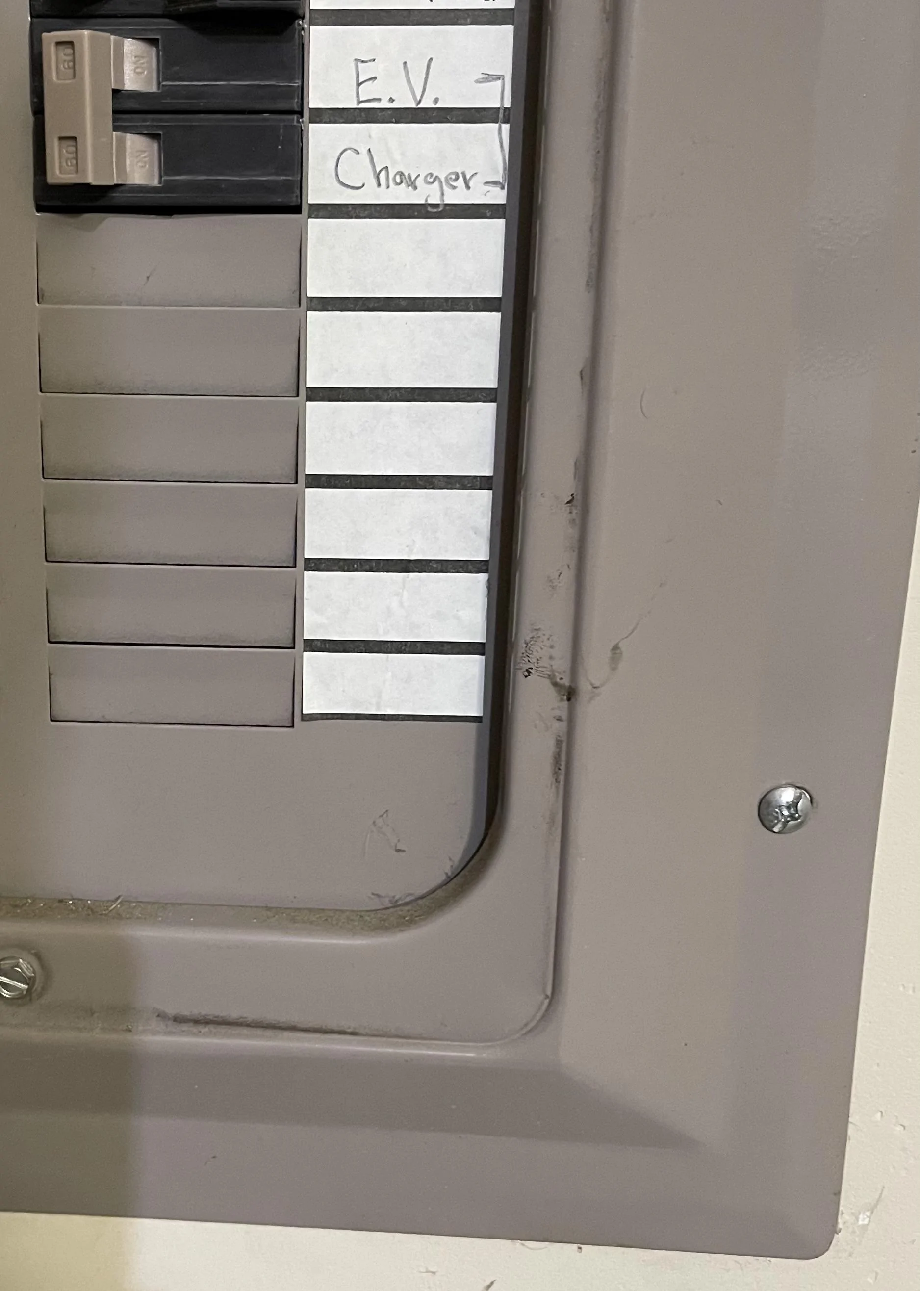

When you hardwire an item, it’s hardwired direct with no break in connection.
Each point has a weakness and introduces resistance.
I can claim all my 120v outlets in my house are hardwired just like your 240v NEMA plug.
when I use a lamp or computer I plug into the outlet, doesn’t mean it’s hardwired. It’s just plugged into a socket. There is a weak link that’s been introduced now and I haven't directly wired my lamp into the breaker.
Again, hardwire means direct connection between the unit and breaker. No other points in the middle.
I you do that using the right cables and breaker. You can pull 48 AMP max continuously from a 60 amp breaker if you make a DIRECT CONNECTION to a capable charger like Rivian.
Everything else will introduce resistance and a weak point that will slow down your charging speed.
It’s just basic science and math.
This is what we mean by hardwired. No outlets in sight. ā€œJuneā€ and I don’t like any weakness.
Sorry-my aging eyes-is that a 60 or an 80 on the breaker??
