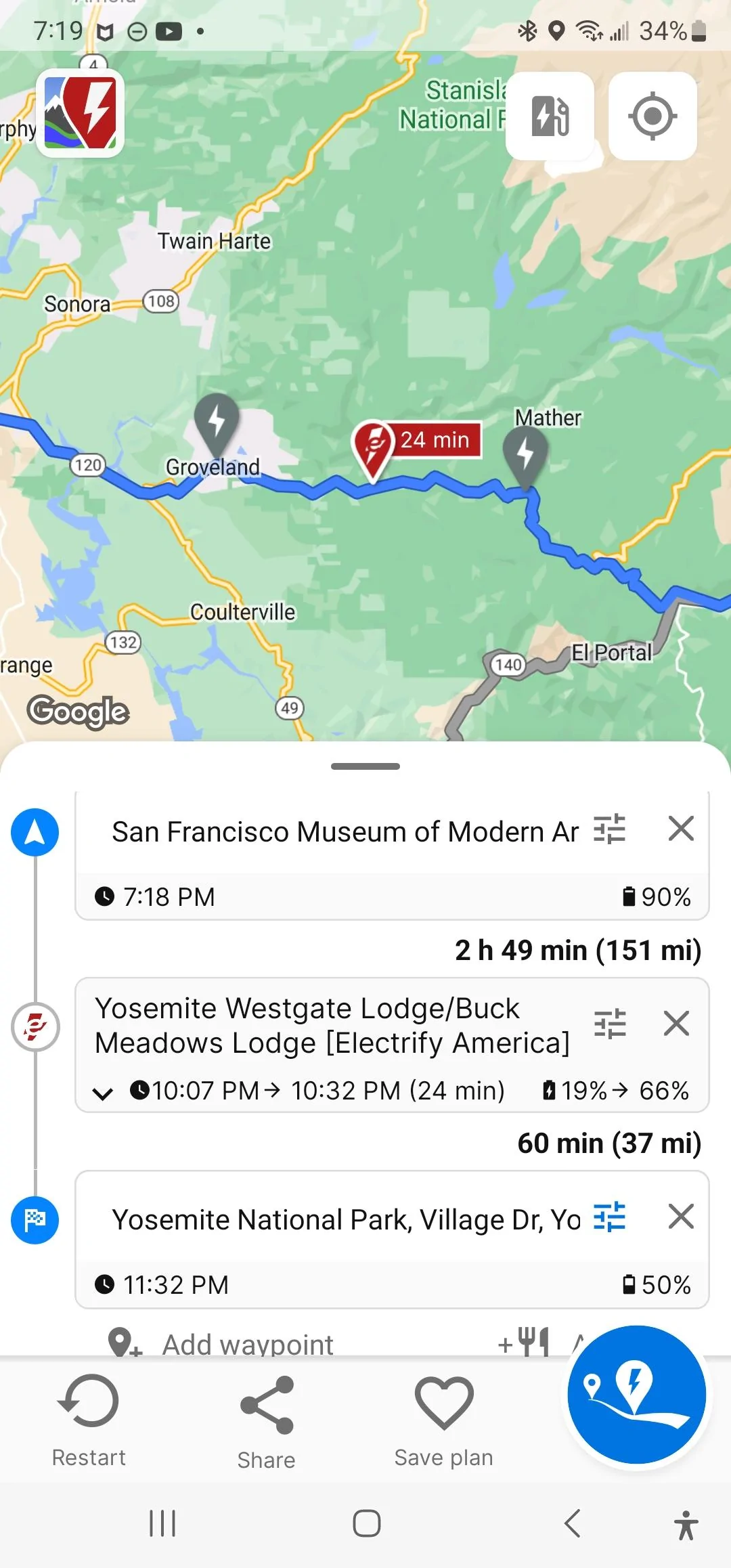

I don't have an ev yet (R1S pre-order), but am trying to learn also. I was playing around with the ABRP app and adjusted the soc at arrival to 50% (probably a good buffer). it has you stop once...
Rivian R1T R1S How to navigate to/from Yosemite from SFBayArea Screenshot_20230121_191920_ABRP

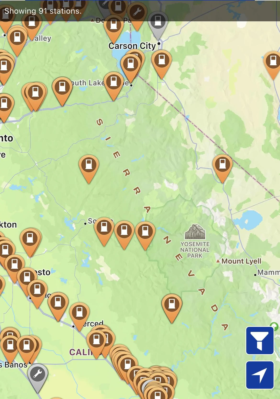

Okay, sorry for being late to this but I use PlugShare. I think most people that travel do this. With PlugShare I was able to navigate my son on a trip from Portland Oregon to salt lake… in a mini SE with only 95 usable miles in winter.
in PlugShare I see 2 places for EA (West and SW) with 350 Kw
But there are others with up to 62 Kw
