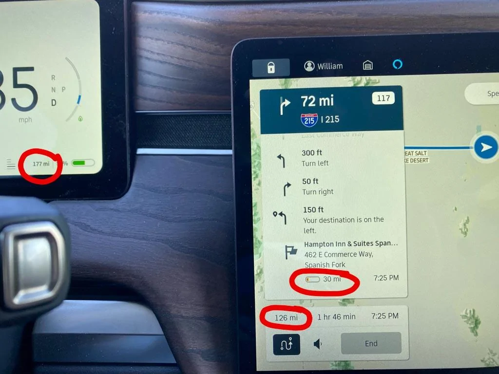

It seems that the left screen doesn't know what the right screen is doing:
Rivian R1T R1S Inconsistent range estimates IMG_6242
The left screen claims that we have 177 miles left. But the right screen says we'll end our trip in 126 miles with 30 miles left, implying a total of only 156 left at the current time. I'm *guessing* that the left number is just the battery SOC times some average efficiency while the right numbers reflect more knowledge of the remaining route and is likely more accurate. Of course, as we near the end of the trip the two numbers converge. Why not use the better knowledge of the trip computer for the left display?
This is just one example, I've seen the same behavior many times.

I don't recall ever seeing a difference that big, but also probably never paid much attention. I do know I almost always arrive with more than it estimated. Would much rather err on that side of it. Have you noticed if both numbers update if you change drive modes? If you were in Conserve and the left was showing 177, the nav might be calculating it in All Purpose? Still shouldn't be that much though. Now you gave me another thing to pay closer attention to.

Plan to be conservative in your estimations until this improves
