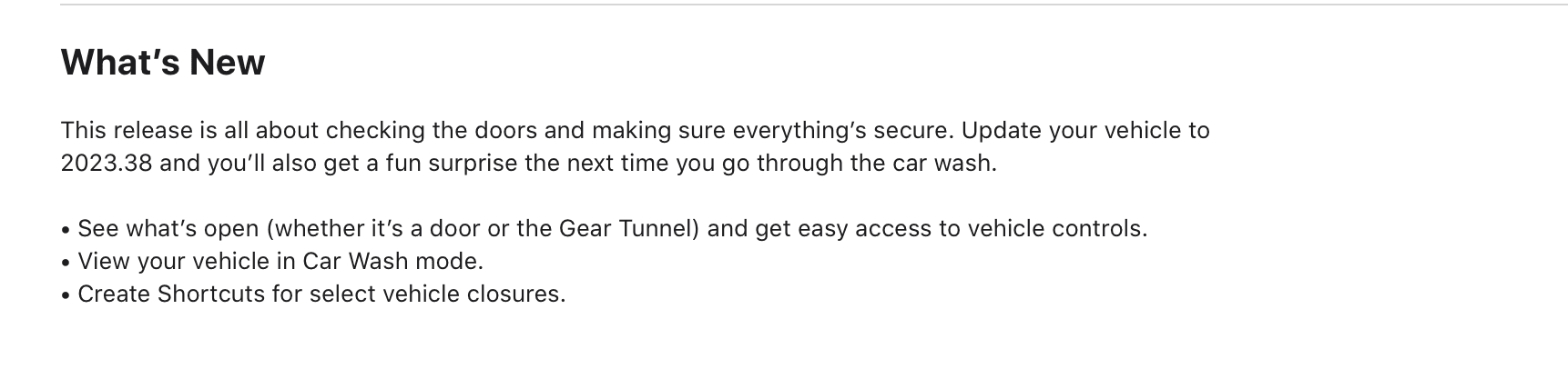

I updated but can't seem to add a shortcut/widget. How did you do that?
Curious about the car wash mode stuff
You have to go to All Shortcuts then hit the + to add a new one. Search for Rivian to find the actions. For some reason they don't just show up in the list like other apps. I was able to get the open/close hood and lock/unlock doors to work from my watch, which was nice. Though every time I trigger them it shows an error, but they do work. You can also toggle the mode that makes it so you have to have the device unlocked for it to work.
