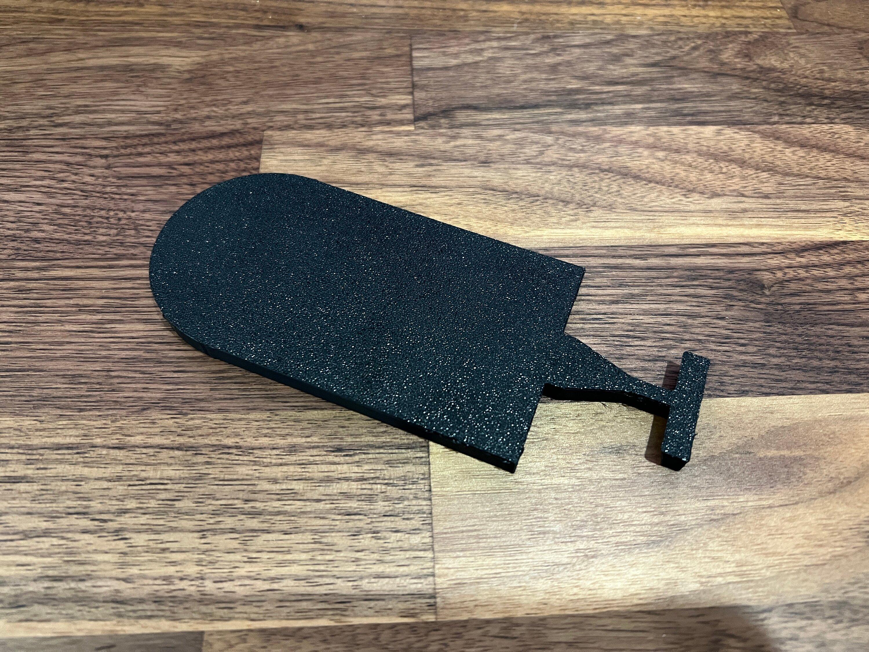

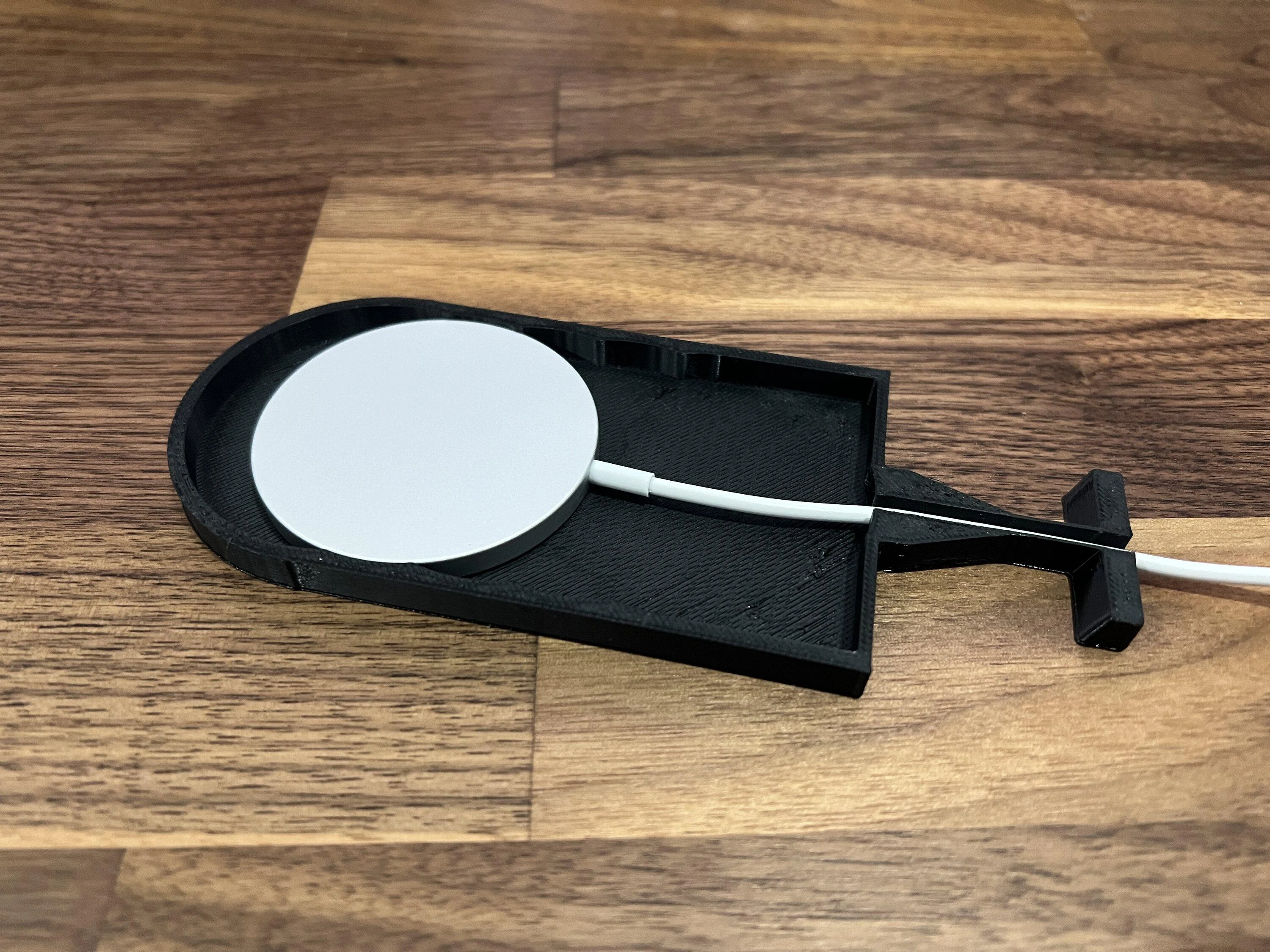

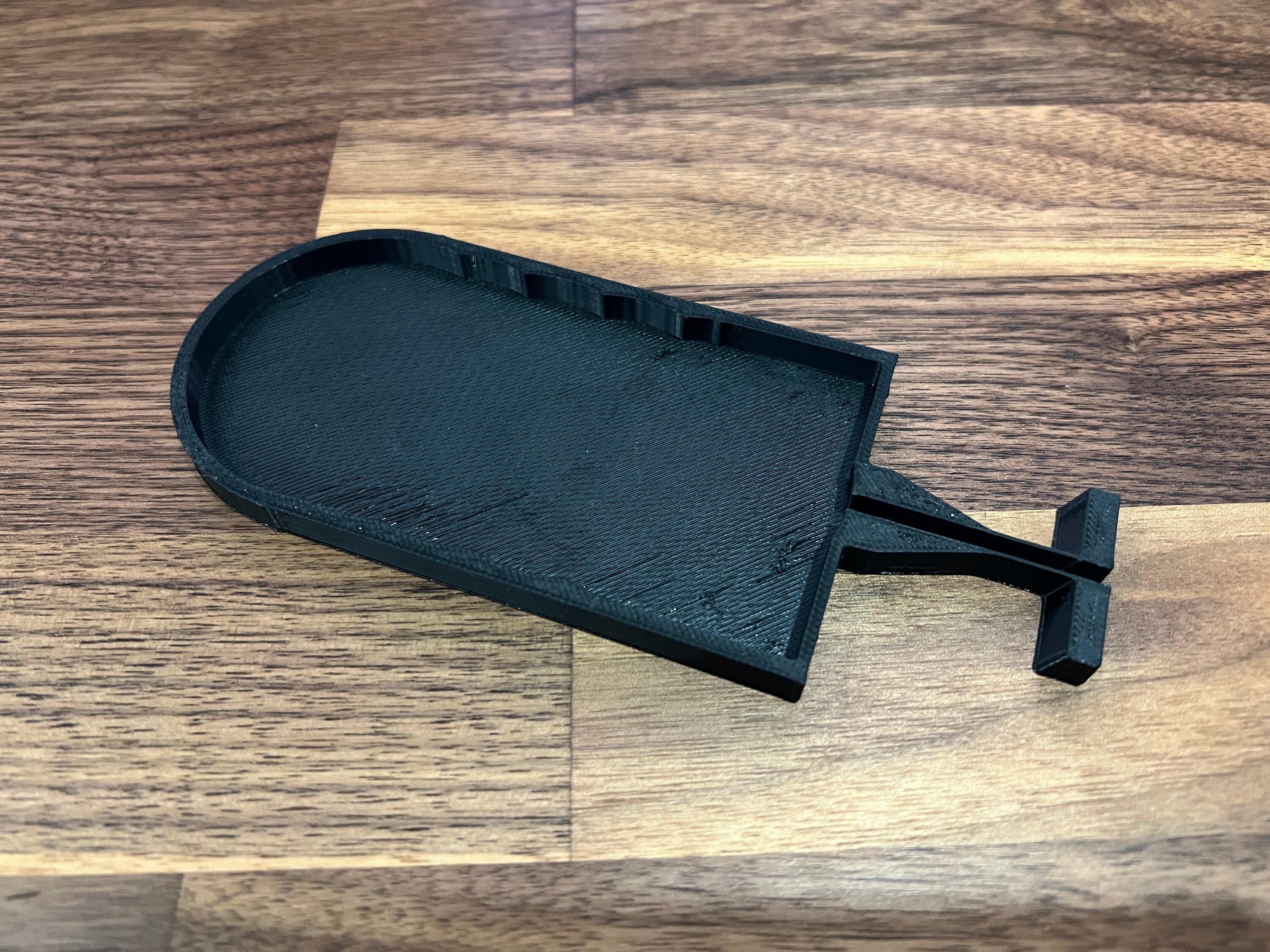

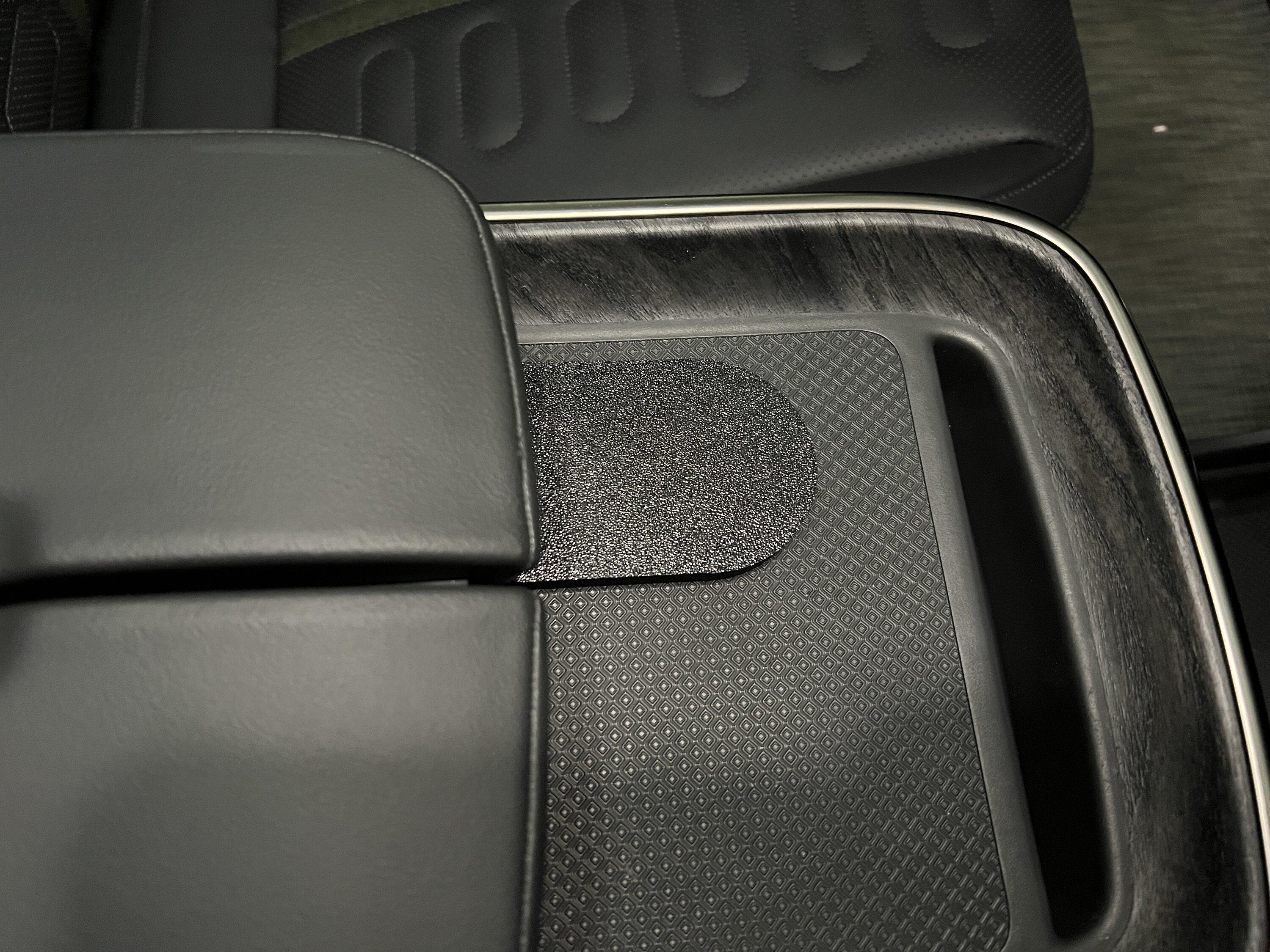

So, here is what I put together:

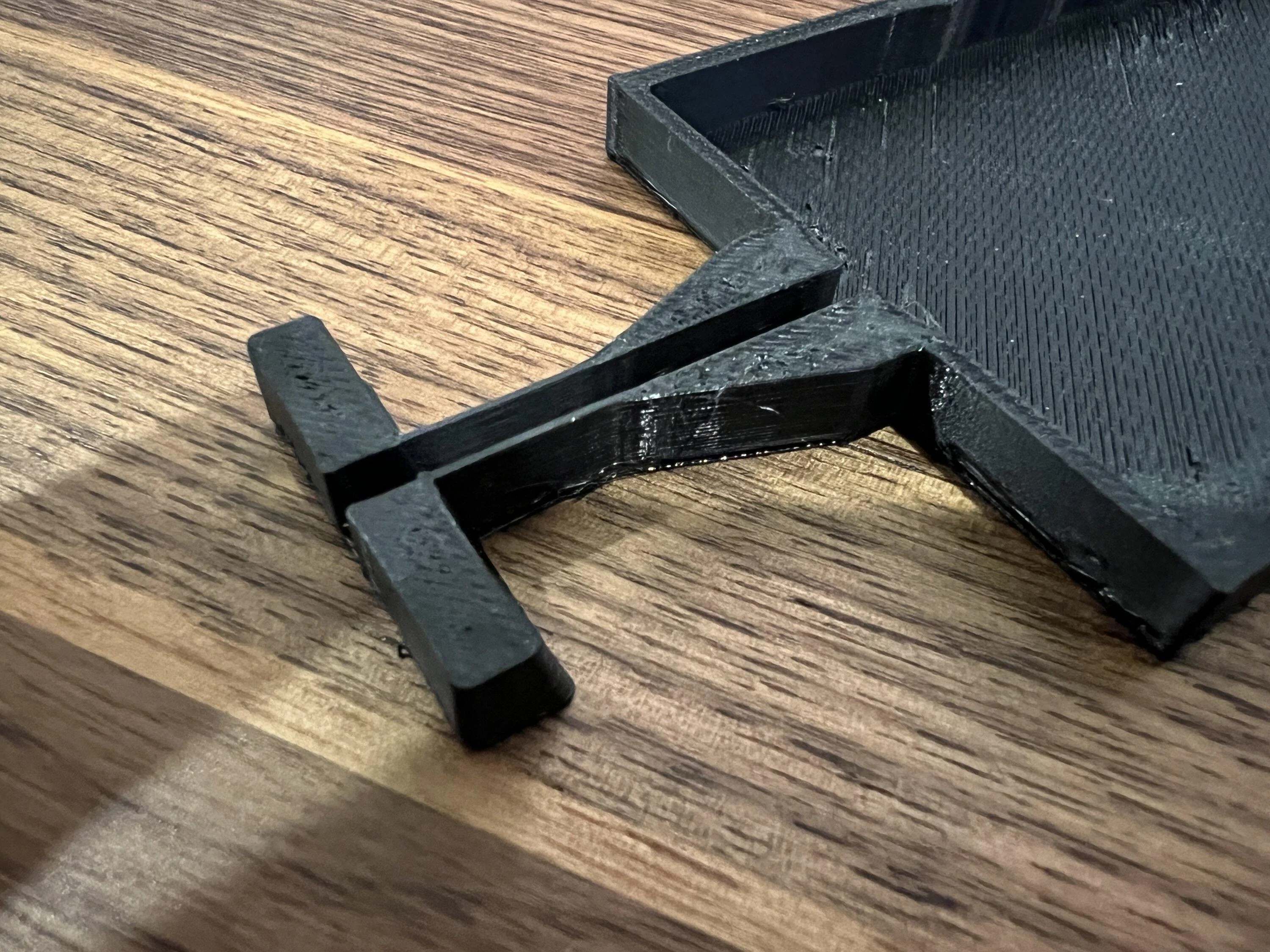

It's very similar to what was shown above - a tombstone shaped plastic bit that sits on top of the rubber mat. It's held in place by a T shaped extension that goes into the center console. The
Rivian R1T R1S iPhone 14 Pro is not compatible with the Rivian Charge Pad IMG_0863.JPG

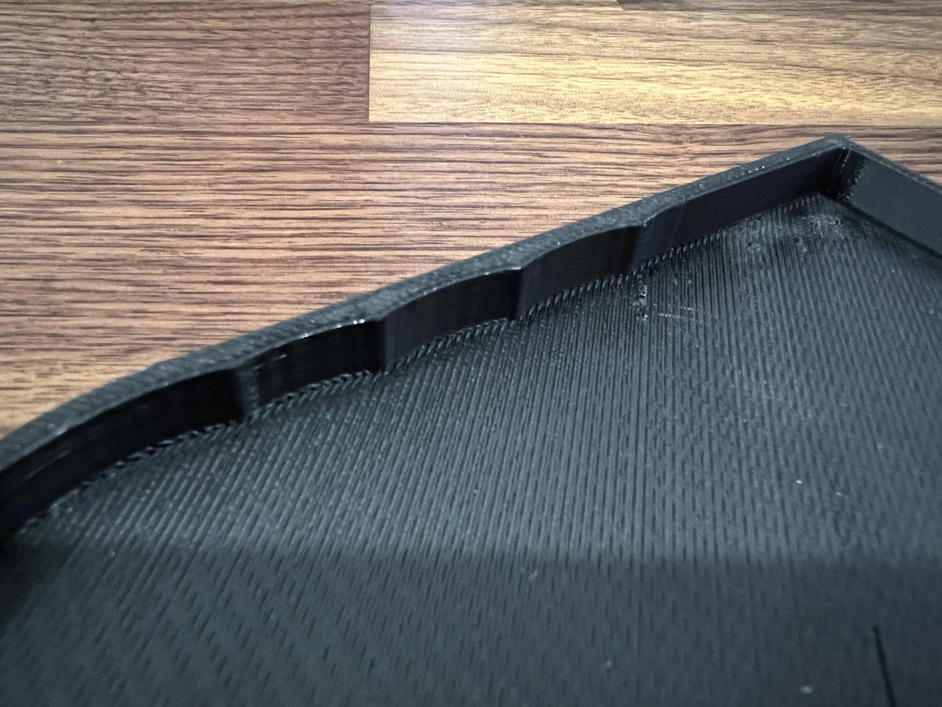

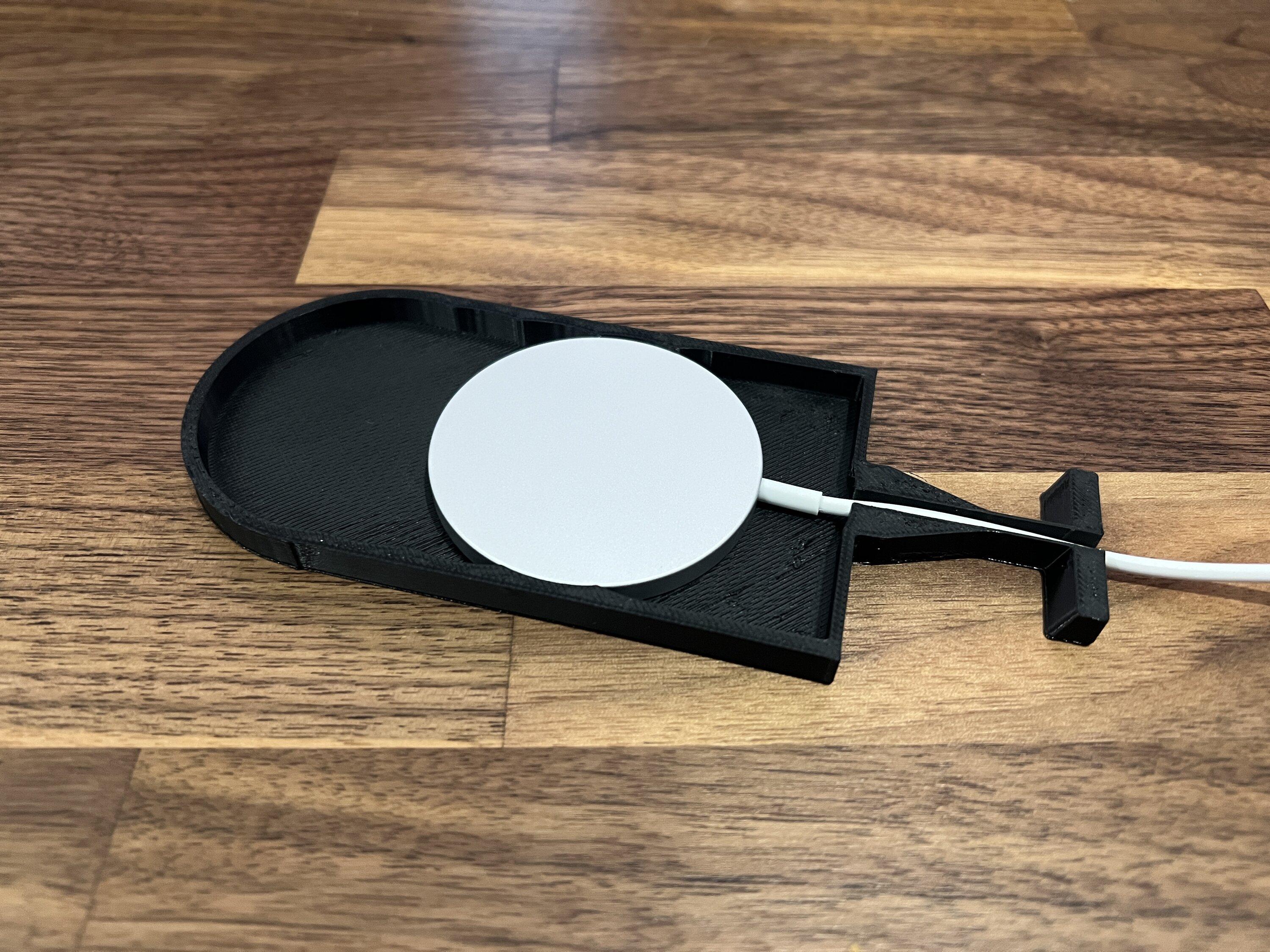

Underneath is where it is likely different. It has little indentations where you can move the OEM Magsafe connector forward or backward to best suit the size iPhone that you have and the case that you are currently using.
Rivian R1T R1S iPhone 14 Pro is not compatible with the Rivian Charge Pad IMG_0864.JPG
Rivian R1T R1S iPhone 14 Pro is not compatible with the Rivian Charge Pad IMG_0867

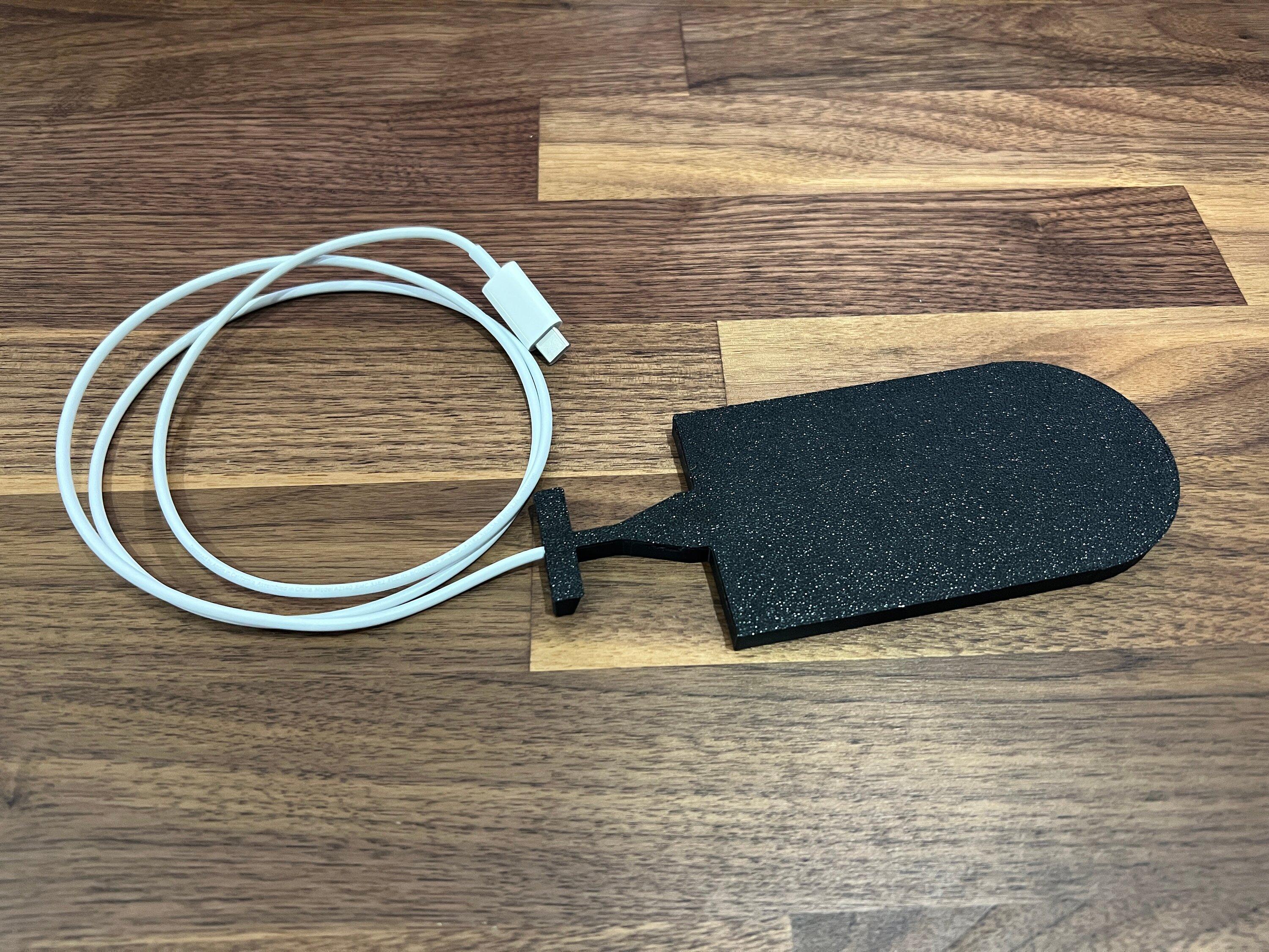

The cover thickness is basically as thin as I can make it while ensuring the whole bit is structurally sound. The pad holder is shown upside down in the pictures below, with the cover on the bottom.
Rivian R1T R1S iPhone 14 Pro is not compatible with the Rivian Charge Pad IMG_0865
Rivian R1T R1S iPhone 14 Pro is not compatible with the Rivian Charge Pad IMG_0866.JPG
There is a channel leading from where the the cabling coming out of the MagSafe charger wedges into. It can then be plugged into the USB-C port in the center console.
Rivian R1T R1S iPhone 14 Pro is not compatible with the Rivian Charge Pad IMG_0868
Rivian R1T R1S iPhone 14 Pro is not compatible with the Rivian Charge Pad IMG_0869.JPG

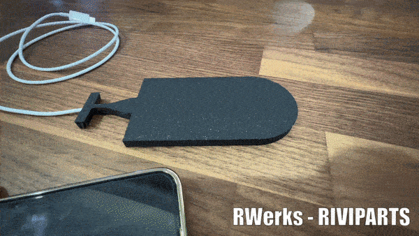

It holds well:
Rivian R1T R1S iPhone 14 Pro is not compatible with the Rivian Charge Pad ezgif.com-gif-maker (1)

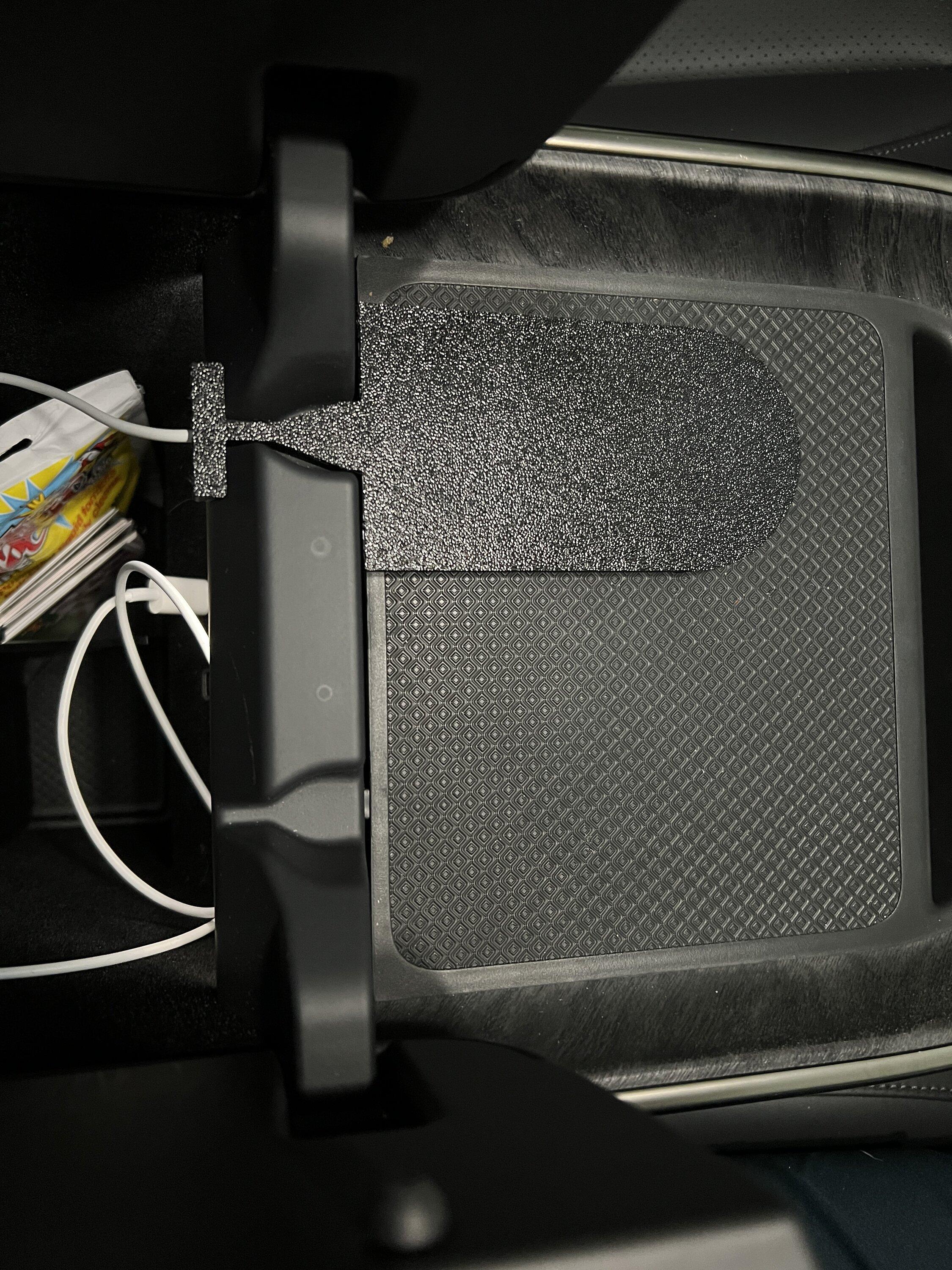

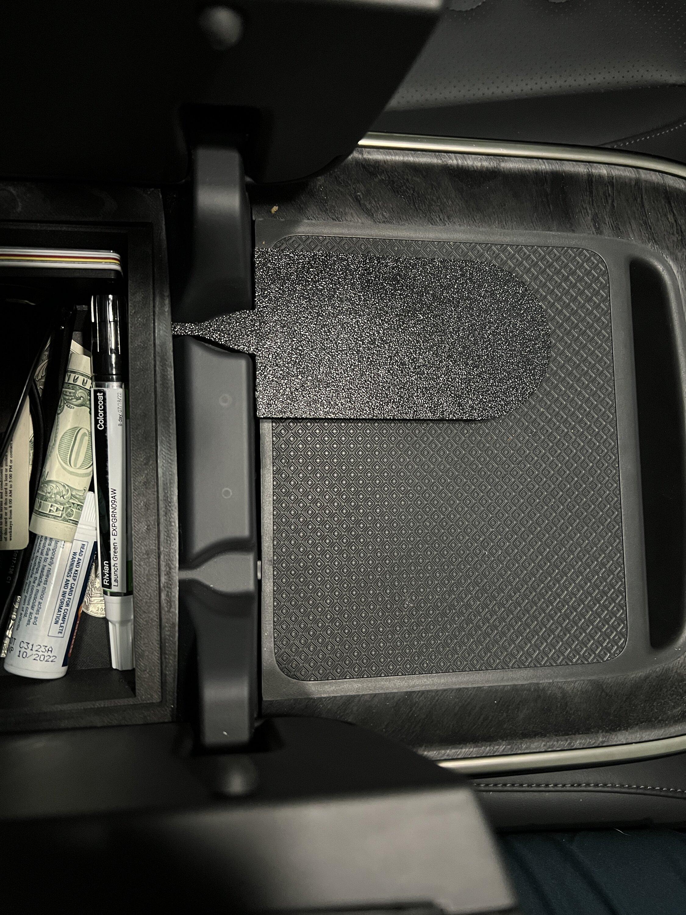

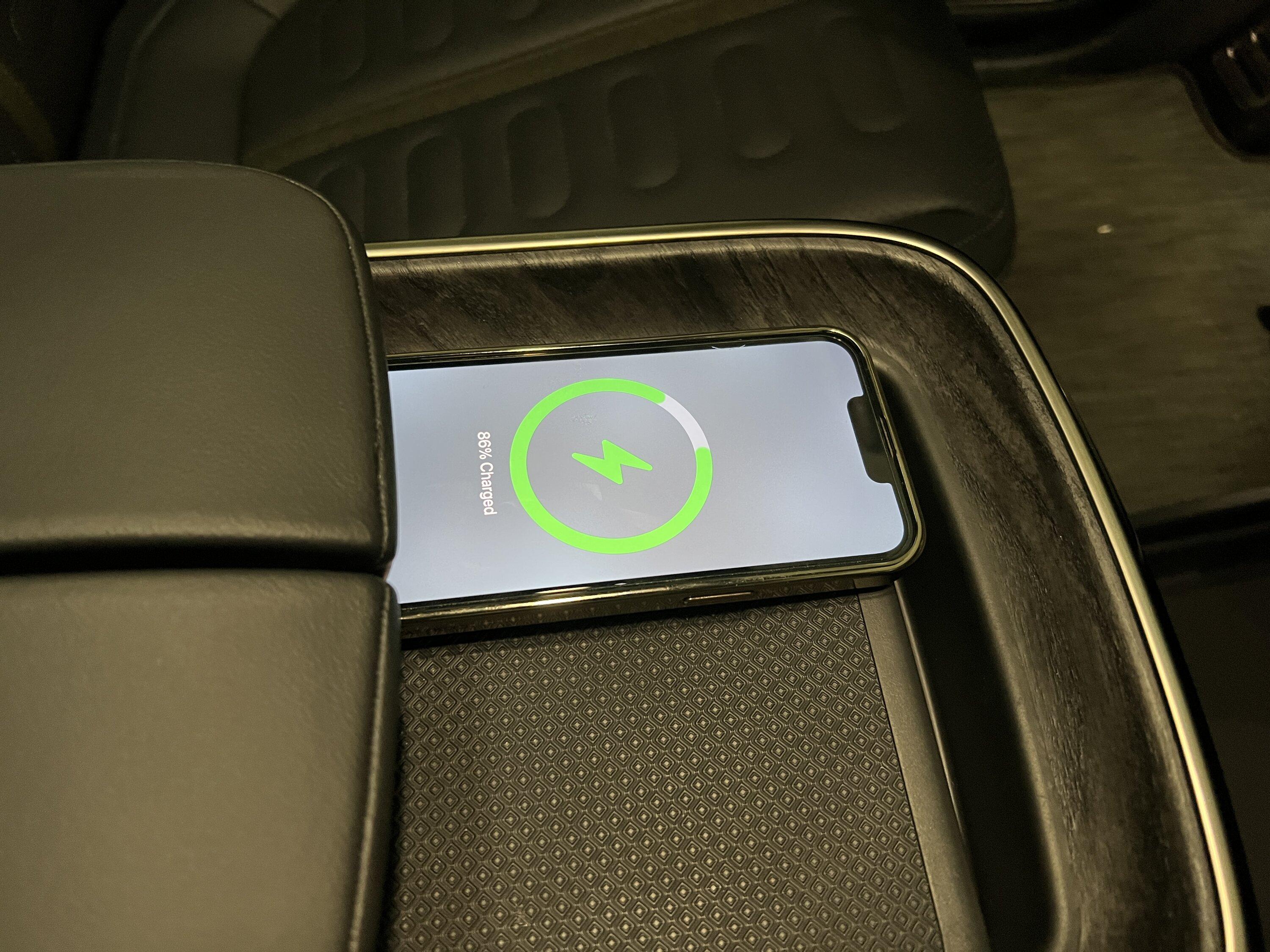

Here is what it looks like installed. Note that it works fine with the Sliding Console Organizer - I don't know if it will work with other ones. I'd suspect not. I've tried to make it as thin as possible, so there is a very slight downhill grade toward the front of the vehicle.
Rivian R1T R1S iPhone 14 Pro is not compatible with the Rivian Charge Pad IMG_0873.JPG
Rivian R1T R1S iPhone 14 Pro is not compatible with the Rivian Charge Pad IMG_0876.JPG
Rivian R1T R1S iPhone 14 Pro is not compatible with the Rivian Charge Pad IMG_0877.JPG
Rivian R1T R1S iPhone 14 Pro is not compatible with the Rivian Charge Pad IMG_0878.JPG
So, where do we go from here?
I've posted the STL file on Thingiverse here if anyone wants to print it or remix it. At this point, I don't plan on using it, enhancing the design or selling them like I have with other items that I've designed. For me, I put stuff on the self pretty frequently, and the under mat magnetic charger works really, really well. Different strokes for different folks, I guess.

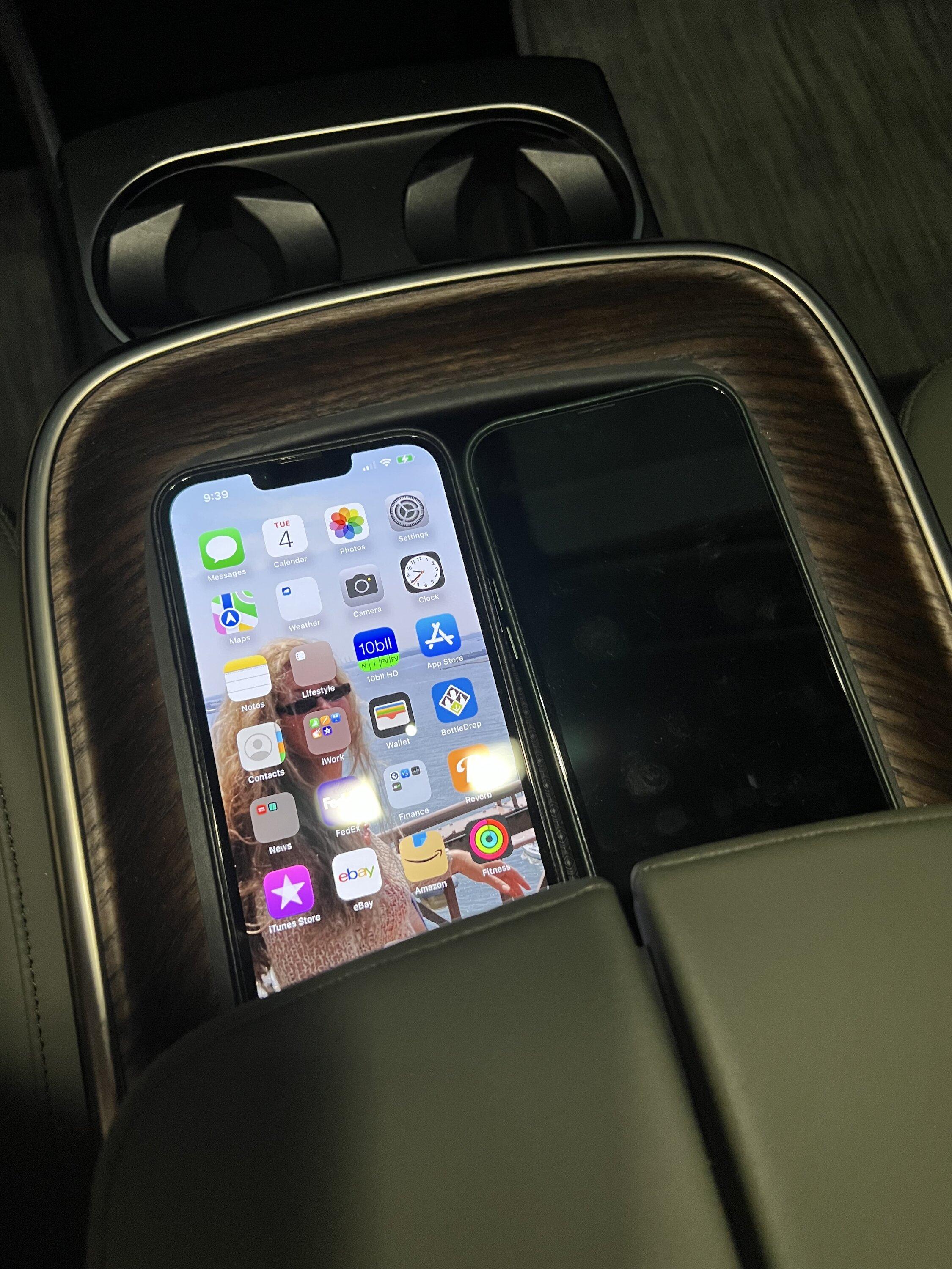

Had the same experience with my new iPhone 14 Pro with Apple Leather case not working at all.
Went with this as the simple solution, two Apple Magsafe Chargers and Gorilla Mounting Putty. Phones stay put and charges faster than the pad. Putty lets me easily lift the phone up without the puck if that wasn't obvious. I unplugged the Rivian pad for... safety??
I just used your putty idea and it is fantastic! Will post a pic later, but it was exactly what I needed to complete my setup.
Thanks and great thinking!

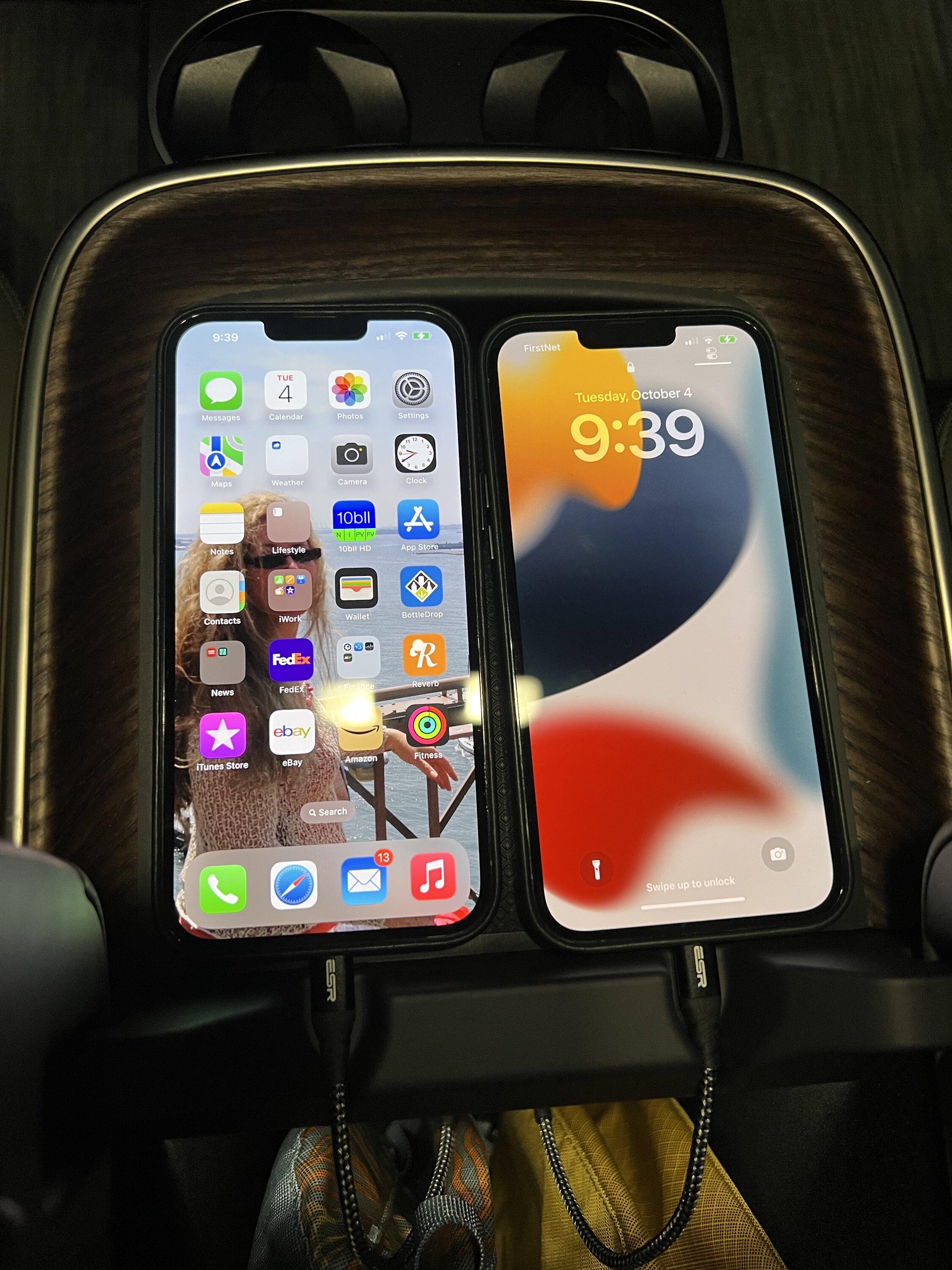

The “bump” on the new iPhone camera now keeps the phone too far away from the charging mat to take a charge. The charge mat (which was persnickety to begin with) is not of no use…
Reposting this from another thread...
I understand the frustration, and decided to go another route.
I found these awesome USB-C to Lightning cables on Amazon...
USB-C to Lightning Cable - 0.5ft (0.2m)
These are stiff enough to stay put and out of the way for your center console storage. They are also short enough to keep your phone(s) tethered and not have them fly all over on rough terrain.
Rivian R1T R1S iPhone 14 Pro is not compatible with the Rivian Charge Pad img_0572-jpe
Rivian R1T R1S iPhone 14 Pro is not compatible with the Rivian Charge Pad img_0571-jpe
In my case my personal phone is on the left and my work "Bat Phone" is on the right. Yeah, Im kind of a big deal around here. But on trips the right side is reserved for the Wife unit.
If you need to pick up either phone, the cable disconnects without damage just by pulling on the phone with some light pressure. Yeah, I know, over time that may cause the cable to fail. But for now it works.
These work well for me. YMMV
