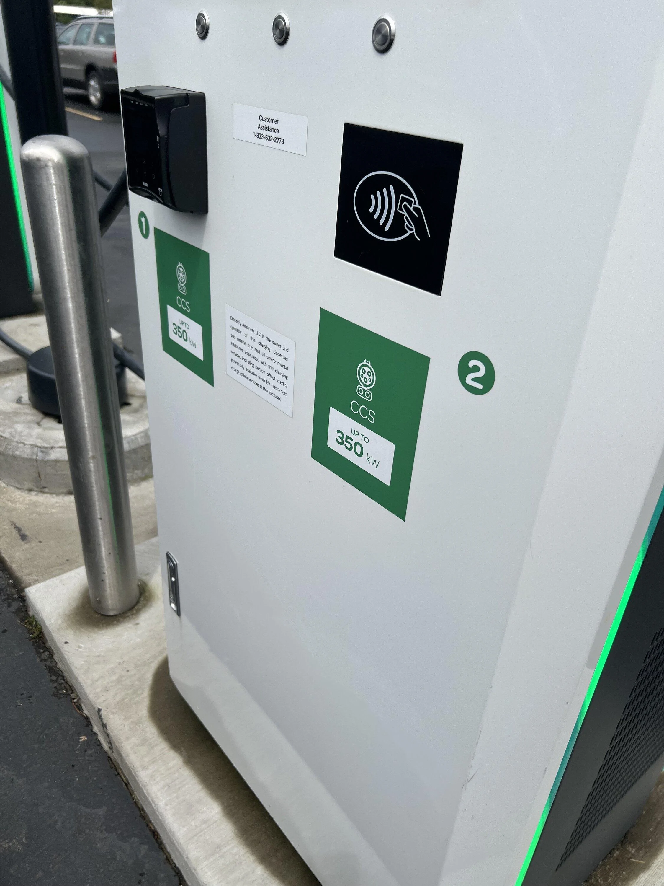

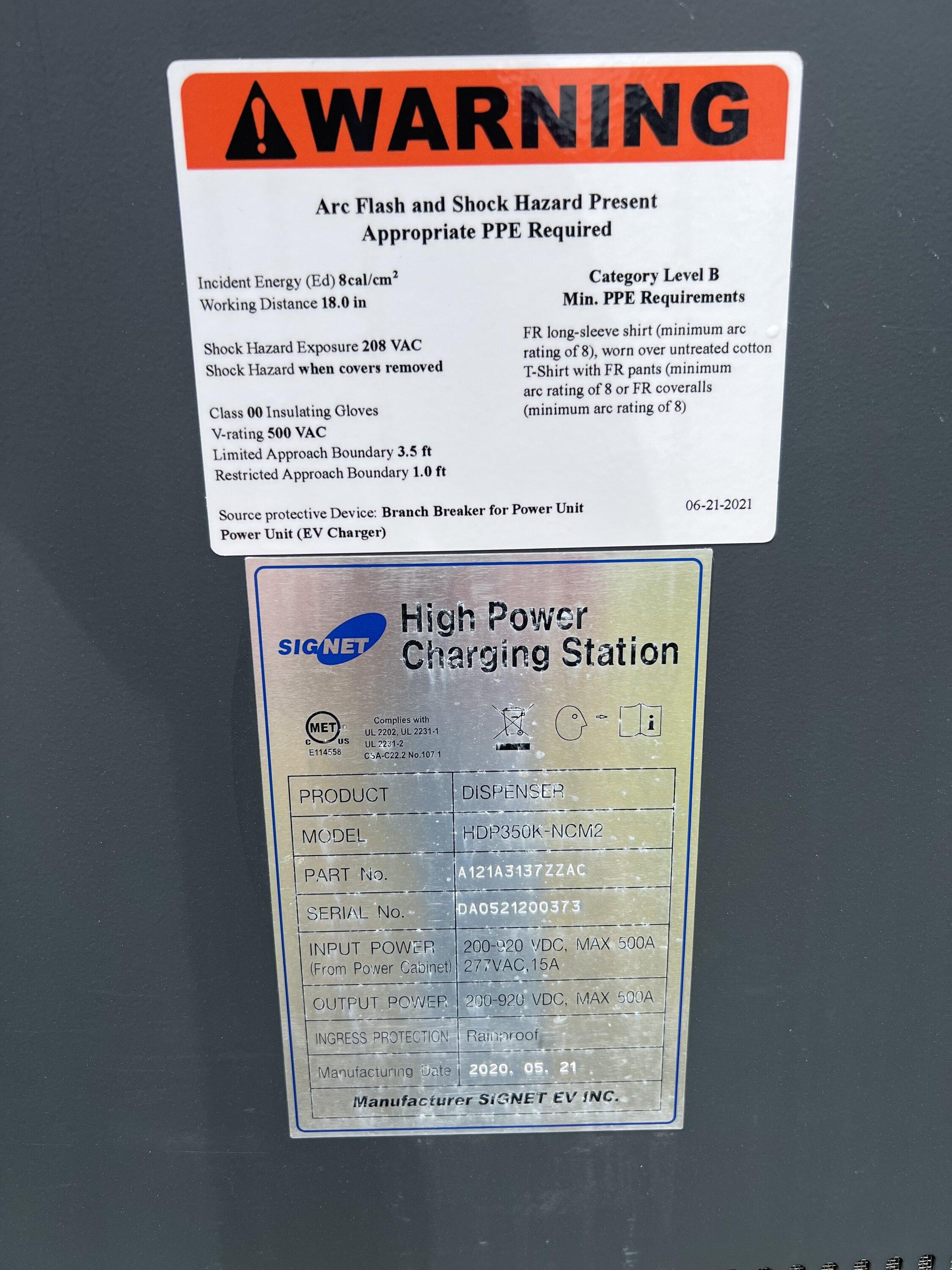

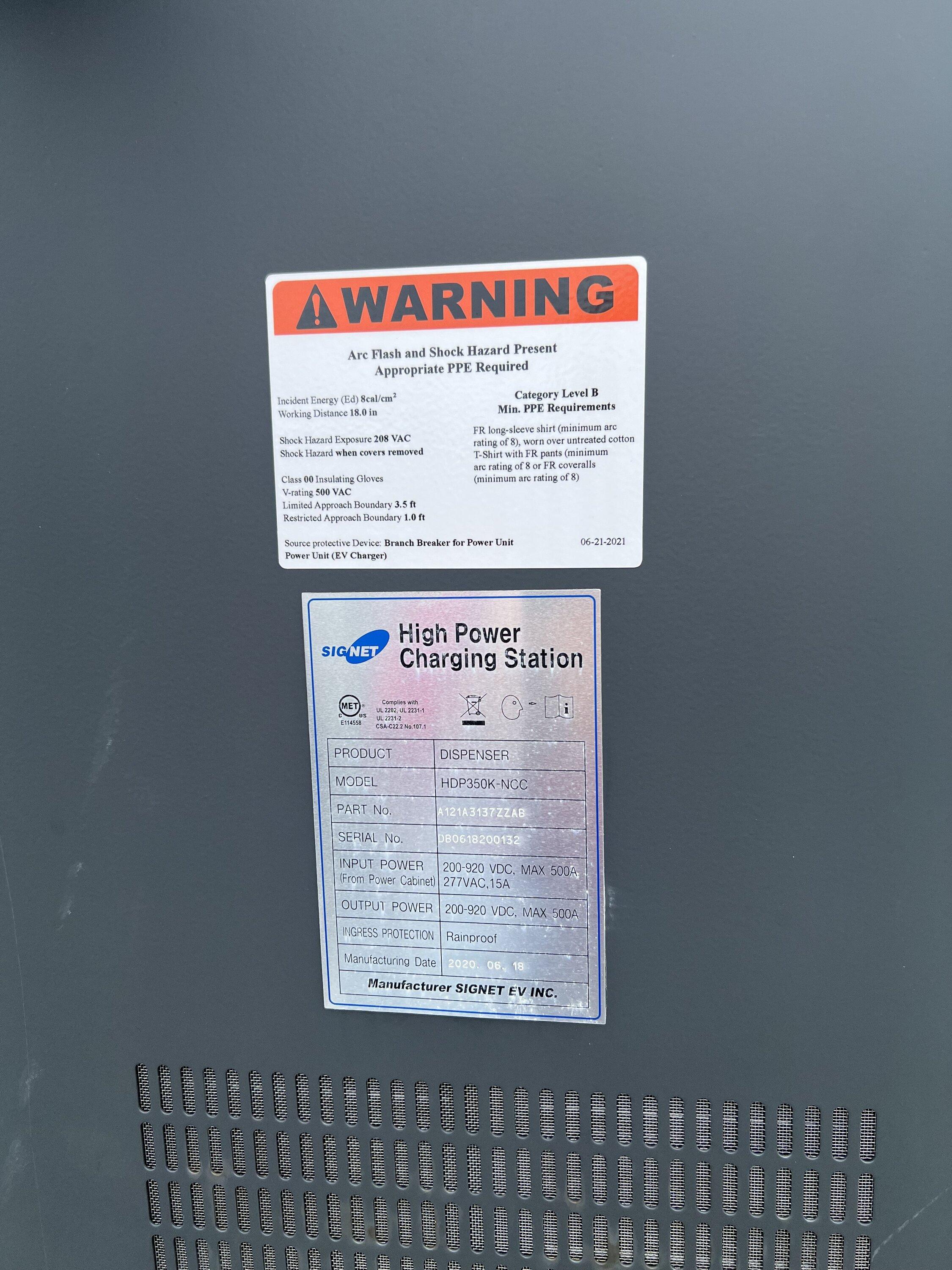

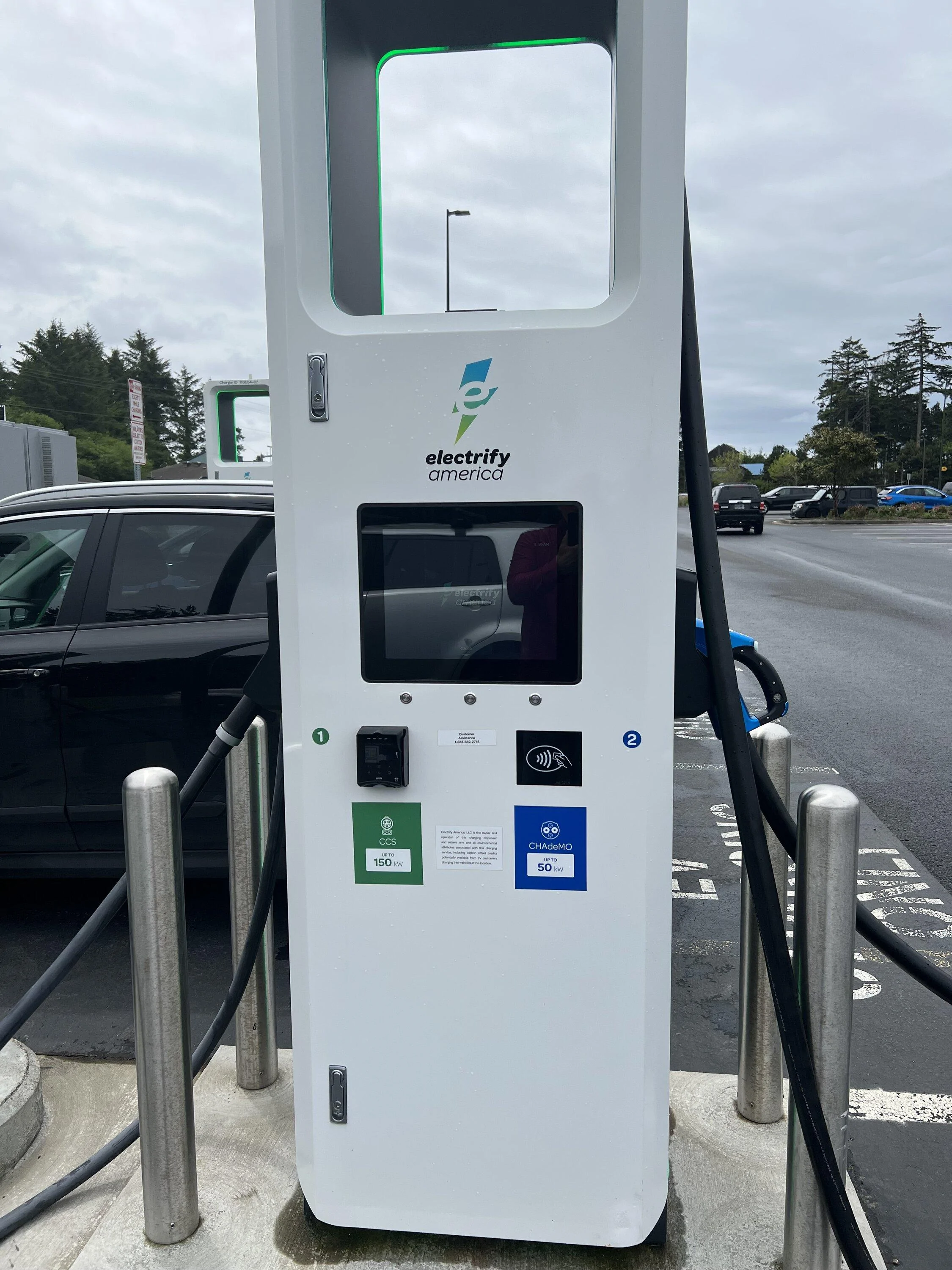

OK, so here is what a Signet looks like. These 4 units are installed at the Walmart in Newport OR. Being a novice I was surprised to see that the charging units were not set in a straight line, but instead were set in pairs of two for each parking space. It makes sense, but throws you for a moment. Here they are.
Walmart Newport has 4 chargers. #1 has CCS 150kw/CHAdeMO 50kW, #2 has CCS 350kW/CSS 350kW, #3 has CCS 350kW/CSS 350kW, and #4 has CCS 150kW/CCS 150kW. And of course some idiot had a non-EV parked at one of the chargers.
Rivian R1T R1S It's true what they say about EA IMG_0251
Rivian R1T R1S It's true what they say about EA IMG_0252
Rivian R1T R1S It's true what they say about EA IMG_0254
Rivian R1T R1S It's true what they say about EA IMG_0253
I found it interesting that all four chargers had the same exact rating plate. That would suggest that they make one primary unit that can be configured in three or more different configurations. This may be obvious to the more seasoned members of our community, but it was news to me.
I will post similar set of pics once I get over to the Walmart in Salem, OR. Now that I have seen them up close and personal, the data presented on the EA app makes a lot more sense to me now.
The first line on the nameplate says that this product is a "dispenser". It is connected to a cabinet that contains the actual charger. What it does dispense depends on the rectifier (charger) it is connected to but It is capable of dispensing anything within the CHarIn HPC-350 envelope (which covers CHAdeMO).
