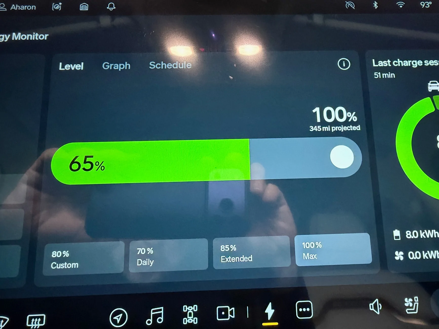

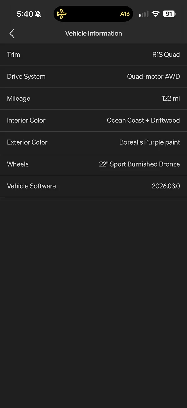

2026 R1S Quad, with the 22" inch sport bronze wheels. Rivian's site claims 374 miles. I thought the range was low (dealer charged it to 95% and the range was only showing 305 miles or so). I noticed the incorrect wheels were displayed in the user interface (the super sport tires), and the dealer fixed it before i left and the range popped up to 325 miles. Several days later, when I move the slider to 100% charge, the vehicle only states 345 miles (in all purpose mode). Is that normal? Should it be closer to 374 miles? It's not that big of a deal, I just want to make sure there isnt a software configuration issue somewhere. Truck only has 122 miles on it. See attached screenshots

The highest readout will be in conserve mode.
Do the new quads have a dedicated conserve mode? If it does switch to it and see what it has for range.
You should be able to see range for current and max for conserve/all purpose/sport from the energy screen.
My G1 quad will add around 25 or so miles going to conserve.

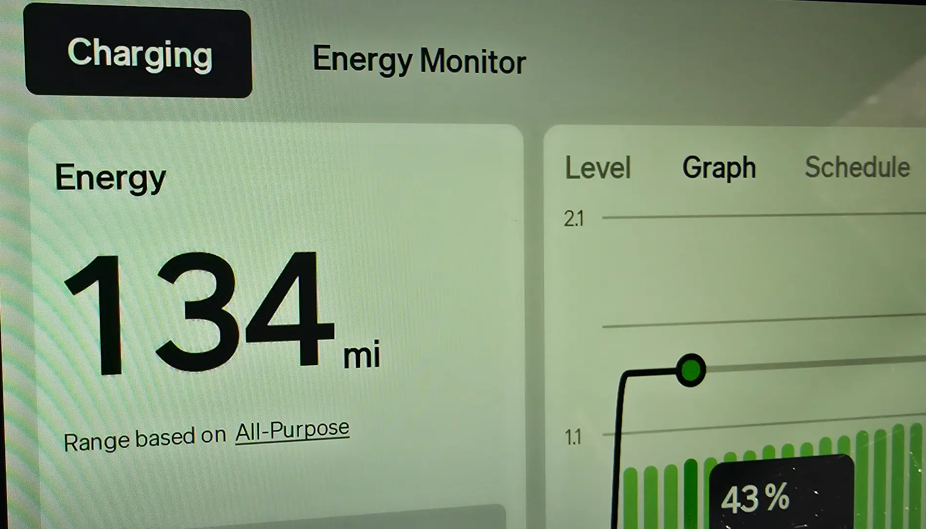

I'd like someone to chime in if they have more details on the detailed differences that go into the EPA figures, but my understanding is that in the EPA figure Rivian chooses a blend of speeds and settings to help that number, are in line with EPA's exacting rules, and that EPA number (374mi) will not show up on the screen. The screen figure is more of a range based on how it's currently configured. Windspeed, elevation gain, and extreme temps are your biggest est. range killers that can eat into these more ideal condition range estimates.

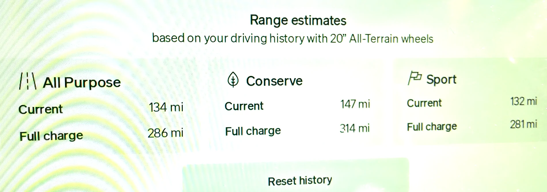

I can't tell whether you are seeking confirmation that you received what you expected in range, or if you just want to know which number you can trust for actual trip planning. The below pics and steps might vary for your Gen2, but here's how I get to a buried estimate of my Gen1 quad based on my actual driving history, including my aggressiveness and my aging 2022 quad's actual efficiency (2.3mi/kW on average). On the energy screen and charging tab, click the underlined "All-Purposed" link, then you will see your custom range estimate figures. Of course, you'll need to drive your brand new quad more for this screen to be accurate, but it's a nice feature attempting to make range estimates as accurate as possible, and even includes a reset feature in case something major changes
