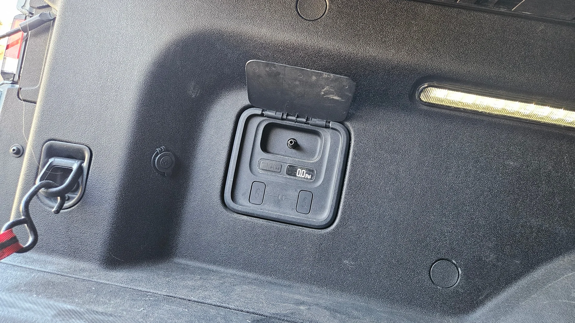

Basically, there's a female plug on the truck harness that is (from the factory) going into a male plug on the utility panel unit. That plug has +12V, -12V, and a signal wire for the gear guard lock which is also integrated to the unit. What we're doing is unplugging the truck harness and then plugging in a new middle-man harness that passes the gear guard locking signal straight through but splits the 12V into two leads - one that goes to a new female plug for the utility panel connector and a second lead that goes to the 12V outlet we're installing. The 12V outlet I bought from Amazon came with an in-line fuse so I left it in when I shortened the cable.
But yes it all just clicks together and is easily removable, no splicing needed on the truck side so you can take it back out again and leave no trace if you want.

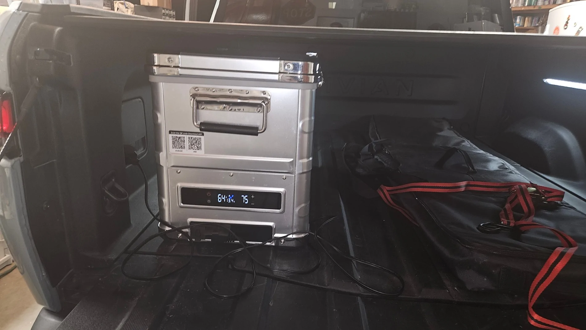

My use case is this: we do lots of car camping at state parks and such. We are usually parked 20 ft or so from our camp site. My current plan is to plug my dc/ac fridge cooler in in the truck Bed for 3 days at a time and not really run anything else. At night close the tonneau cover so critters don’t get in
The current “solution” is to leave outlets on which seems to drain 6-7% from the battery per day but will “work”.
if I do this mod like you’re describing, I’m under the impression that A) it’s fine and safe to leave the truck “stay on” mode for days at a time with the screen and hvac off B) power consumption probably drops to 2% or so per day?

Correct on all counts. That's exactly what I do as well, put my fridge in the back under the tonneau connected to this port, strap it to the side so it doesn't slide around, and leave it there for the duration of the trip. The "stay on" setting means the HV contactors stay closed and the 12V bus is mostly powered by the DC-DC converters which are rated for 1800W each, so I can't imagine that a small fridge within the normal 12V outlet spec is taxing them very much at all. And the truck staying awake means all of its BMS and thermal management is active anyway so it can take care of itself as needed. I don't have exact numbers but it is a significant reduction in drain to leave the inverter off. The bigger thing for me was not having the cabin baking at 90 degrees or leaving the HVAC running constantly to counteract the heat coming off the inverter.
Note that without the "stay on" setting the 12V outlets will all turn off when the truck sleeps, which is just a few minutes after you close the doors.

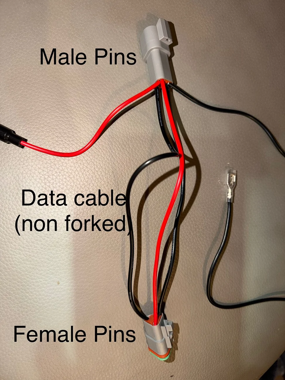

The harness coming from the truck to the utility panel has a +12V (red wire with blue stripe on mine), -12V (black wire), and a white control wire for the gear guard lock. The side coming from the truck is the male DT plug that has the female pins in it.
To make the harness, start by making three male pins. One should have a short red wire (couple inches) and the longer red wire from the 12V socket that has the fuse in line. Strip the ends and twist both together, then crimp them in a single male pin. Do the same with the black wires - one short passthrough wire the exact same length as the red one, plus the longer black wire that will go to the 12V socket. Twist those together and crimp into a single male pin. Finally make a third pass through wire for the data pin the same length as the other short ones and crimp one end into a male pin. Insert the three male pins and their wires through the rubber waterproofing boot and into the female receptacle until they click satisfyingly into place. Clip a wedge lock on top to hold the pins in place.
Next, strip and crimp the ends of the short pass through wires into female pins and insert them into a male DT plug taking care to line them up in the same position as the original connector. Insert a wedge lock to hold those in place as well.
Bonus: Hold the harness up to the truck and measure the length you need to get to the 12V socket, then trim the longer 12V wires to the appropriate length, strip the ends, and crimp on new female spade connectors so there's no extra wire to deal with.

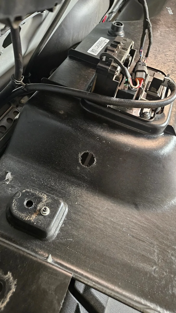

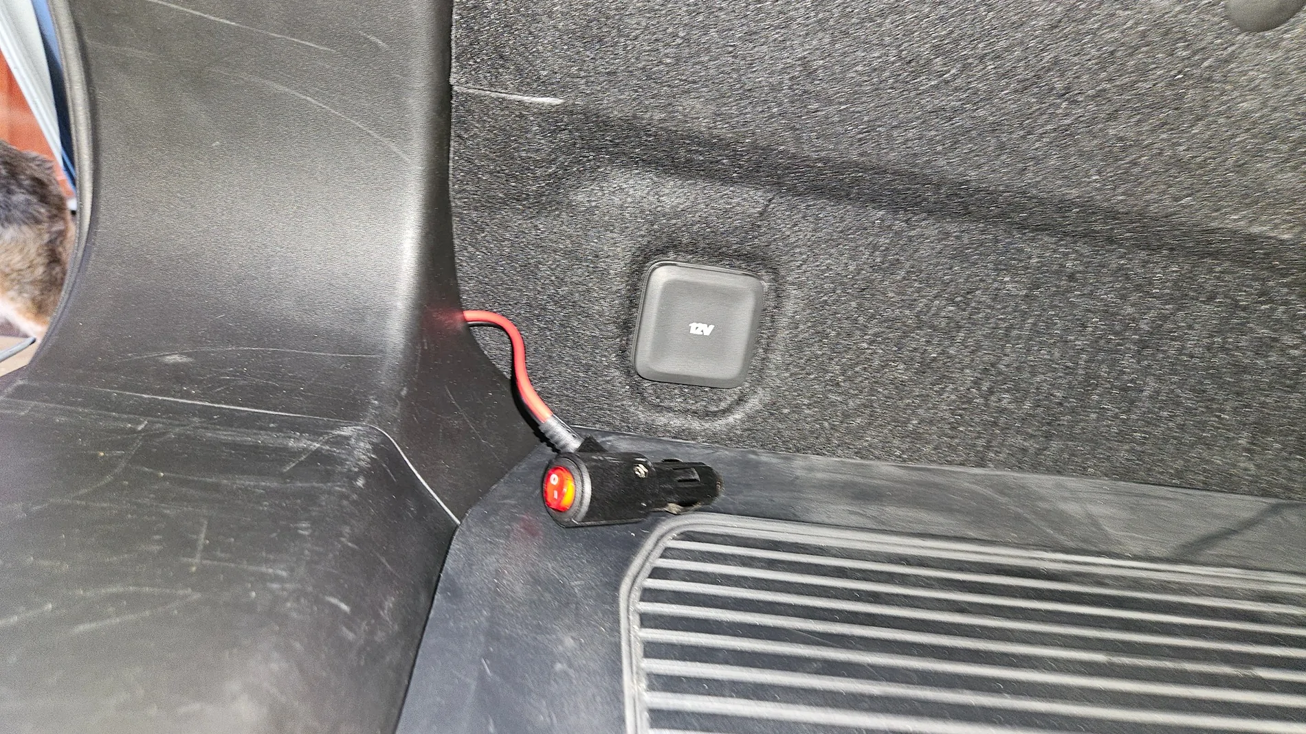

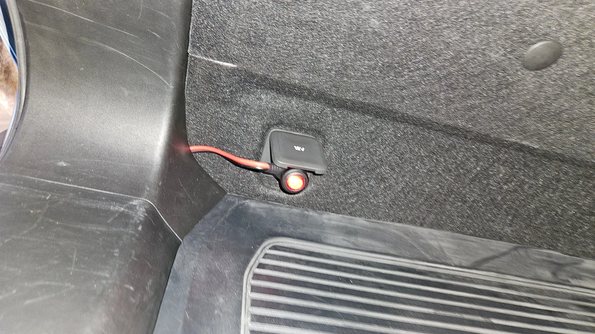

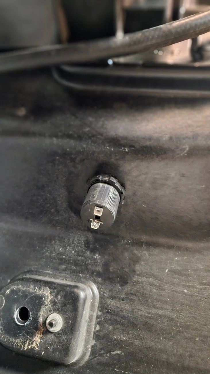

To cut the hole I just measured the socket, eyeballed where to put the hole (based on OP's pictures) and drilled through the bed liner side wall with a 1" hole saw. My 12V socket was almost exactly 1" in diameter at the threads but measure yours before you cut anything just to be sure. I used a generic hole saw bit but I think any drill bit would work, it went through the material like butter. You may want to wear a mask and work gloves because the bed liner material is either carbon fiber or some kind of fiberglass and the dust from drilling definitely looked like something you would not want to get in your lungs. Or just don't put your face too close.
Power-wise, I did not personally disconnect the 12V before unplugging and re-plugging the utility panel, I just left the doors closed and the truck asleep. I don't think there's any risk of shorting because you're just connecting and disconnecting harness plugs that keep the pins safely apart, and there were no sparks or error codes or theatrics when I did it. If you want to be triple extra safe there is a somewhat complicated process to completely shut the truck down to make sure 12V has no power detailed in this other post on the forum:

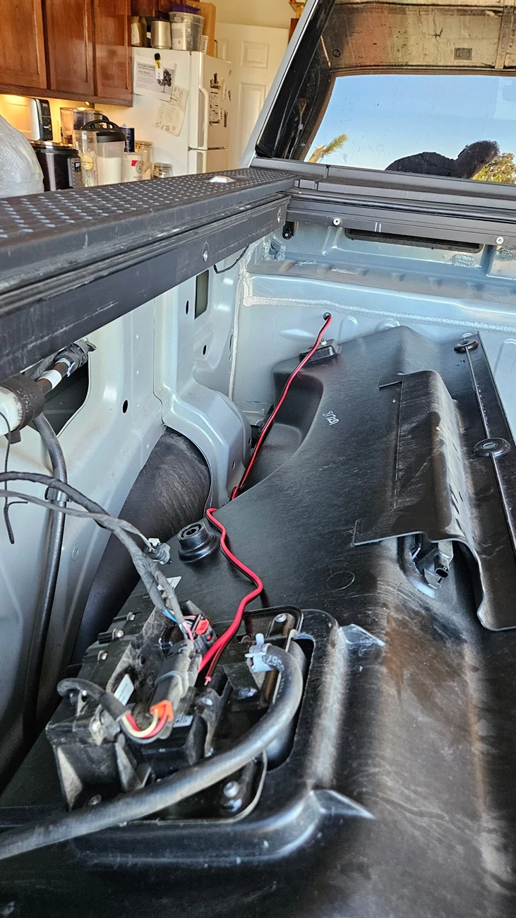

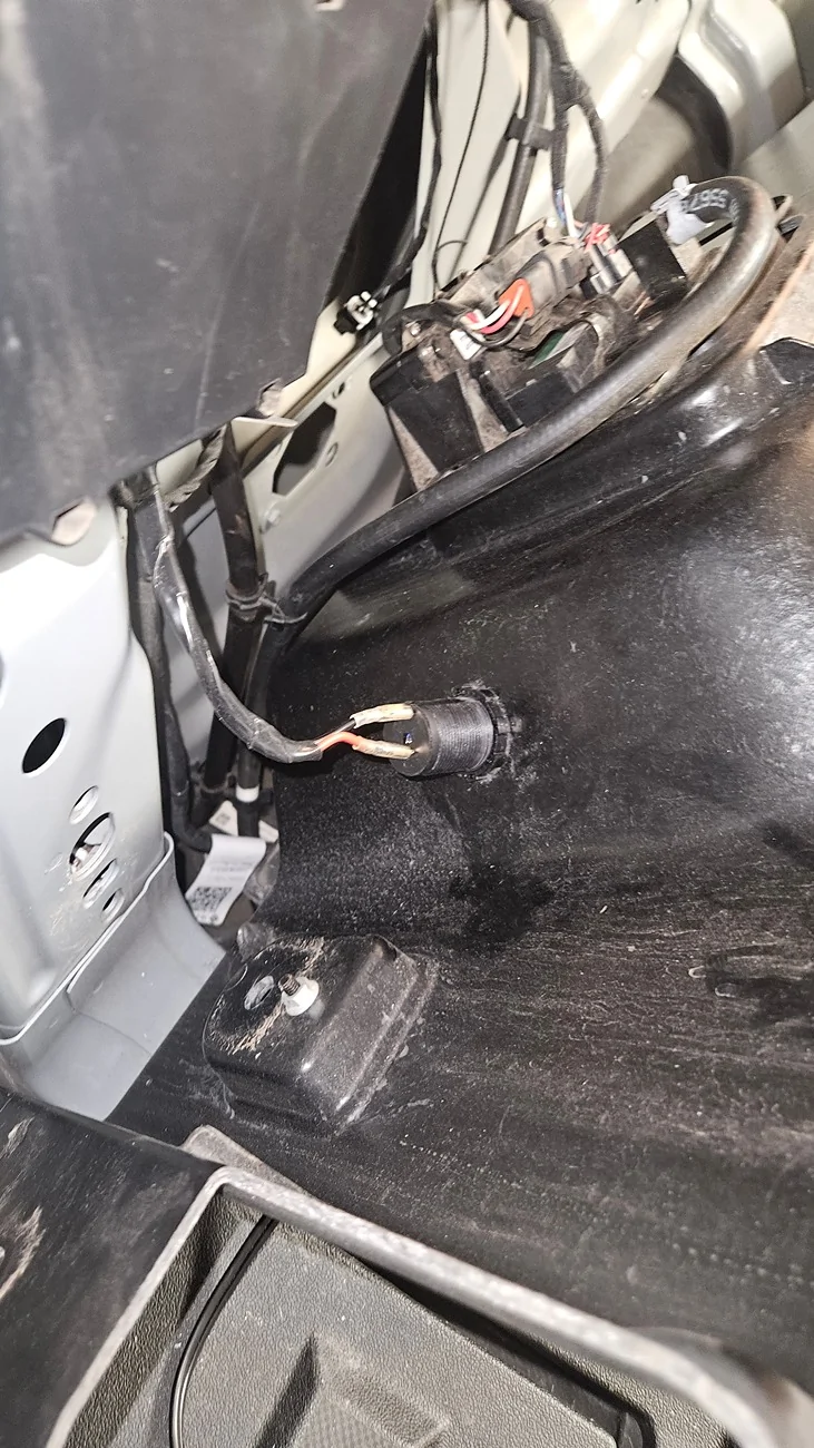

Ok thank you for the write up. I think my harness is ready for install.
I believe I have it wired up and hope this helps others. Also Srkz - did I get the red and black lines correct?
Rivian R1T R1S Added 12v outlet to R1T bed. IMG_3922

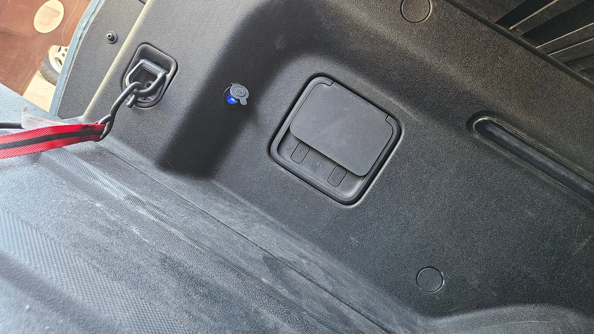

Just a quick update - the harness I made with Srkz guidance worked perfectly. For the hole I used a 1” drill saw but I think 1 1/8 or maybe even 1 1/4 would have been better - I had to kind of work the 1” saw a bit.
Currently testing 24 hours of dc cooling with stay on and hvac / screens off
thanks Srkz! Couldn’t have done it without you!
