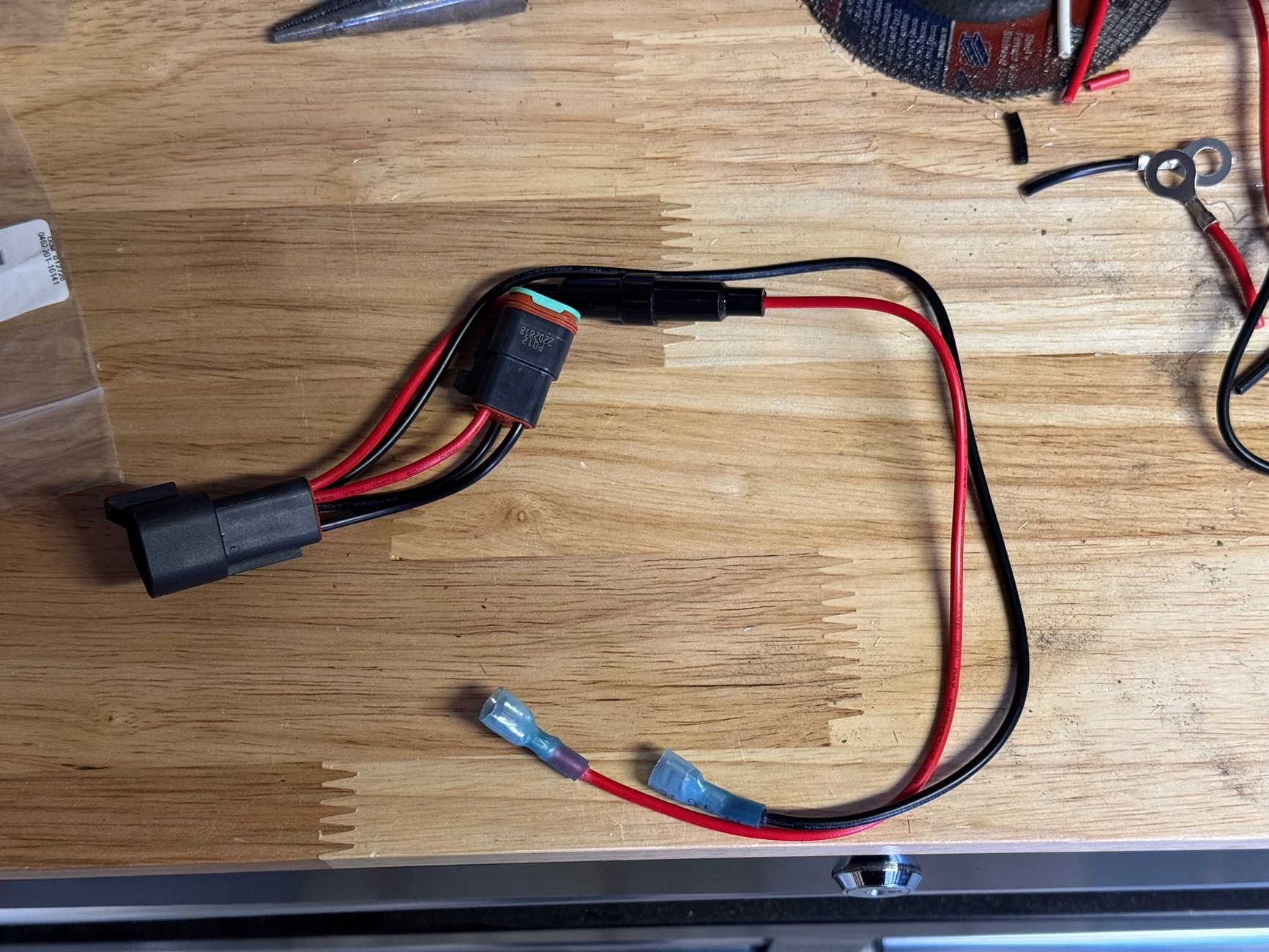

So I just completed this mod on my truck. I put the outlet in the same spot as OP but rather than fishing the cable all the way up to the gear tunnel I made a little add-on harness to tap the 12V from the air compressor that’s right there without cutting or splicing anything. Completely removable and easily replaceable if the outlet ever burns out or gets loose or anything.
I didn’t take many pictures because mine looks just like OPs except for the harness. I can list the parts I used if anyone wants - total cost was only about $25 for everything assuming you have tools already.

Okay so you basically just need a Deutsch DT 3-pin plug and receptacle, plus the pins and wedge locks. I was going to make a list of all the part numbers but essentially you just need these three things off of Amazon:
Deutsch connectors and pins:
https://www.amazon.com/dp/B0DJSL8YHH
12V socket with inline 10A fuse and wire:
https://www.amazon.com/dp/B07H1MGWFN
Crimp tool if you don't have one already:
https://www.amazon.com/dp/B0D1FR76Q7
The harness coming from the truck to the utility panel has a +12V (red wire with blue stripe on mine), -12V (black wire), and a white control wire for the gear guard lock. The side coming from the truck is the male DT plug that has the female pins in it.
To make the harness, start by making three male pins. One should have a short red wire (couple inches) and the longer red wire from the 12V socket that has the fuse in line. Strip the ends and twist both together, then crimp them in a single male pin. Do the same with the black wires - one short passthrough wire the exact same length as the red one, plus the longer black wire that will go to the 12V socket. Twist those together and crimp into a single male pin. Finally make a third pass through wire for the data pin the same length as the other short ones and crimp one end into a male pin. Insert the three male pins and their wires through the rubber waterproofing boot and into the female receptacle until they click satisfyingly into place. Clip a wedge lock on top to hold the pins in place.
Next, strip and crimp the ends of the short pass through wires into female pins and insert them into a male DT plug taking care to line them up in the same position as the original connector. Insert a wedge lock to hold those in place as well.
Bonus: Hold the harness up to the truck and measure the length you need to get to the 12V socket, then trim the longer 12V wires to the appropriate length, strip the ends, and crimp on new female spade connectors so there's no extra wire to deal with.
Plug it all back in and re-assemble everything and you're good to go.
