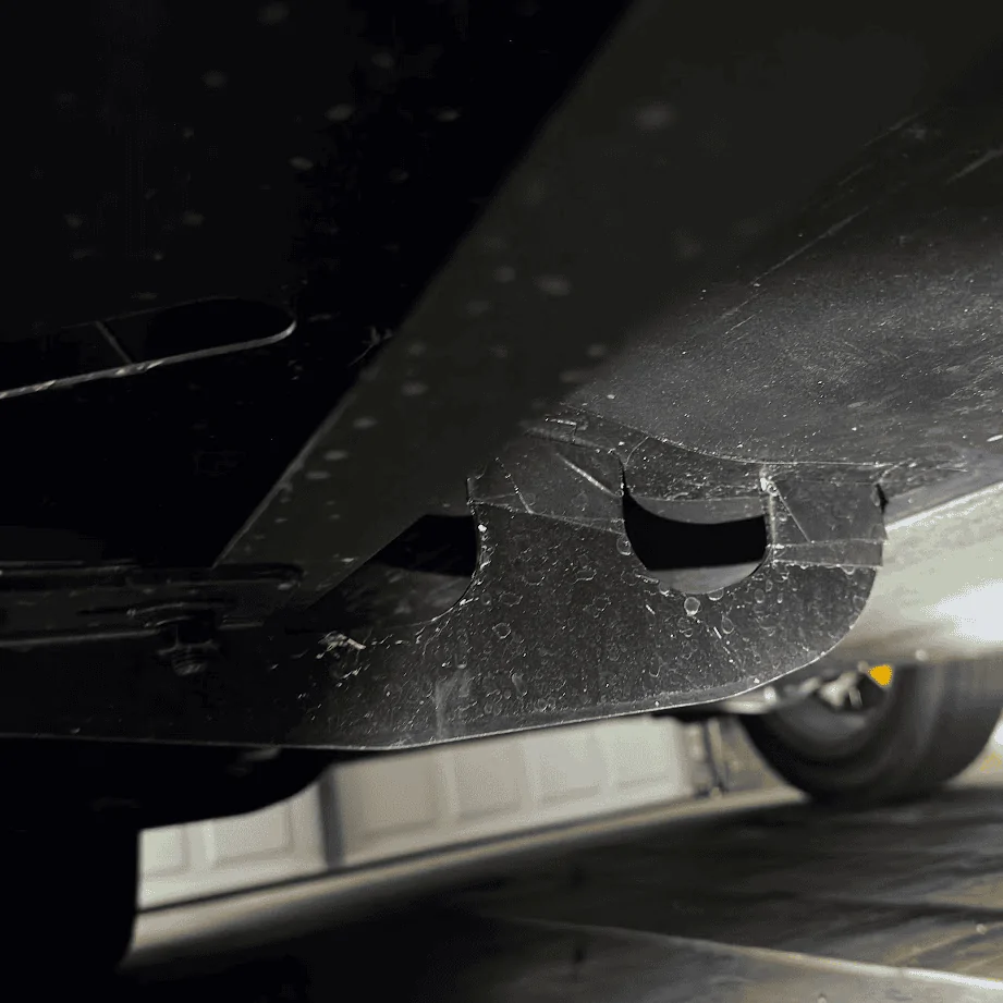

I used a Dremel to cut a slit in them and wiggled in the bracket for the step. I then covered the slit with Gorilla tape. The tape has held fine since September 2023.

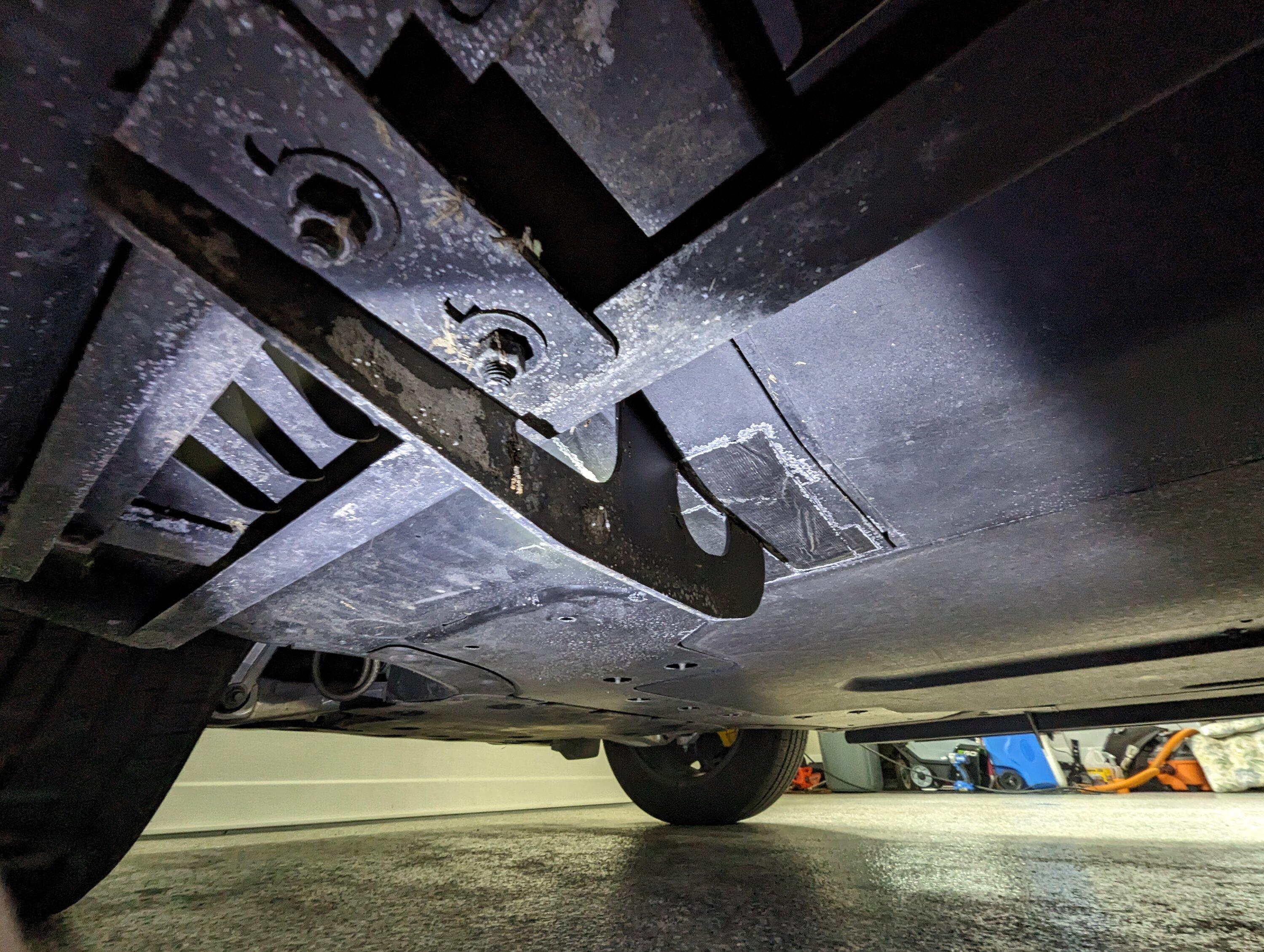

I used aluminum/tin snips:
https://amzn.to/3TjHkNv
Not the prettiest but you can't see the slits unless your under the truck.
Liquid can still get in even before the running boards. The main reason I reinstalled them is to protect against road debris damaging the e coating on the underside.

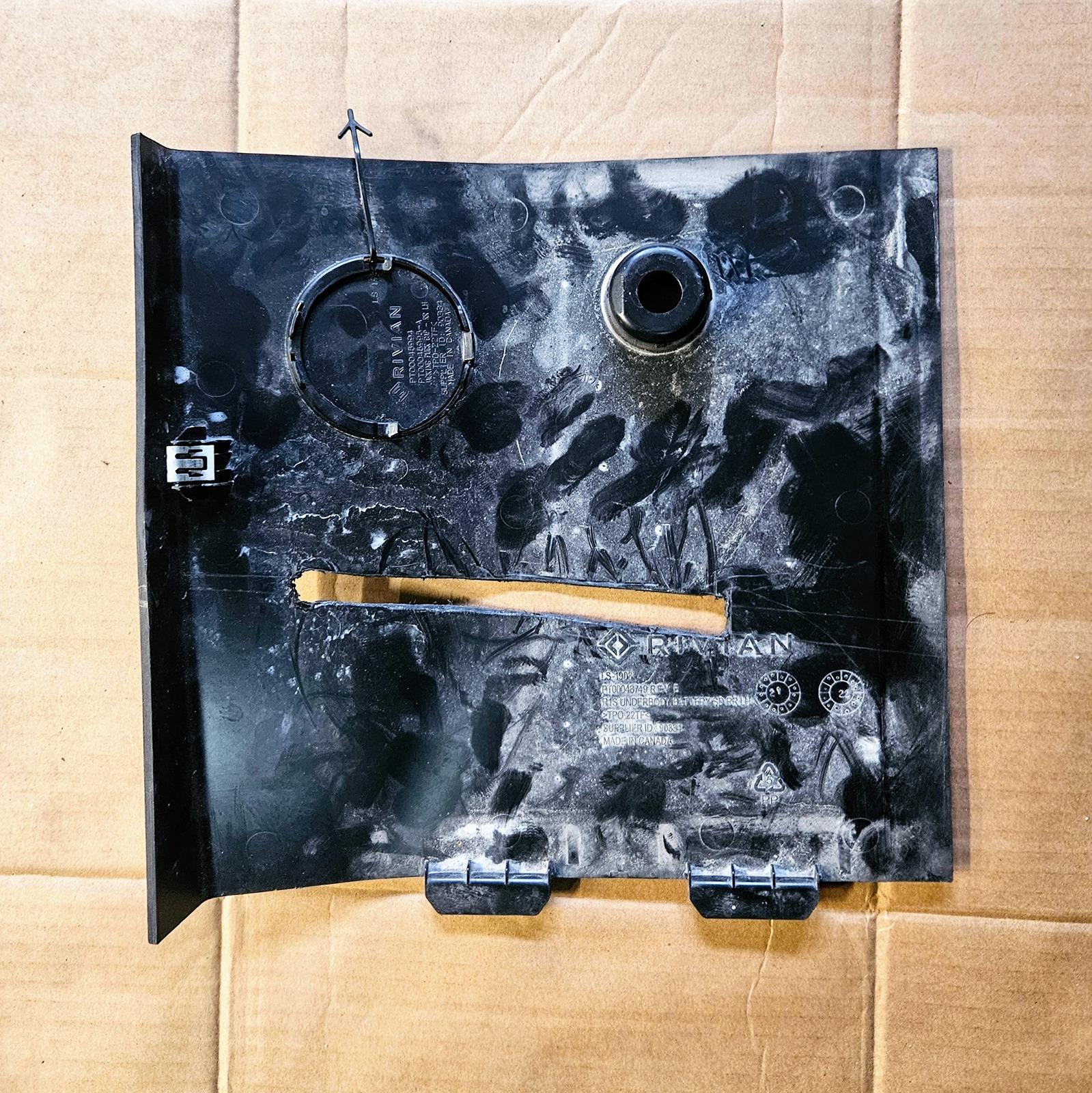

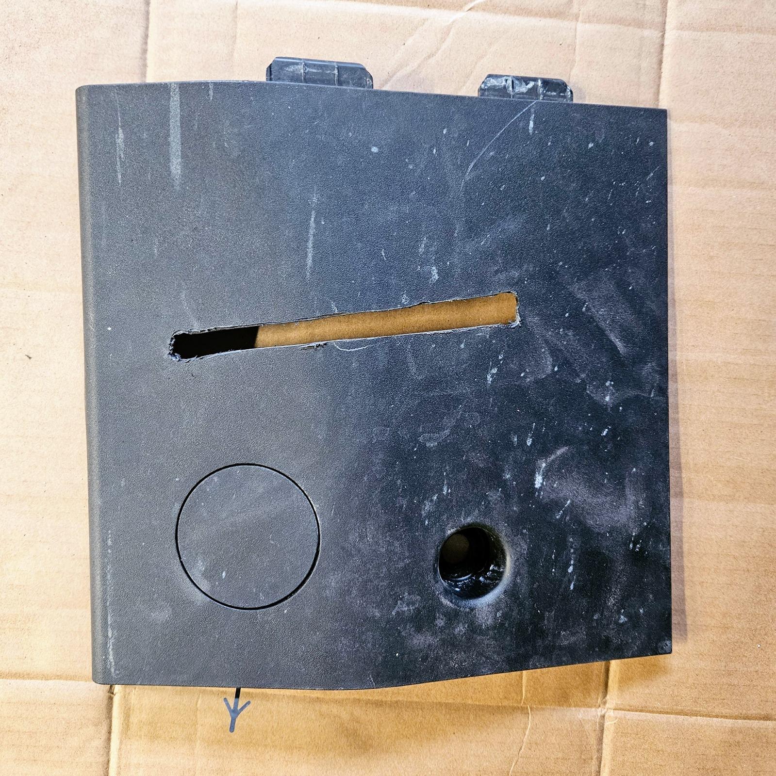

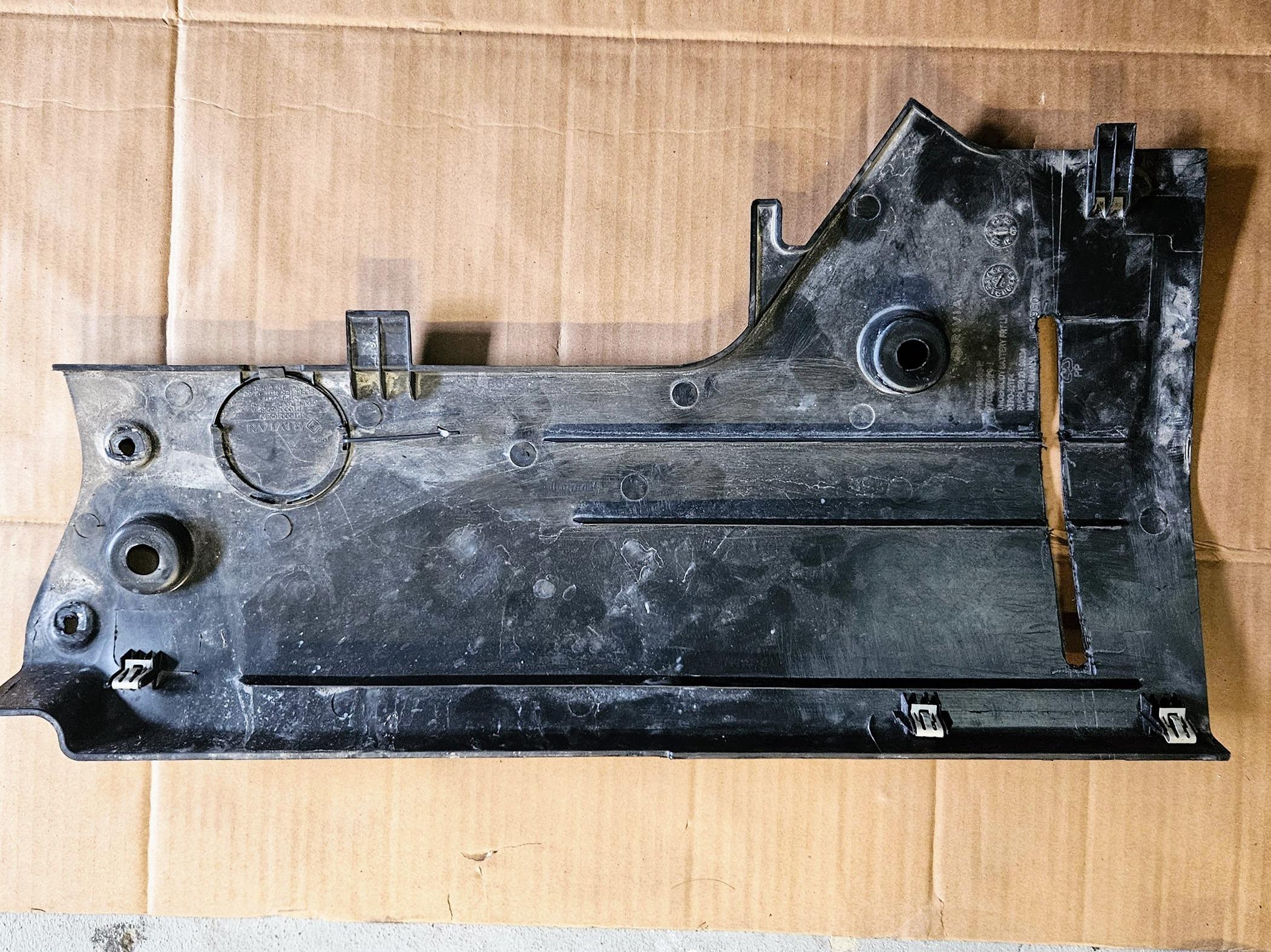

Here are rather poor pics of what mine looks like. Some have cut slots from the door in... The way I cut them is less visible but requires the runners to be off when you reinstall the panels.
Rivian R1T R1S Just installed EVBase Running Boards.  Tips on trimming the plastic panels? 1000003953
Rivian R1T R1S Just installed EVBase Running Boards.  Tips on trimming the plastic panels? 1000003955
Rivian R1T R1S Just installed EVBase Running Boards.  Tips on trimming the plastic panels? 1000003954

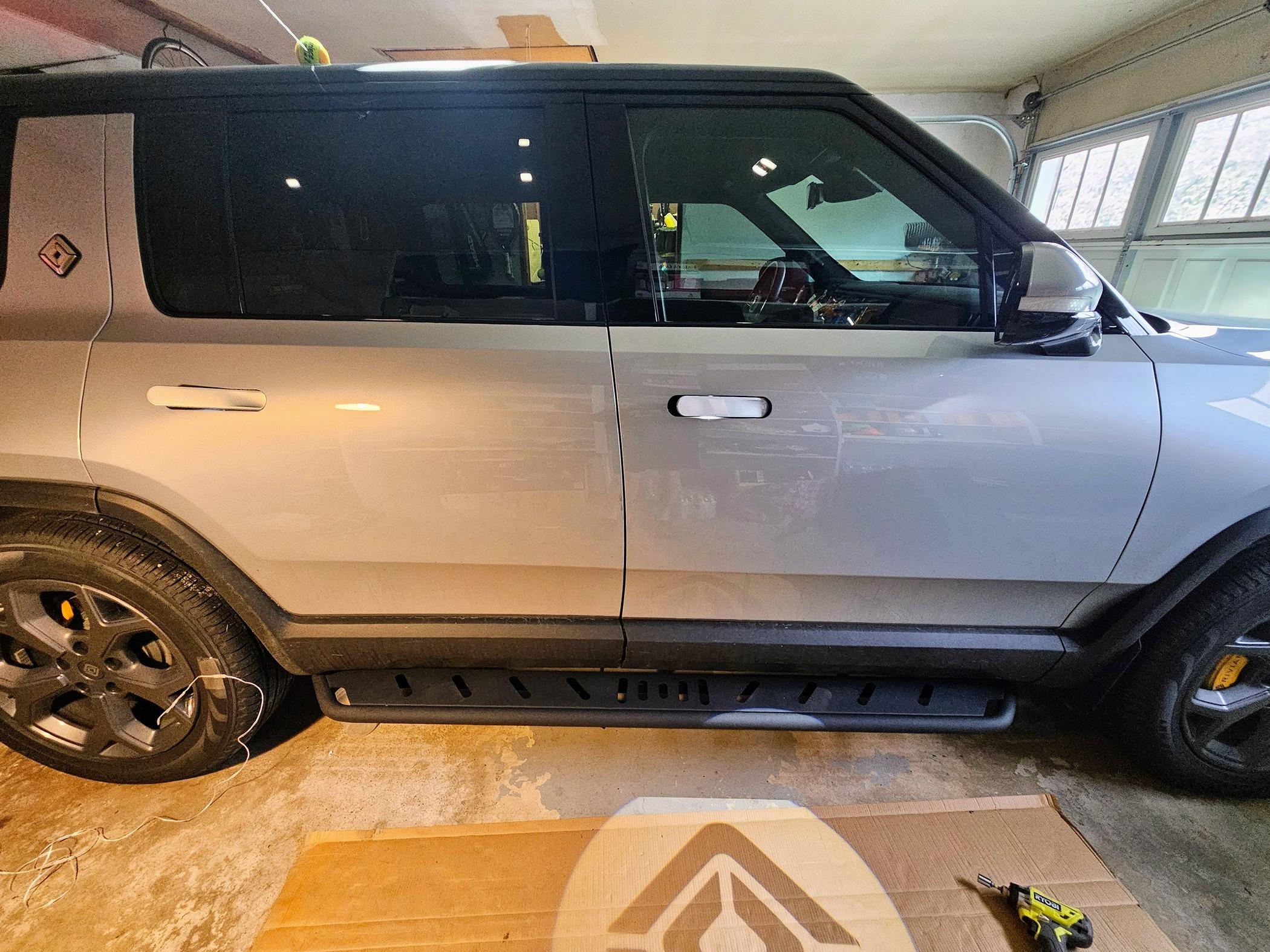

Thanks for the tips. Yes the tools are junk. So was the labeling of driver side/passenger side on the brackets. Boards are on.

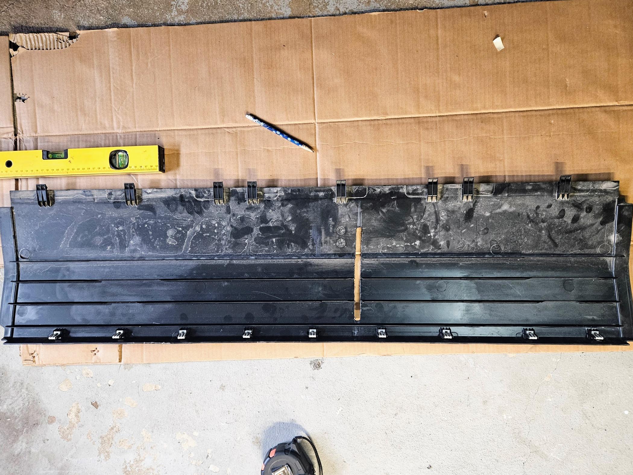

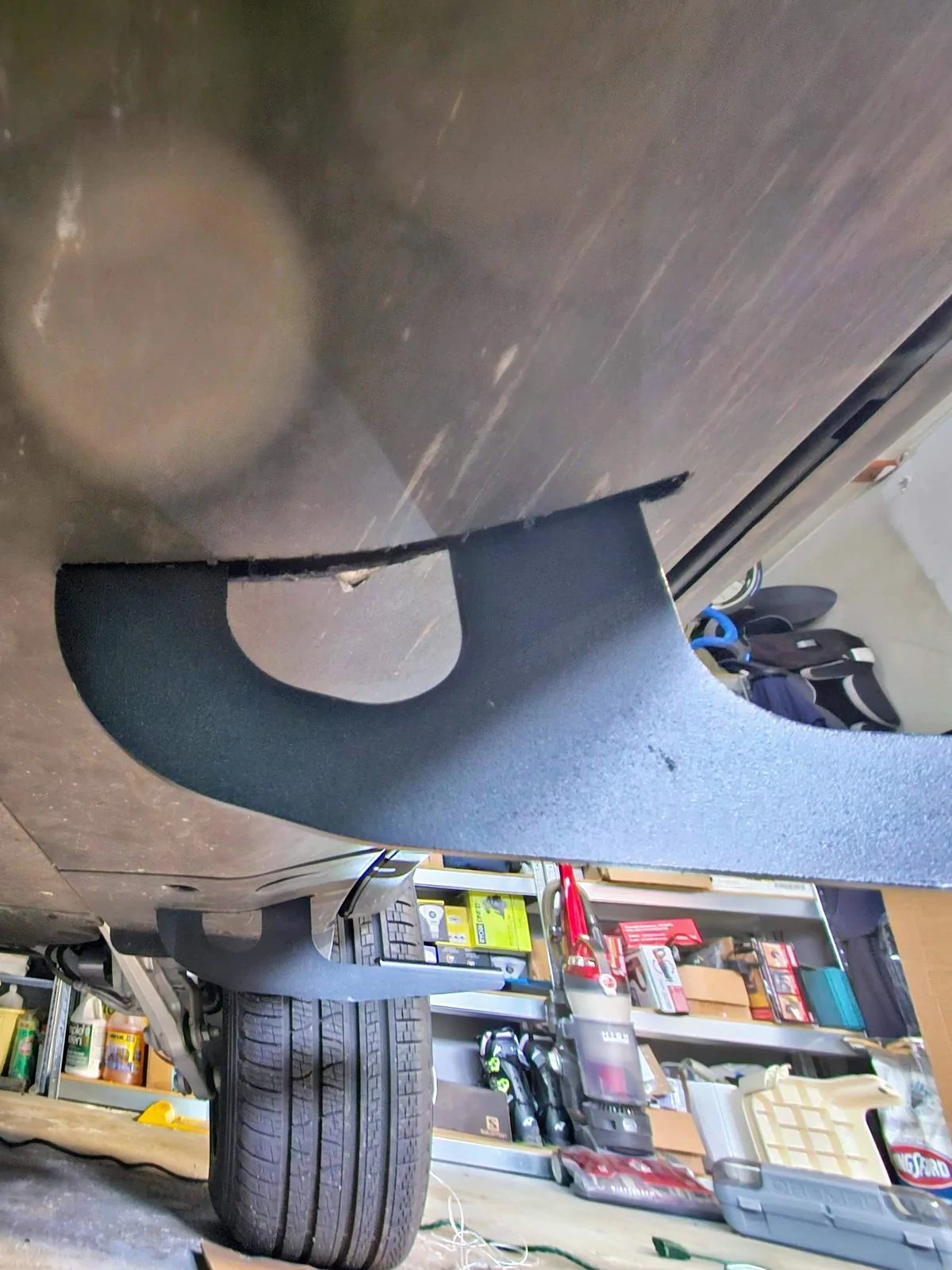

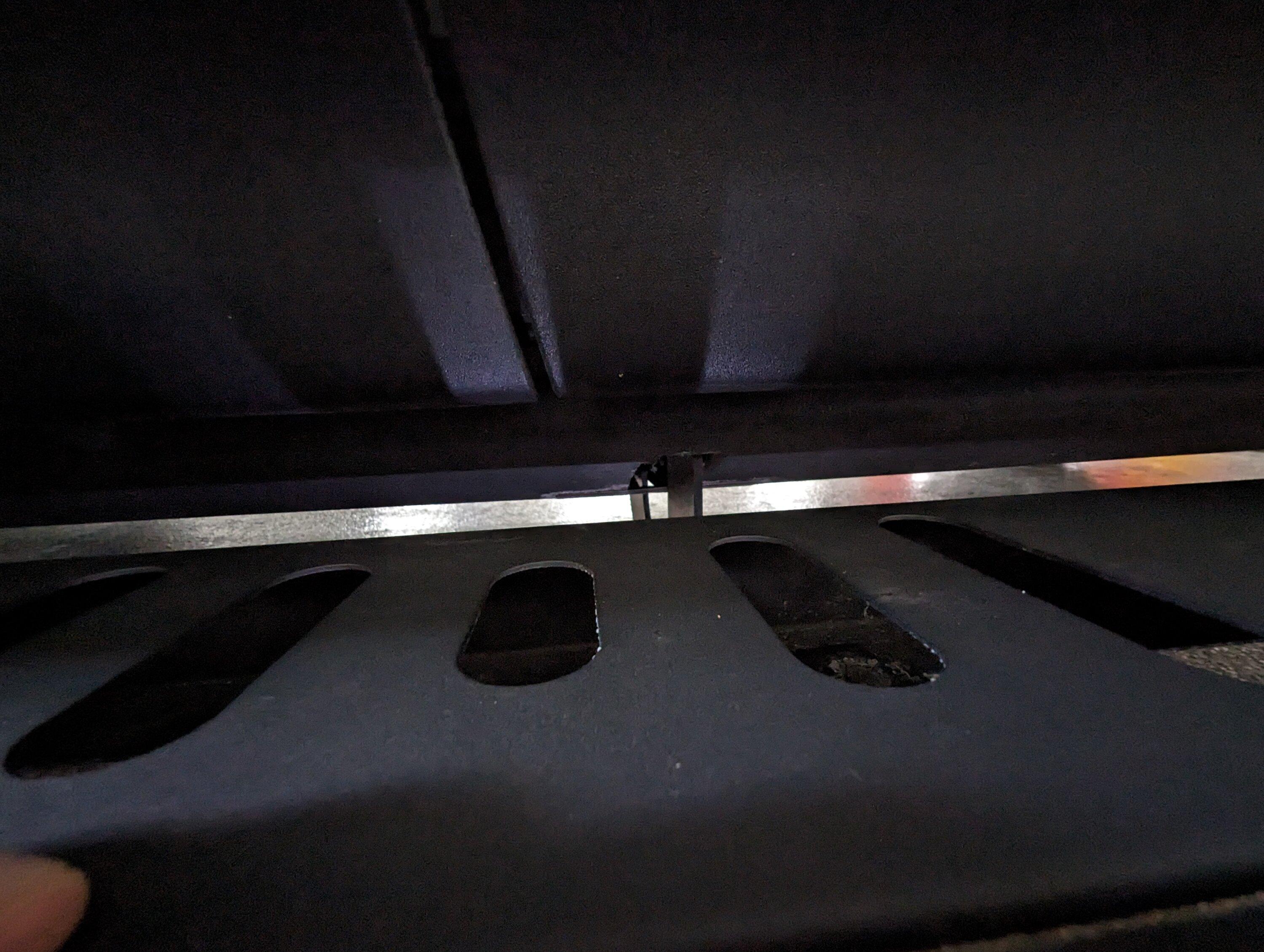

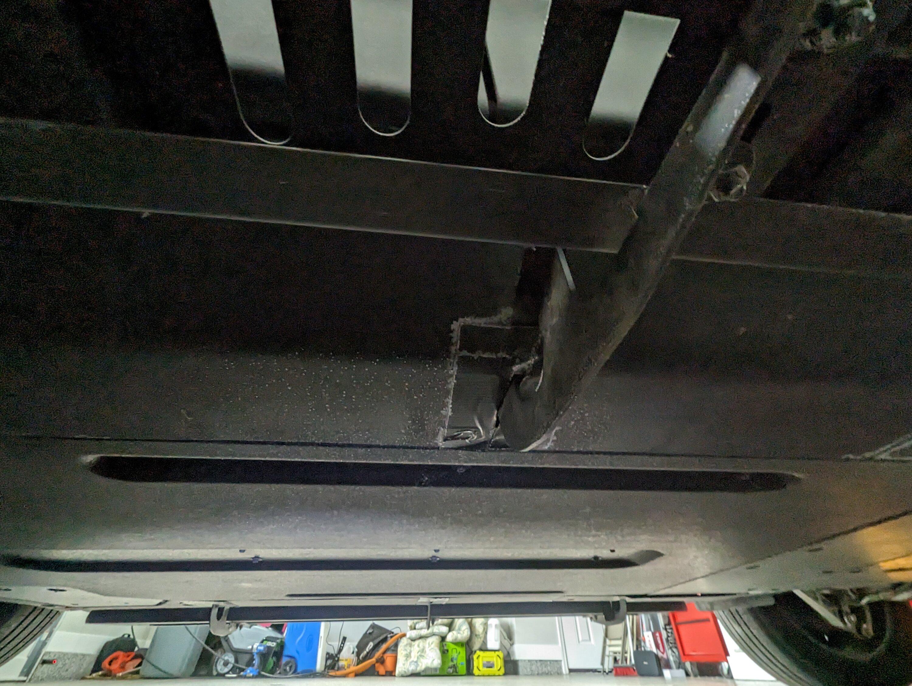

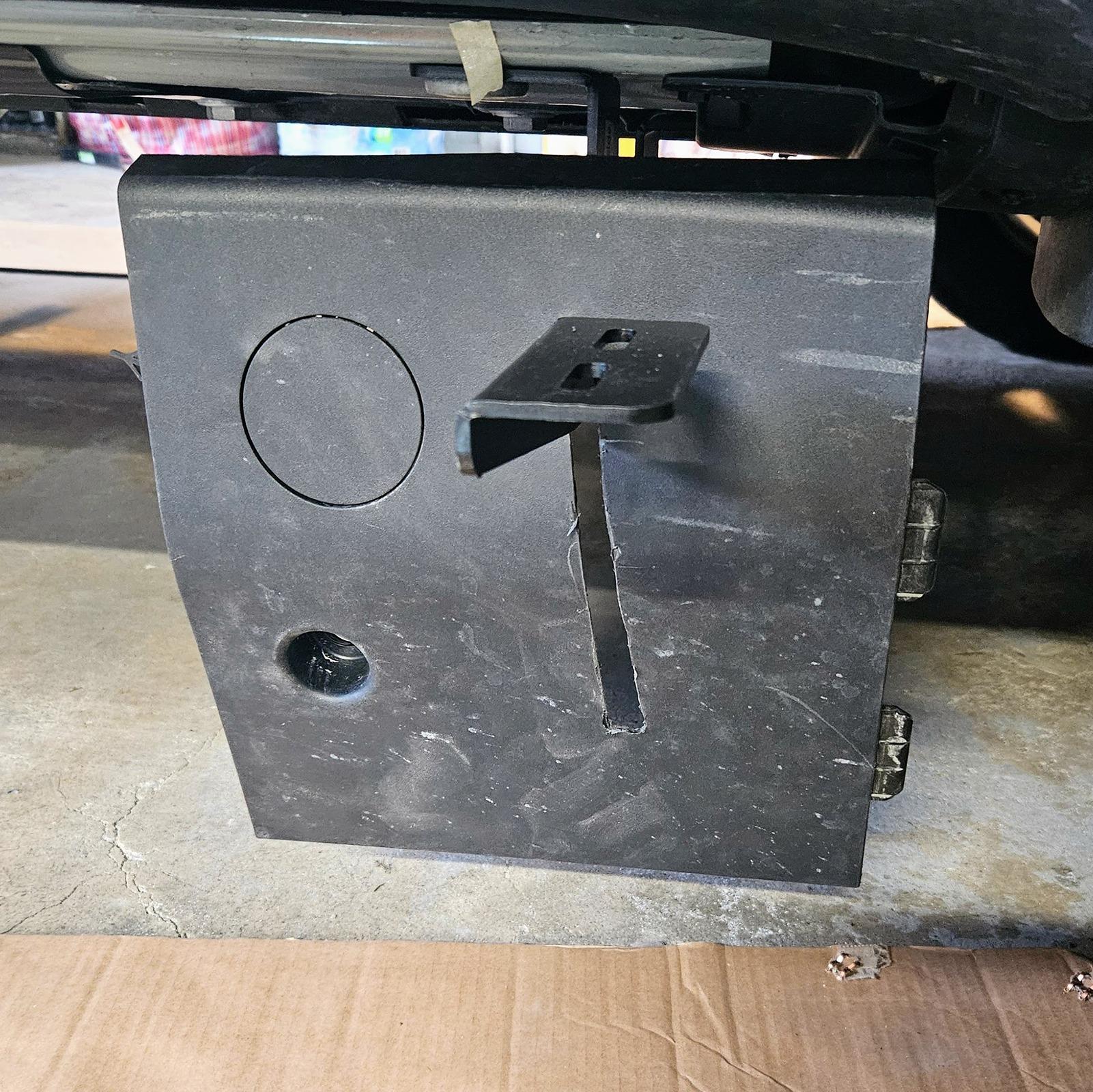

Just finished installing the EVBASE running boards. And I'm quite satisfy with the quality and outcome.
For a smoother installation, I was using the "TP55" bit and impact wrench. Despite using the impact wrench, 1 of the 6 bolts required extra effort to turn.
Additionally, I took the time cutting slots on the plastic covers and wiggling them back. (A standard template may not work, since each vehicle mounting brackets are angled slightly different.)
Also, I spent the time adjusting the rear so it doesn't stick out. I particularly like this Evbase extend all the way to the back, for rear passengers to get in and out, compare to the brands.
For longevity, time will tell if this is going to rust.
